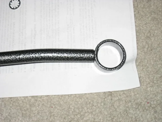

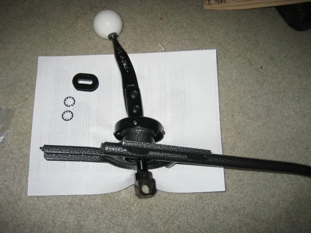

Alright so the Shifter finally got to my house.
Looks nice and spiffy though the ball is a simple white numbered unit instead of having the hurst writing on the side but that's ok.
The thing I mentioned in the previous post is that it appears that some parts are missing.
Look at the image and you'll see what i'm talking about. The front bushing is not there, and neither is the rear one. The bolts that go through the shifter to secure it to the shift-rod don't appear to have anything to secure themselves to other then the shift rod's thread itself. And last but not least there's no instructions whatsoever for the unit.
Those of you that bought Hurst shifters did something else come with the unit? am I missing something? did I get duped? :shrug:

it should have come with new red bushings for the front mount, and one for the rear mount, where the back mounts to the body. the plastic bushings from the shift lever itself are reused, IIRC. read the write up in my sig. its been about a year since i did this, and i dont remember all the small details. the write up should have everything you need to know though.
Thanks for the suggestions. What about the allen bolts that secure the hurst lever to the shift rod? do they have some kind of backing to them?
I saw that Steeda offers a shifter bushing kit for 20 bucks or so. Now i'm not sure of its for their Tri-Ax models or what but do you think those would be good for this shifter?
As usual thanks for the insight on this.
