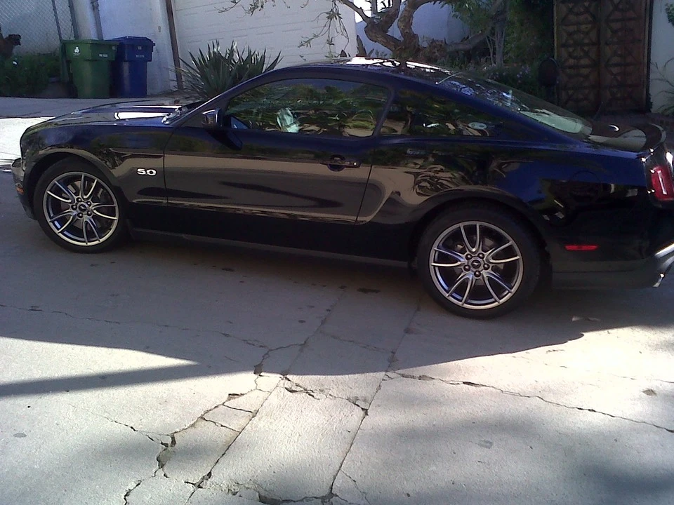

I've currently got a 2012 Mustang GT/Brembo (had a 2011 GT/Brembo, but long story).
Anyhow, I had the Eibach Pro-kit on the 2011. It lowered it decently,but I wasn't that impressed with how it drove. So I just ordered (and should be here thurs the M5300K kit from Ford. So I'll have pics and driving impressions (where I live, there is a lot of canyon driving, so the car gets pushed well). I've also got a replacement set of UMI lower control arms.
I will say this about the Eibach and any spring that lowers the cars center of gravity, it all but eliminates the dreaded "wheel hop" issue. I say by 95-98%. So rather than "hopping along", it lays rubber and as such far more controllable vs the "hop". So If looking for a cheap way to lower the car and get rid of the wheel hop in the 2011-2012 mustangs, springs will do it. Not the over all best solution, LCA's should be included, but good enough... especially for those not corner carving.

here's a picture of the 2011 I had with the Eibachs... not the best, but gives an idea.
