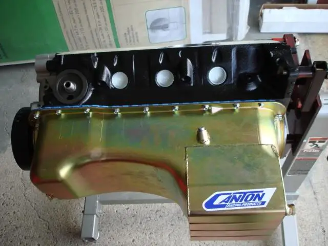

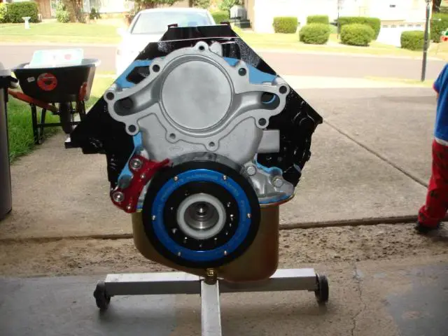

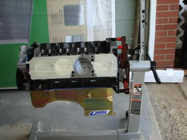

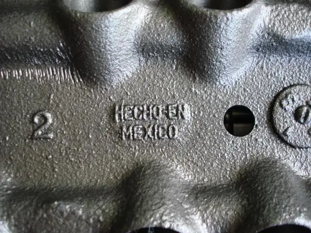

I picked my engine up from Wolfpack Speed the other day. I had Jim (Woody) from Fordstrokers send it to Mikes shop to save a little on the shipping charges. It's a Mexican block 347. It also has a custom ground Camshaft Innovations cam that Jay sent directly to Woody and he threw it in for me along with the Canton oil pan that Lou (Sonic03cobra) hooked me up with. Fordstrokers was great to deal with over the course of the whole transaction. Jim took care of me and i'm extremely pleased with his services. ********************** Hats off to Jim Woods @ Fordstrokers, Jay Allen @ Camshaft Innovations - Home , Lou @ Laurel Mountain Mustang , and last but not least Mike Koval @ Western PA's #1 Source For Late Model Ford Performance!!! . All parties took great car of me and I wouldn't hesitate to use any or all of them again.

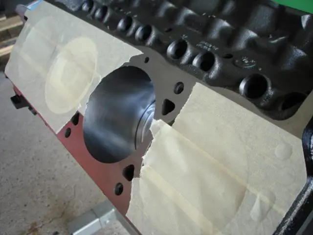

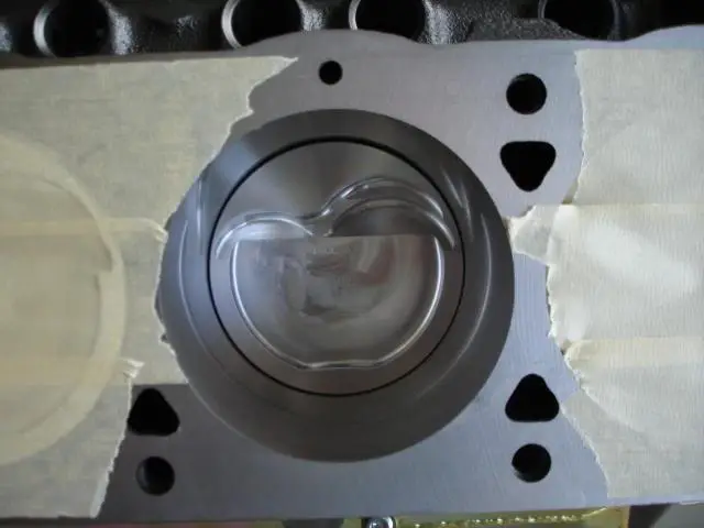

What was the C/H on the pistons?
1.175

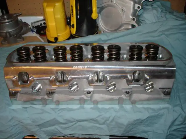

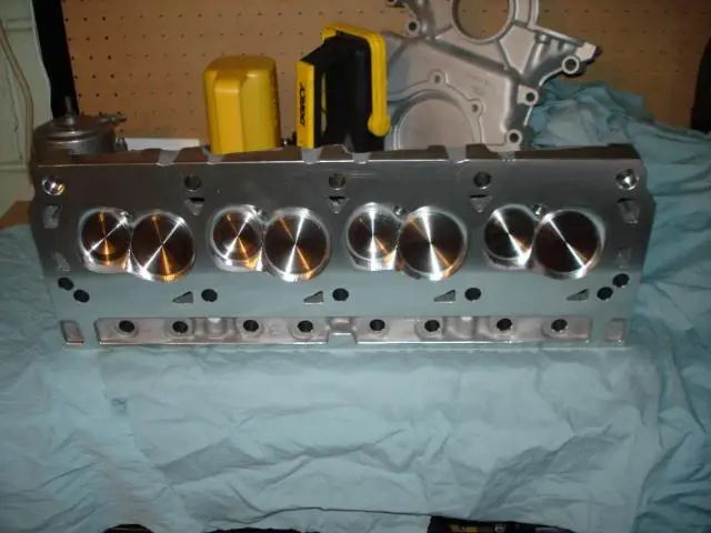

TFS TEA cnc 205 heads

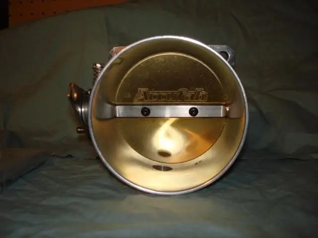

Accufab 90mm t.b.

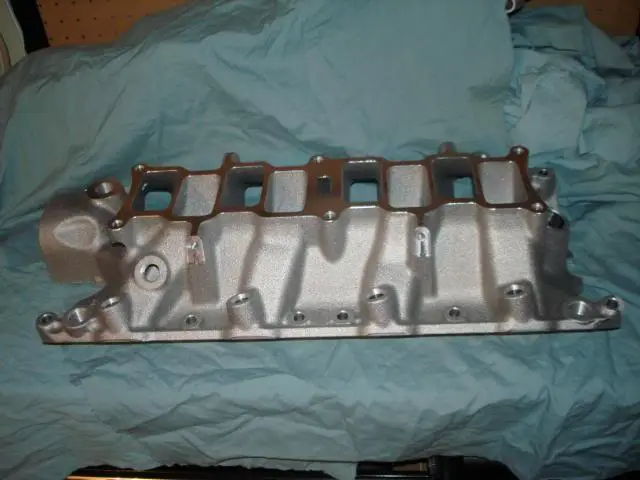

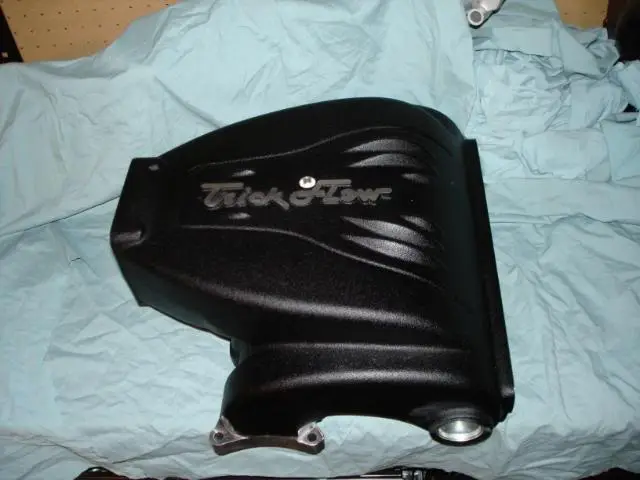

TFS "R" intake w/ 90mm opening

Jay wanted me to go with this intake, probably knowing that I want to keep my stock 96-98 Cobra hood.

That tb is way too big, you don't need more than a 70mm according to internet flow calculators :rlaugh:

Yeah..........I know, maybe I should have went with a 65 so I can make more torque......:rolleyes:

Cool! So how much additional horse is the Mexican block good for? There is internet BS floating all over the place, but most of the people slinging it are the same people that could "take your slow azz from a 30 roll."
Are you gonna pull the pan or wing it? Take some more pics if you pull it please!

It's no so much the horsepower that will kill it but the rpm. I have seen this block be spun to 9000+ rpm for years of relaible service. I'm only going 7000 rpm max.
I might pull the pan and see how everything looks. Thanks....:D
