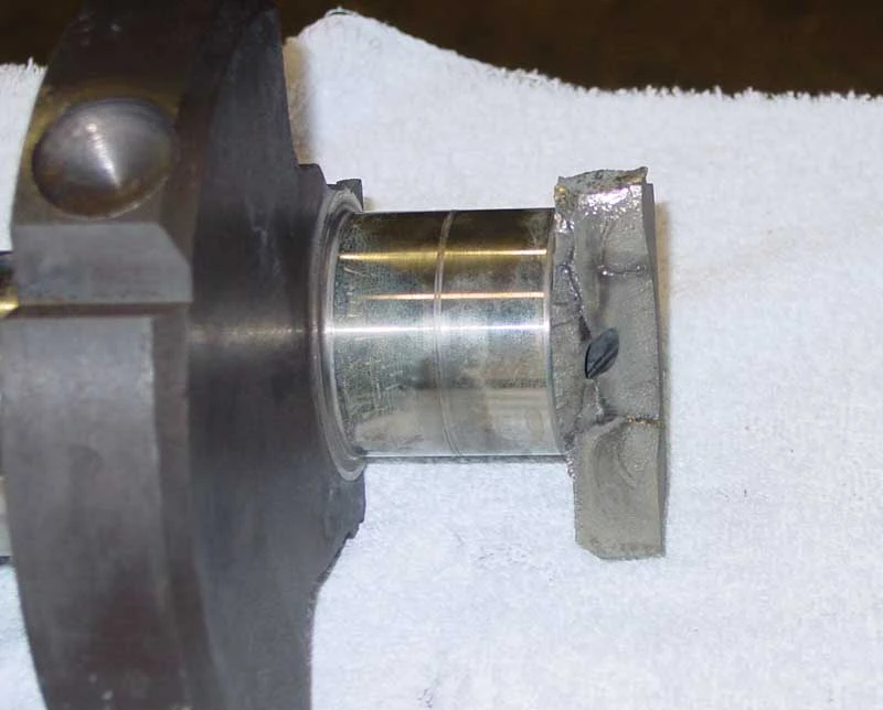

Although this is not a Ford crank, here is a crank that came out of a professionally built engine with about 300hp. It was aid to have 7000 miles on it.
Let me guess------- Chevy crank? :D Right ?

Route666 said:
I'm no real professional, but that crank looks like it had other problems as well. The scoring in the middle of the journal looks like it had crap in the oil. Or is that normal?
That's normal. It's the split between the two rods.
