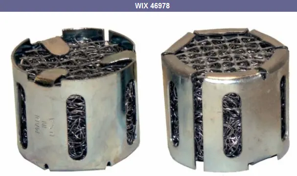

That is a good point. Do not forget the breather element below the PVC valve to keep oil from splashing into it.

PCV is in the back, whole system (screen included) was replaced, no change as stated.
