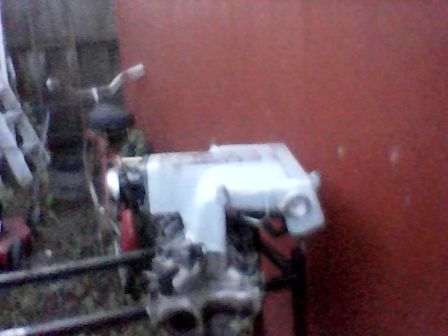

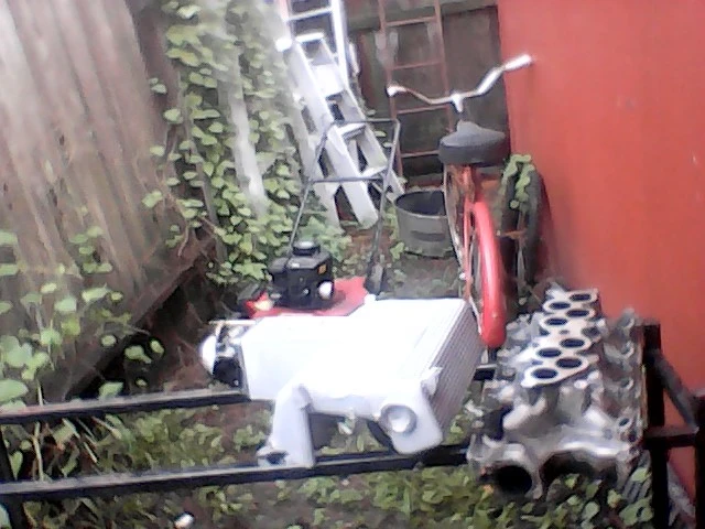

just found a explorer with the heads and intake on it, do I use my stock tb on my 5.0 on the exporer intake?, and if that explorer has the exp intake on it does that mean it has the gt40 heads,and any other help would be much appreciated,and which gaskets do I get, one for my 5.0 or for the explorer, I went to a new pick and pull this morning and found 5 explores which they all had heads and intake

got the intake and the 65mm tb, do I use my egr spacer, I,v seen pictures of people running no egr spacer
