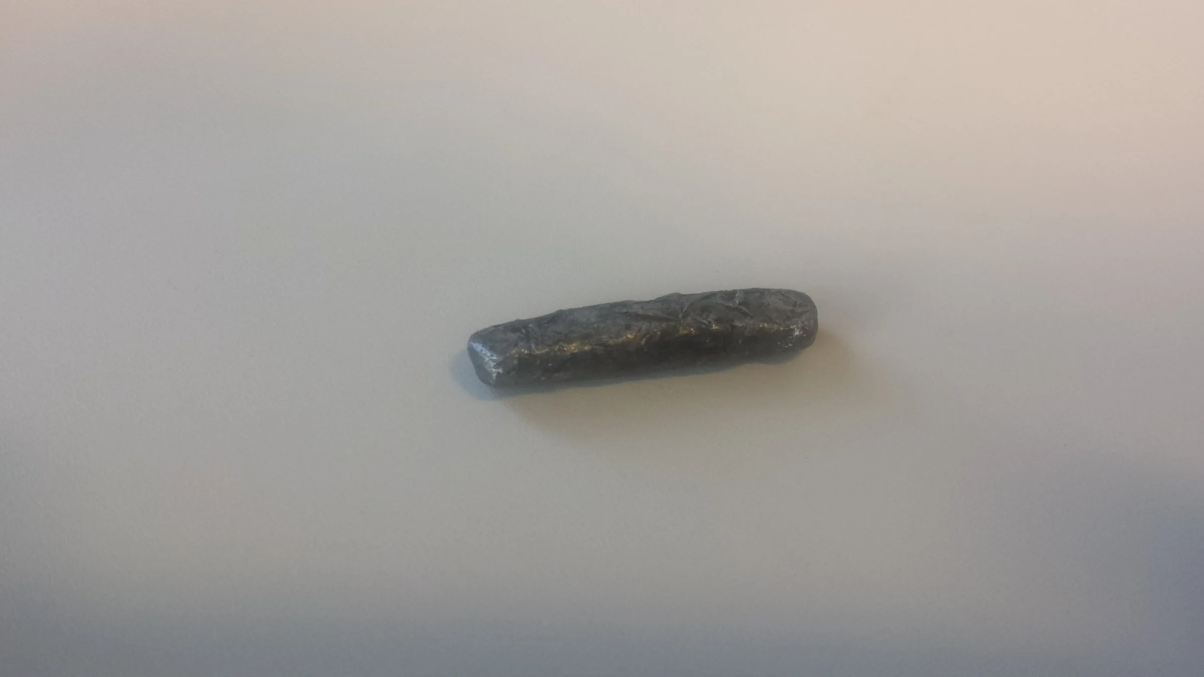

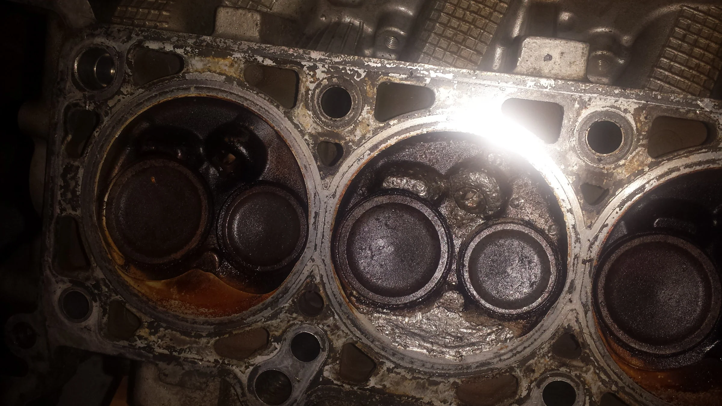

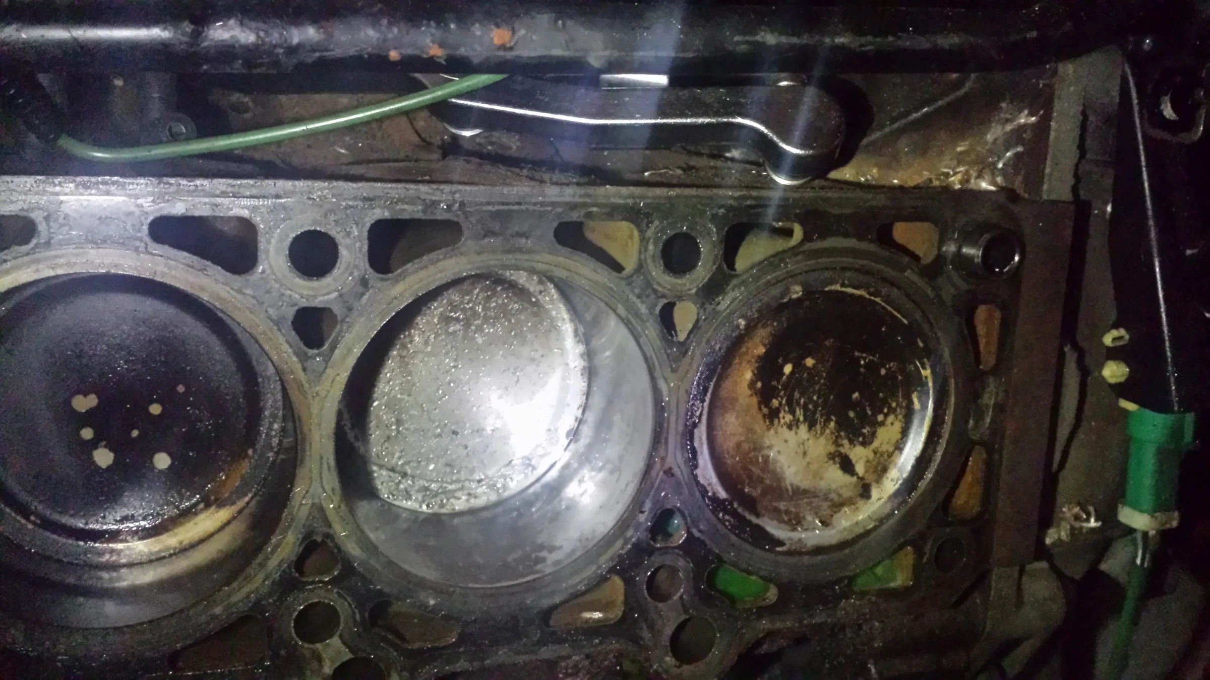

In any event, we found a 1 inch piece of metal in the cylinder which is pretty hammered, also noticed that the head of the piston has a bunch of nicks and the chamber on the head has some marring where it should be smooth. Spark plug appears to be sitting way to low in the head. Also, head gasket was not compromised between cylinder and coolant passages, but was delaminated (as in layers of head gasket were easily removed from each other) I am planning to replace head, but wanted to get some feedback. First, what is this piece of metal? Intake plenum was replaced about a year ago. Wondering if something fell into head. We were pretty careful about plugging with rags when removing intake. Second, will the nicks on the top for the piston be a problem. I plan to replace head and gasket then do a compression check. Lastly, head is probably shot due spark plug issue, but would the damage to the combustion chamber be an issue. May be able to smooth down, but any professional work may not be cost effective.

Appears to be steel. Took a magnet to it to test.
Adding more pics of the head and piston.

Looks like it’s time for a new engine. With those miles on the engine, I wouldn’t waste putting a new head on it. The rings won’t be able to hold the new pressures of the new valves. Engine will have a crap load of blow by.......especially form that #7 cylinder. The walls are toast

Hey @J$hort, I know this thread is pretty old but I had a piece that looks exactly like this come out from my exhaust system. Did you ever find out what is was or where it came from? Any help would be much appreciated as this is the only image or thread I’ve seen with the piece of metal that looks exactly the same as what came from mine.
