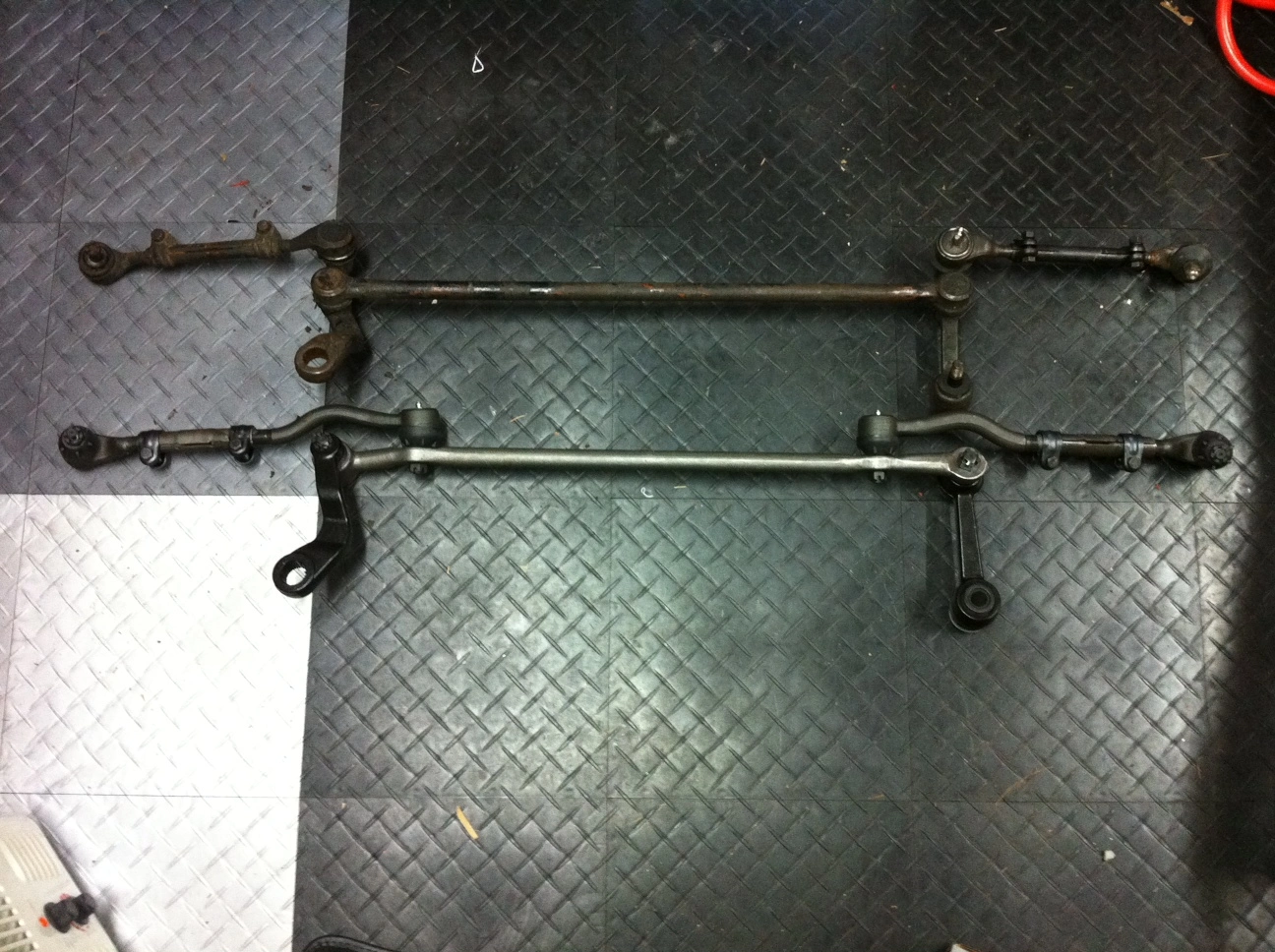

4 lug spindles are not too weak for disc brakes...there are several kits out there designed to fit 4 lug spindles right now. That being said, neither the factory I6 or the factory v8 spindles are very good for heavy cornering...but for normal driving, most people like to upgrade to the v8 spindles. Differences between steering setup for I6 and v8:
left is v8, right is I6...pretty much every component is different.(Early 65 production v8s shared the I6 steering from my understanding, but don't quote me on that) As you can see, the I6 tie rods are shorter...meaning I6 spindles have longer steering arms(or so I would assume).
In short...its more complicated than just a spindle swap. For those who race vintage mustangs, they like to actually use 69-70 spindles, which are stronger under the stress of high speed cornering.
