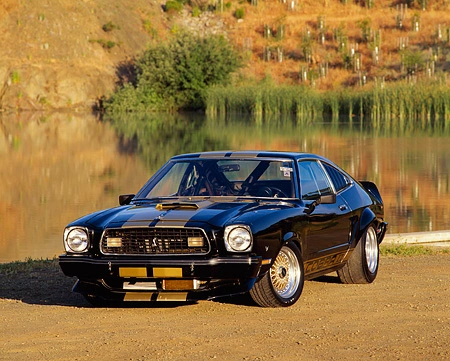

Except for the fact that they are (arguably) the worst looking mustang. Maybe besides the II.... this is JMO however.
I still don't know how reasonable people can say that this glorified econobox with pasted-on black rubber trim is better looking than any generation of Mustang (II included which I happen to love). The "cool" ones had the cheese-grater tail-lights, Taurus headlights, and plastic for miles. The ugliest ones were indistinguishable from the Escort. To each their own, but "looks" is not an argument you'll win outside of the Fox forum.

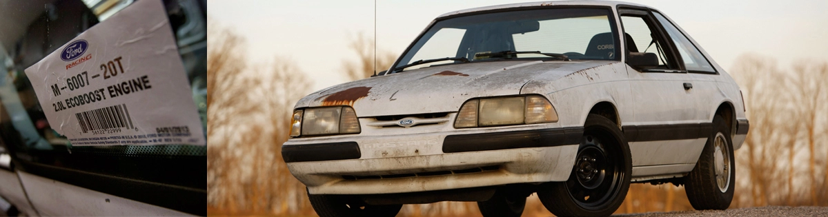

Says the sn95 owner. My car does not look anything like those nor do any well done foxes.
Way better than this thing.
look at all that plastic and half the thing is held on with double sided tape... and all the lame body kits people put on them don't help

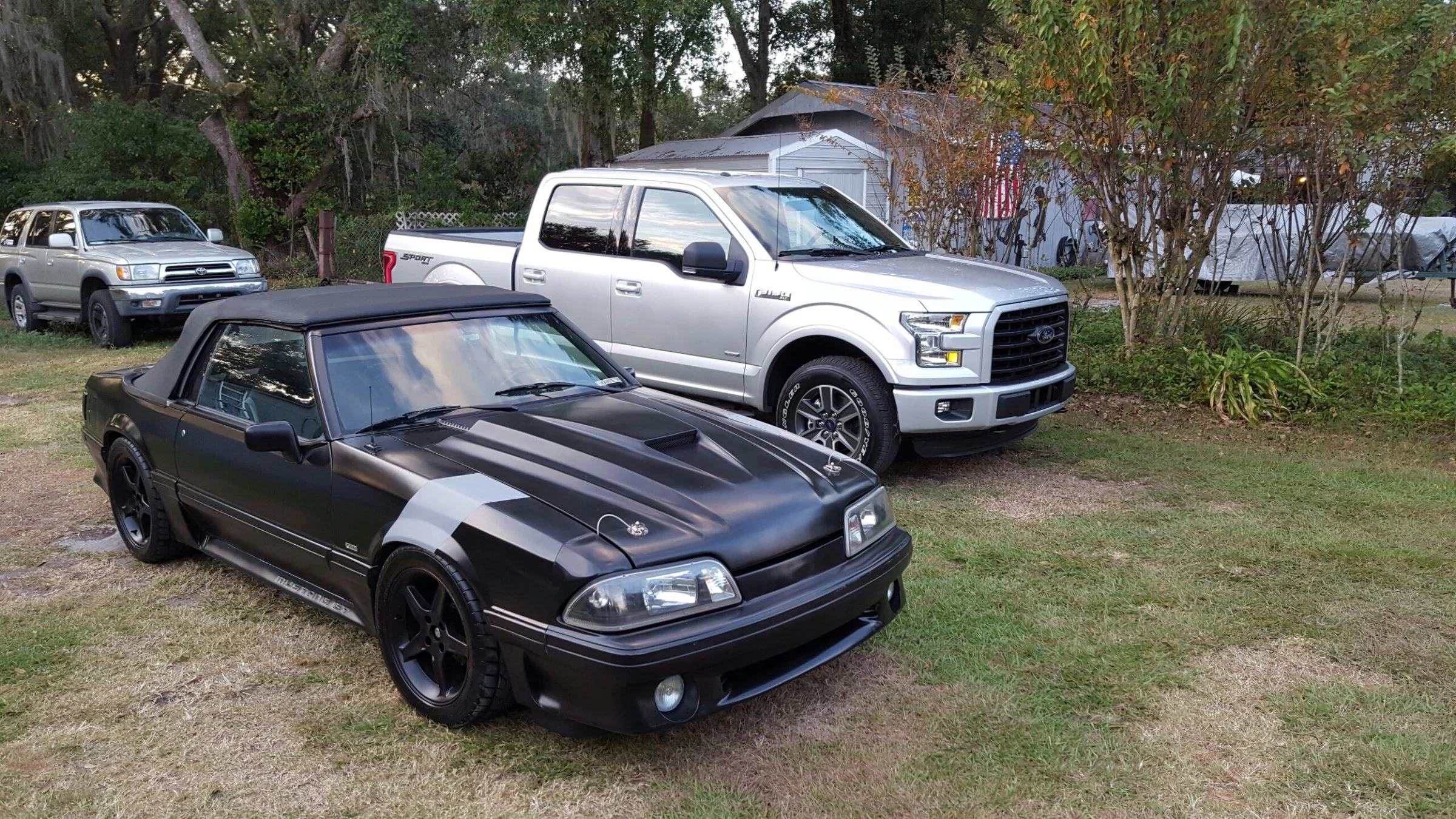

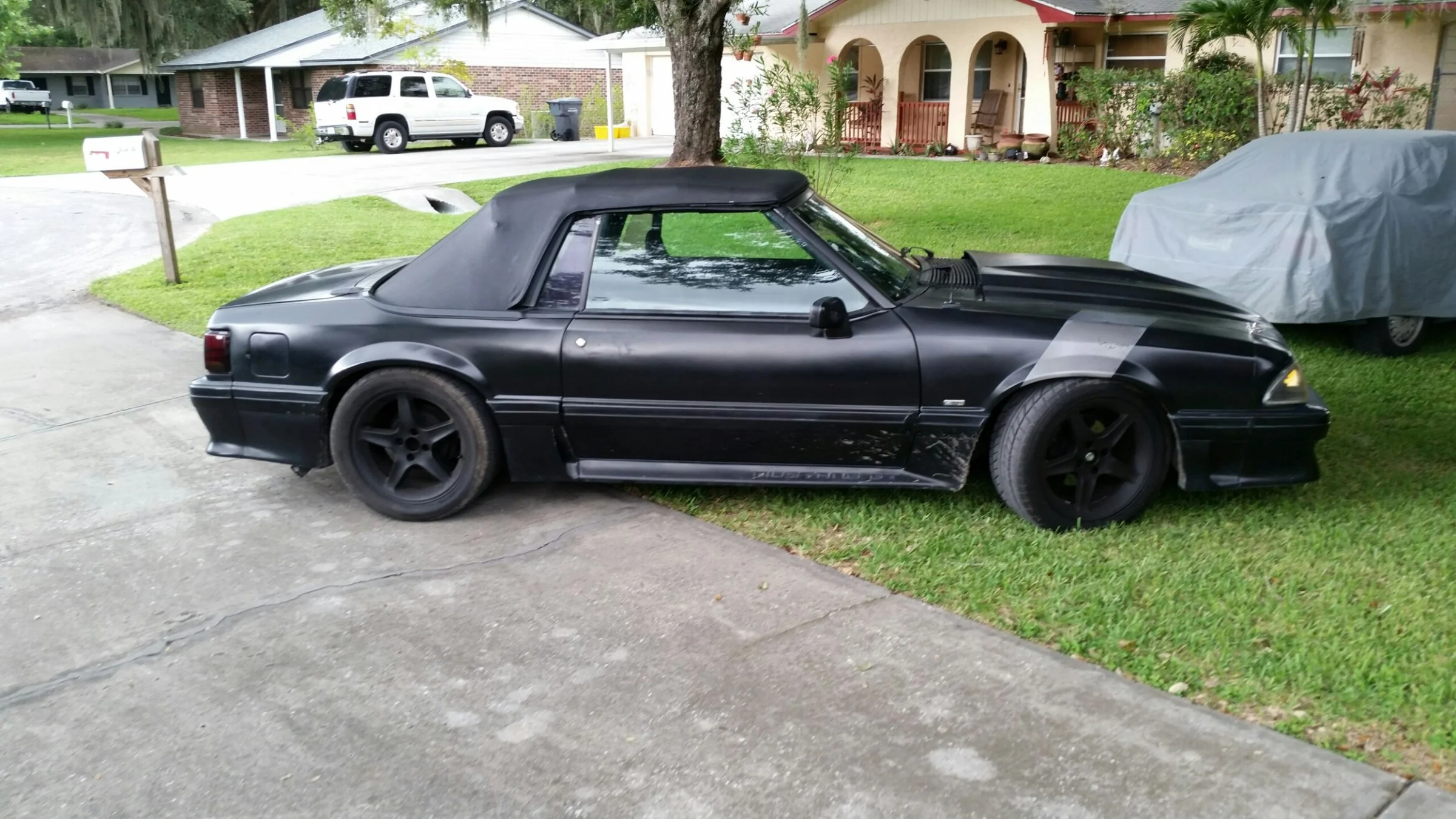

Looking from a pure performance standpoint both platforms have good qualities. The fox is light most of us are going to upgrade suspension parts from stock so things like U/L control arms, coil overs, shocks and the like are a given on both cars. The fox desperately needs subframe connectors, the sn95 got a lot more bracing than the fox.
The fox platform came with 4 lug wheels and smallish front rotors, to remedy this most do a 5lug upgrade to the car. Both platforms will need upgraded brakes but the fox will need spindles rear axles and a brake booster. The upgrade isn't difficult for most wrench turners. Other options include a rotor and pad swap for the fox which do work well and haul my convertible down from 100mph on an 1/8th mile dragstrip easily enough to take the first turn off.
