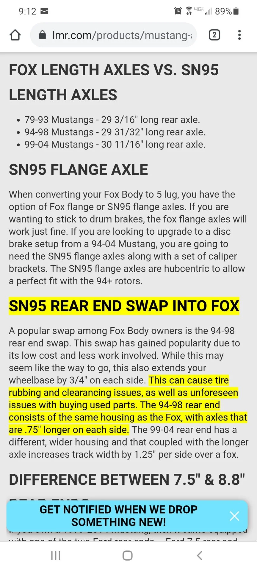

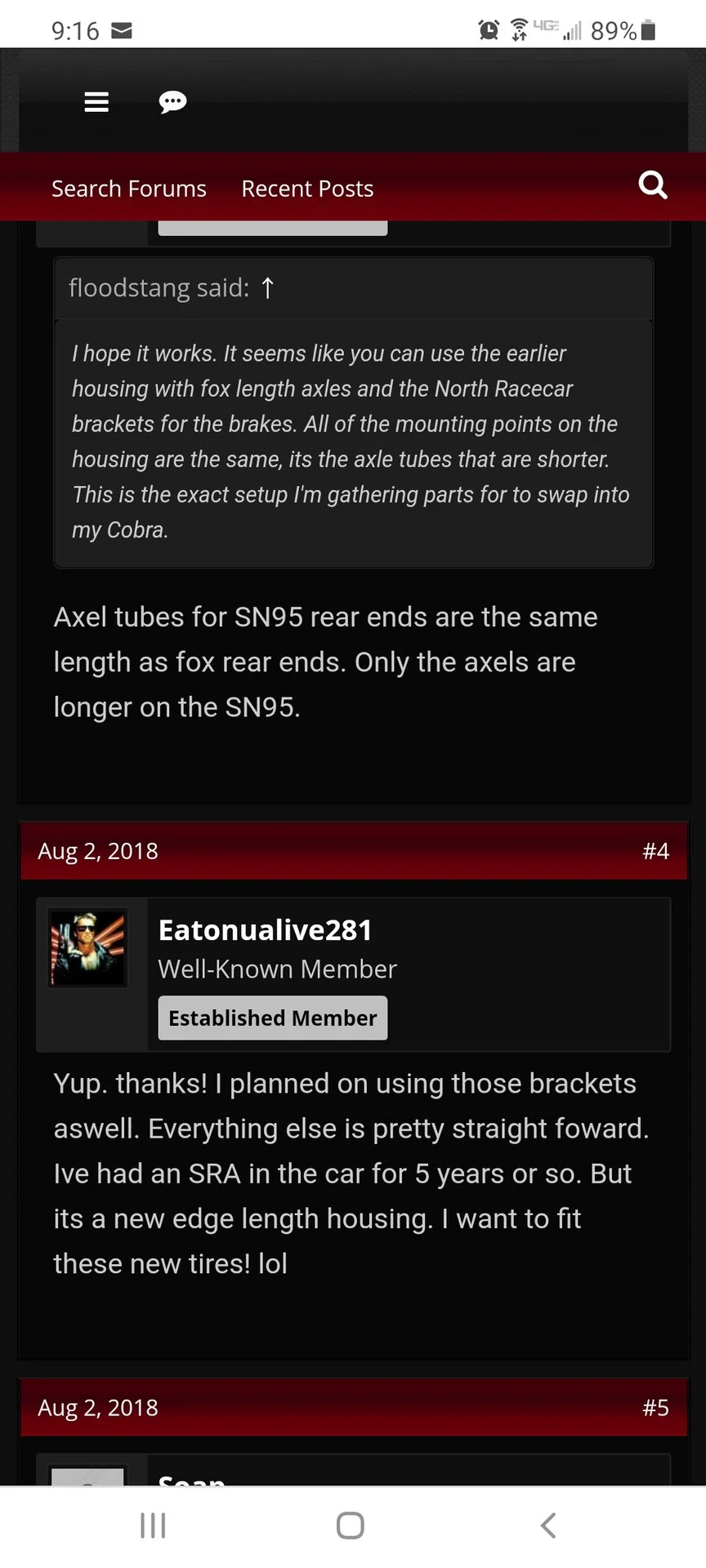

It depends which sn95 rear it is ( I think ). Consensus says the 94 to 98 housings are the same as the fox...but the axles were longer to accommodate the ABS rings. This would mean fox axles will fit...they'd have to be 5 lug...or that one side of old square Rangers or old Aerostar vans. ( I've done it many many times but can't remember if it's the passenger or driver's side that you need 2 of ) People with sn95 cars do this to get a deeper offset wheel in the rear of their cars. You have to cut and swap the caliper brackets from one side to the other.
From LMR website.
From svtperformamce.com
