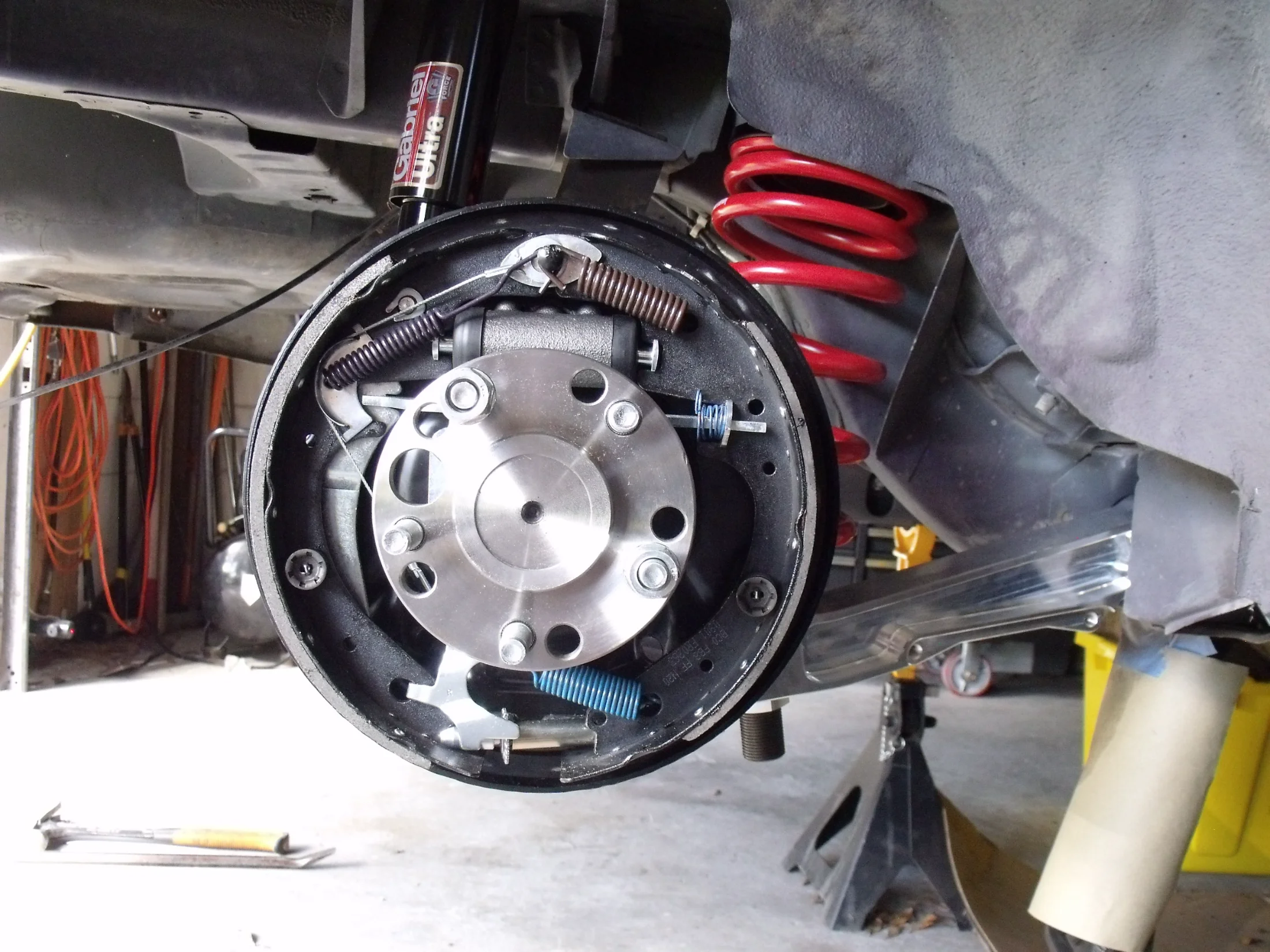

Thise were long gone by the time I bought the car. It has the Steeda upper and lower control arms and Steeda springs.
