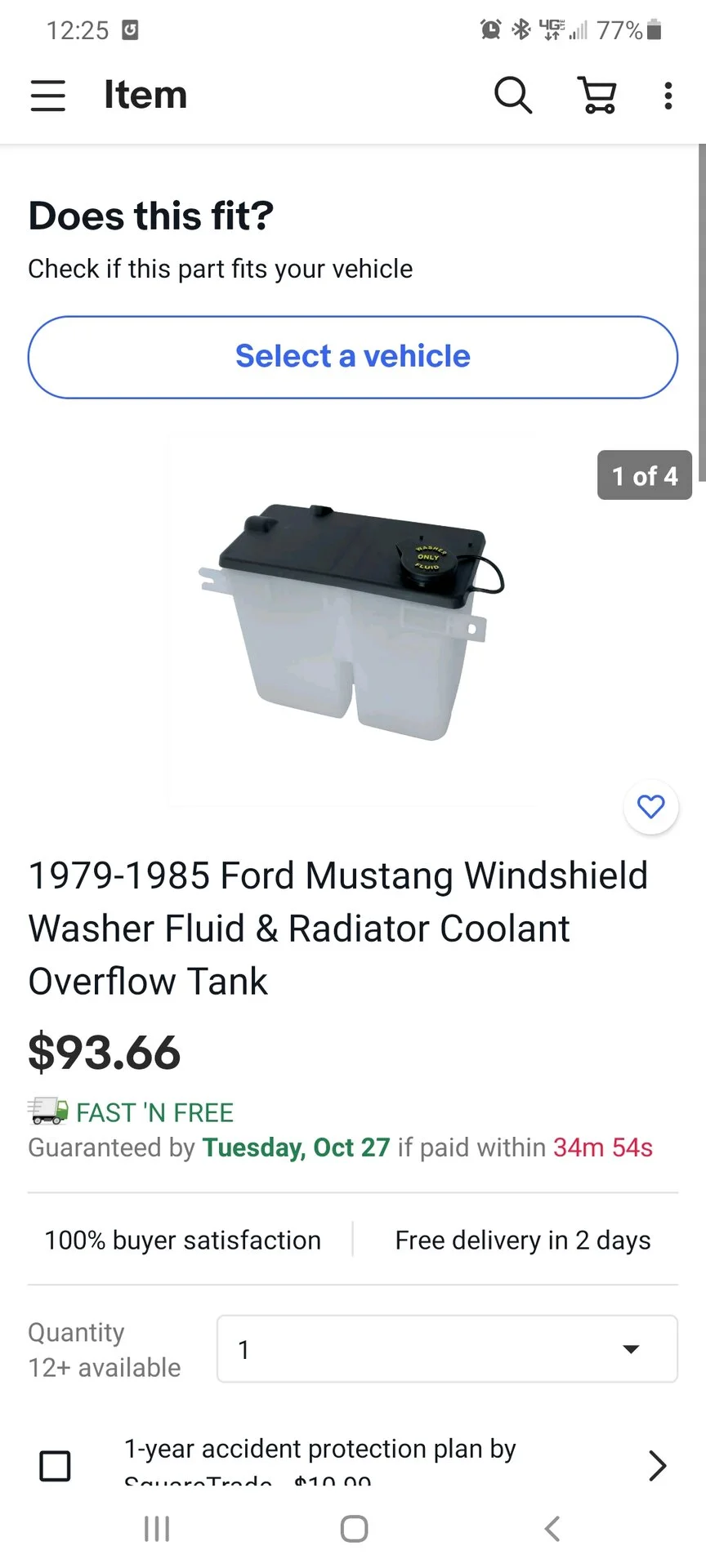

I was going to relocate my battery to the trunk and use a 82 mustang gt coolant overflow and windshield fluid tank. It sits in the location of the battery. Just haven't gotten around to it.

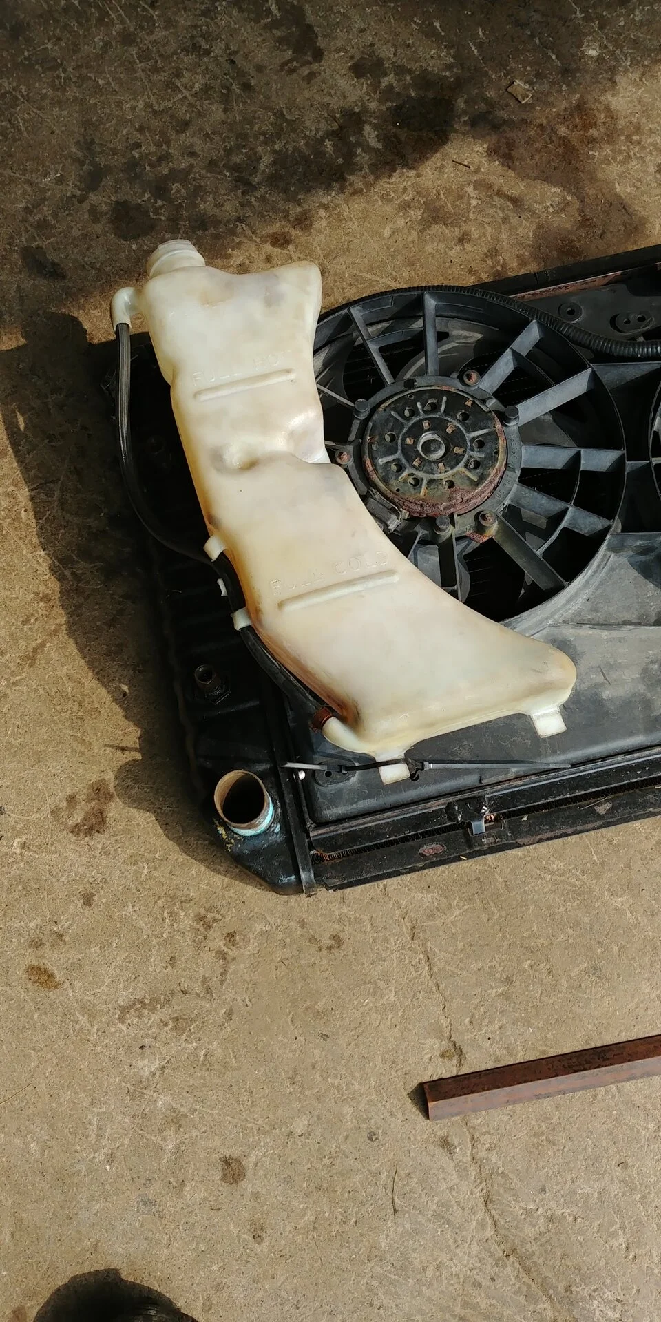

Only thing I found so far is maybe the Canton 86-93 over flow tank, is slim and uses the factory sensor... Was hopeful for a junk yard solution, but never found anything.

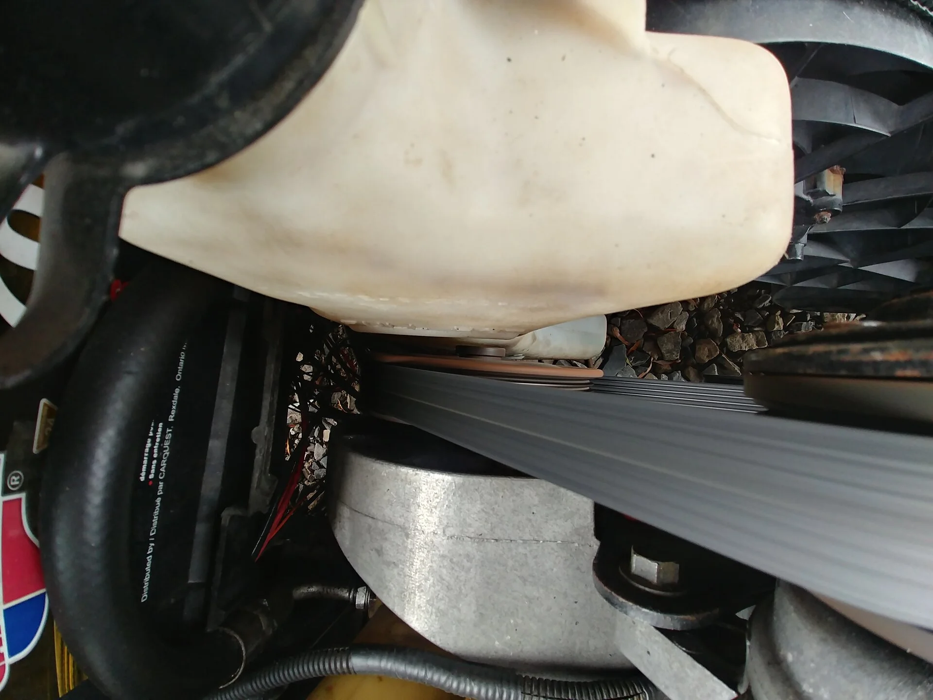

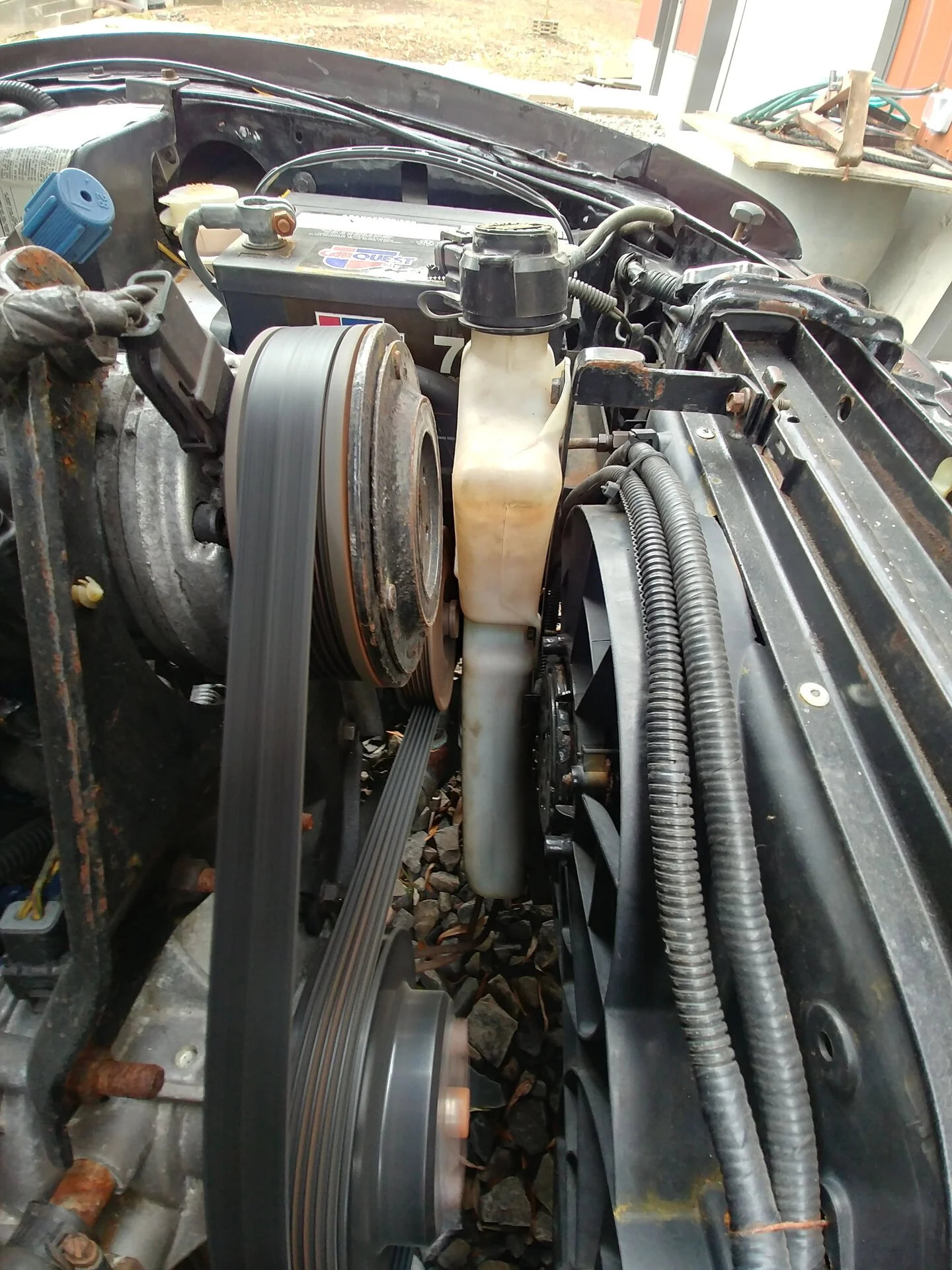

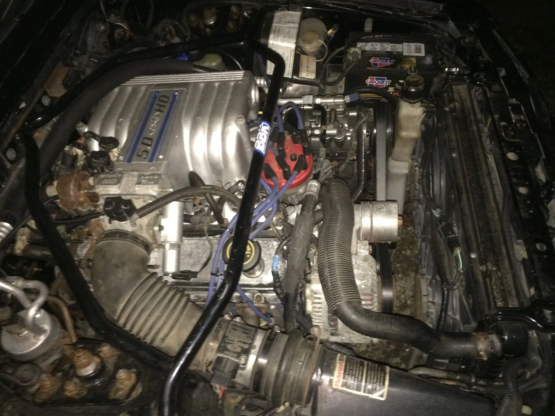

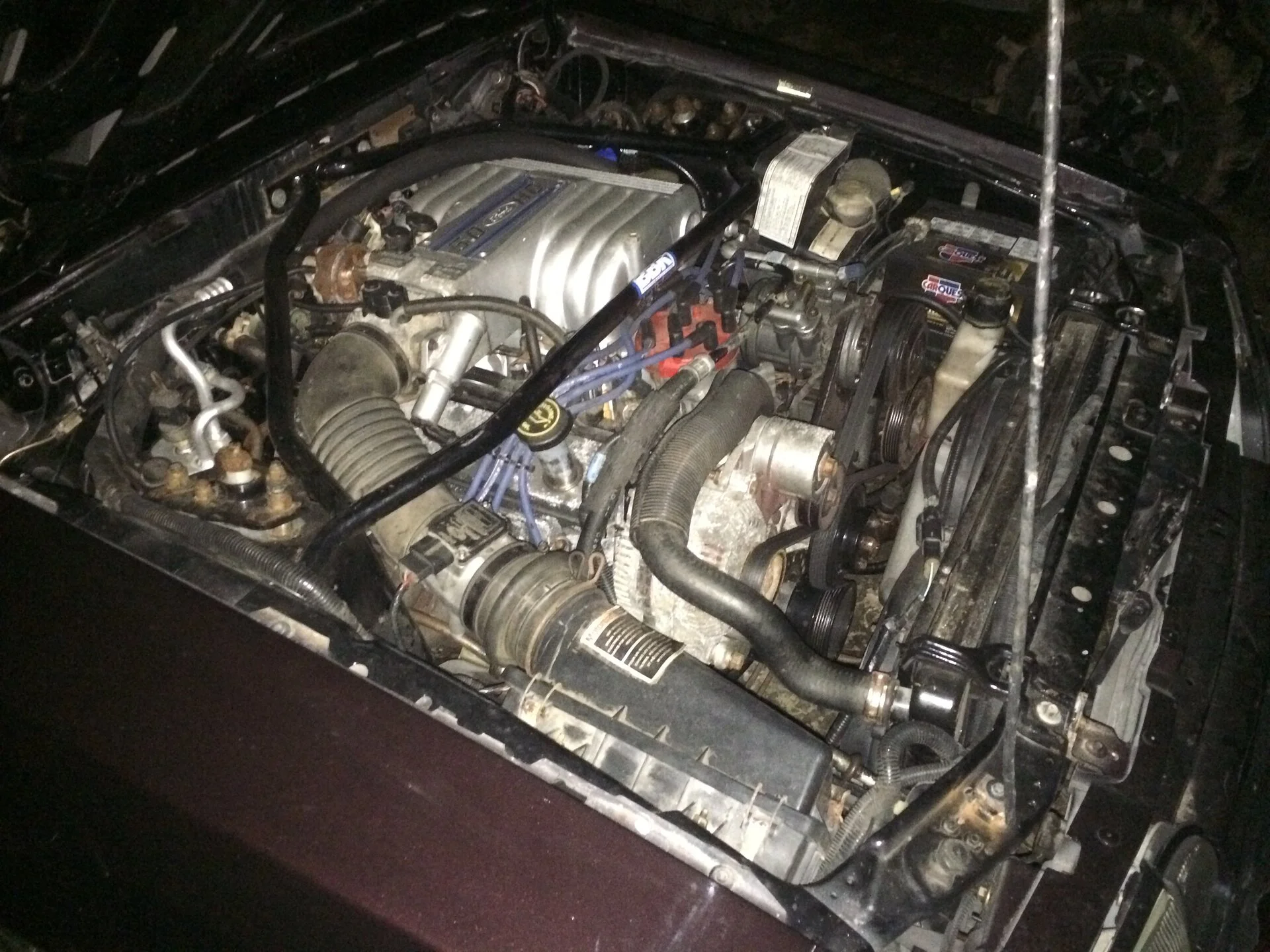

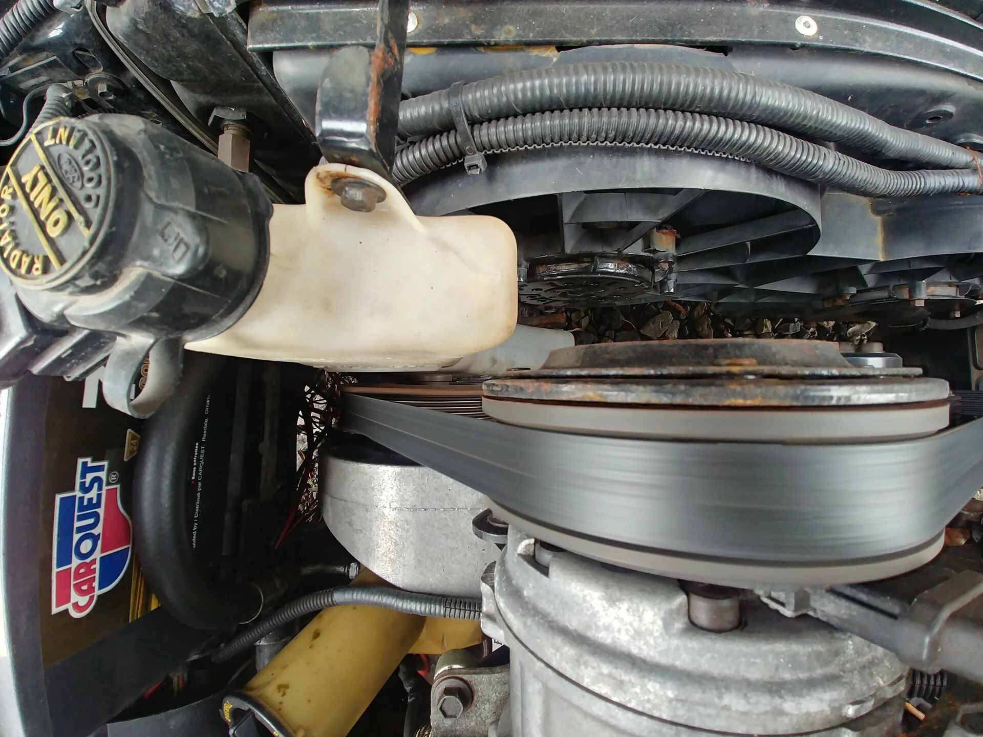

I am using the factory overflow tank. Just fits with a 3 row radiator.
I initially zip-tied it, but last summer a fab'd a bracket to hold it. If fits without hitting A/C or PS pulleys, though it is very tight. So far, 3 years and 12,000km with no issues.
If you want I can get a pic of it installed in a couple days.

That would be great thanks! How much clearance?
Trying to do this stuff all right first time around, V3 SI, Contour fans, 3G.... I should have stuck with my Kenne Bell 2.1, had no clearance problems....
PS pulley stub aligns with recessed area in tank. Clearance 1/8" or less at the stub, but it has never hit. Belt and pulley clearance, not a problem at belt edge of pulleys.
A couple of old pics. Not great pics for what you are looking for. Will get some better ones when I go down to put away for the season this week.
