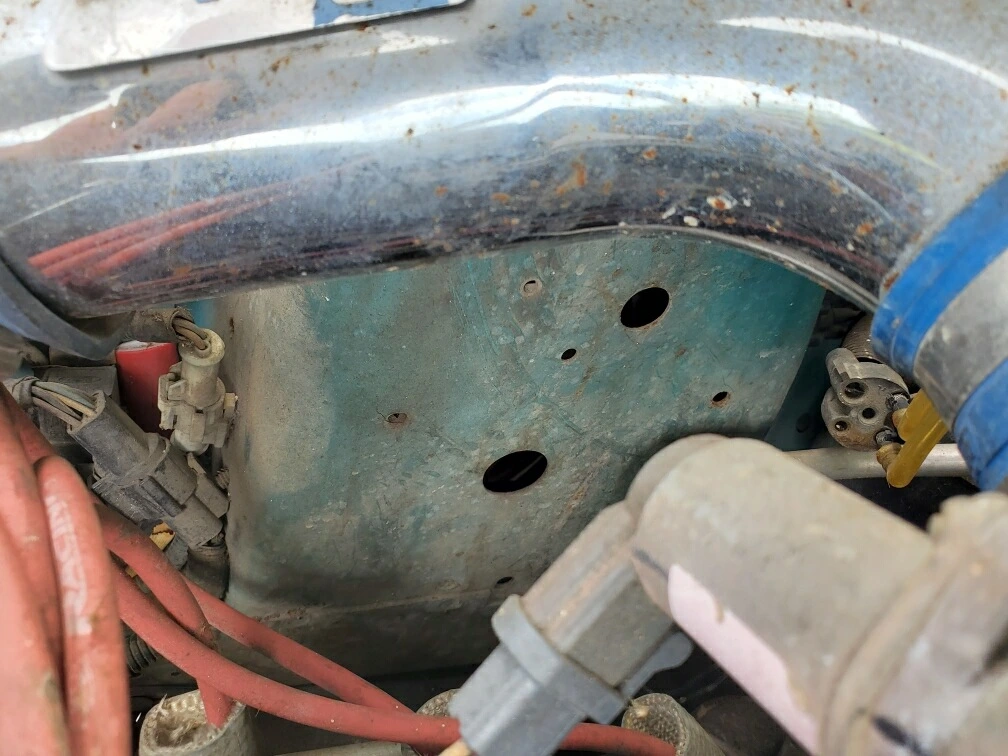

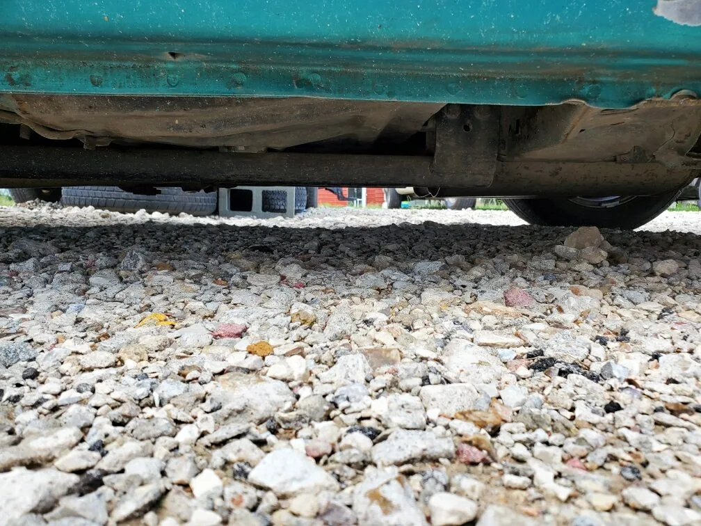

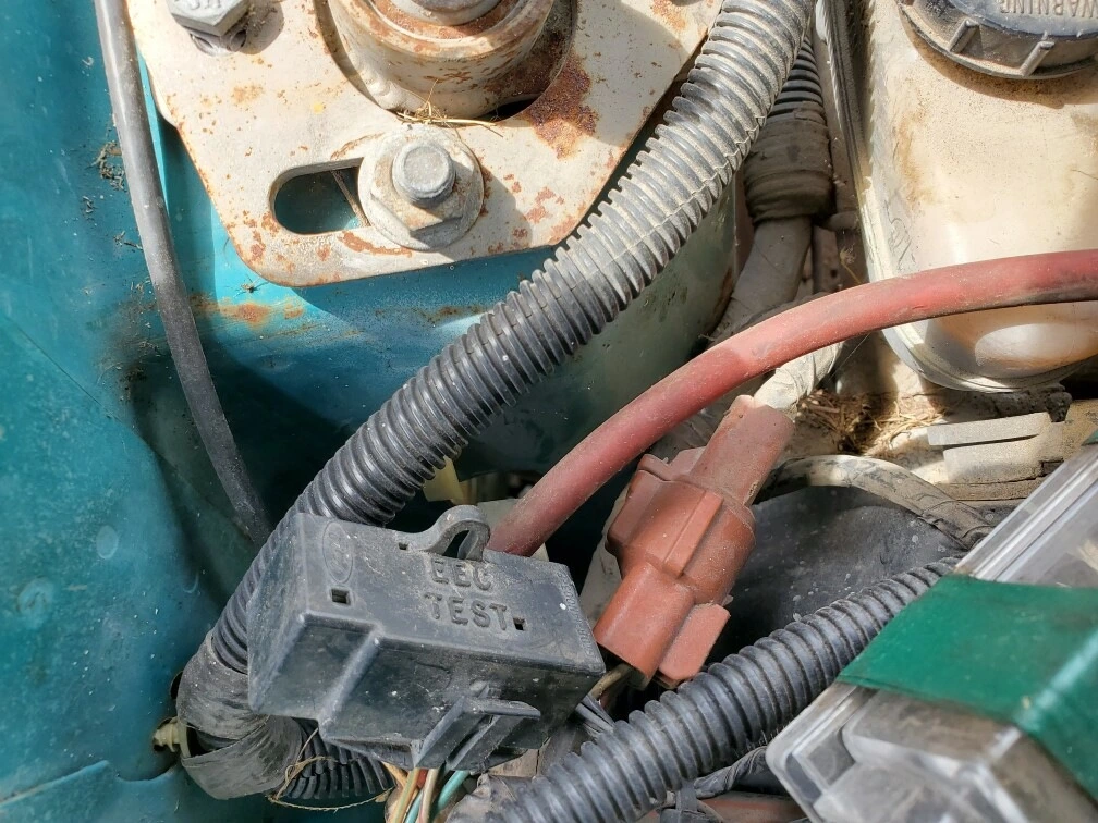

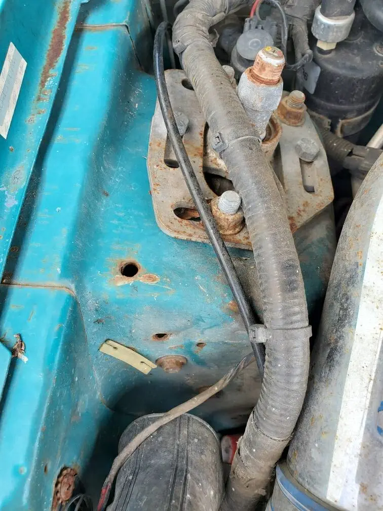

Speaking of craigslist, I contacted the seller of that green mess down in Texas. He sent me some pictures of the shock towers. He said there was no rust in the ad,
I don't know how bad it is, but it looks like there's quite a bit of rust on the inside of the tower. It would be one thing if it was just surface rust, but the area around the bottom bolt of the strut mount scares me. I think this one's out.

Ask seller to take photo down the shock tower towards the ground.
Drivers side is usually worse. A little spilled brake fluid or a leak corrodes the hell out of the metal

The green car has probably lived it's life in Houston..which is very humid, and right next to the ocean. Bare metal will rust just by exposing it to the air. The humidity where I live is always fairly high, but Houston humidity is equivalent to "salty-wet-air."
I think that is what you are seeing with the green car. It needs a seller willing to put the car up in the air and take the necessary pictures you'll need.
The car has lived a rough life. The owners a pig. The sub wiring tells me that the rest of your wiring harness is probably gonna be hacked. The drivers seat looks to be broken too. ( All the telltales of a car that has had a too hard life)
But,...like I said. If the rest of the body isn't a rusted out hag-mess, I'll take a neglected GT/LX over a well care for rust pile any day.

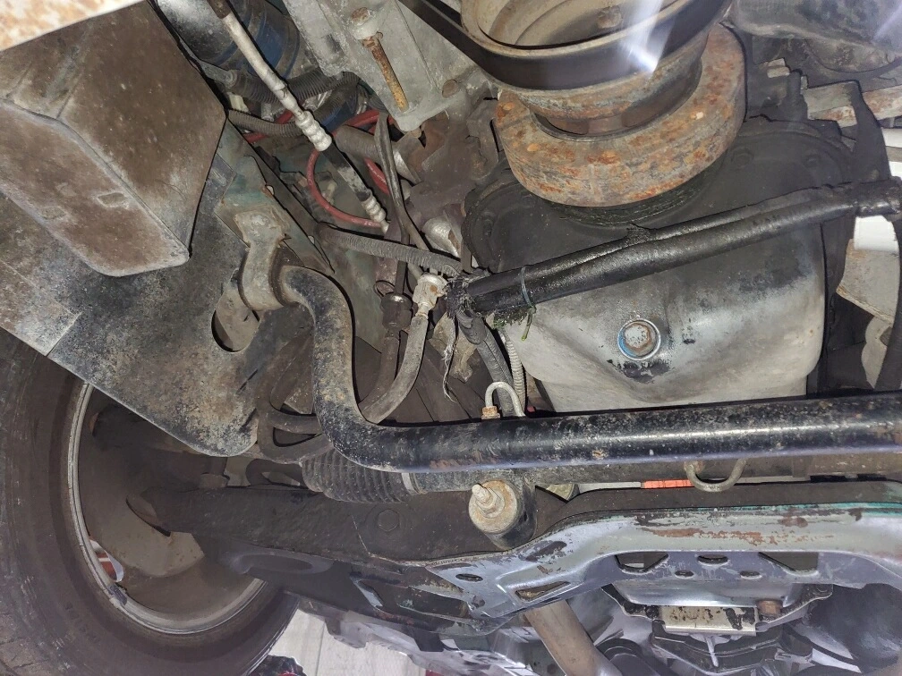

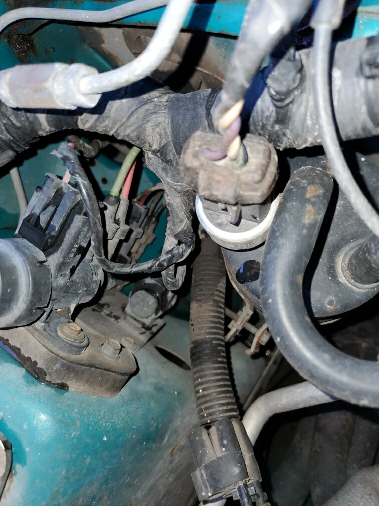

The rest of it doesn’t look too bad, just kind of crusty and gross. I’m just concerned about the passenger’s side, some of those holes look pretty flaky.
The fact that he has two febreeze air fresheners in the vents is...alarming.
Here are some more photos:
There are a few more, but I’m on my phone right now, and uploading photos from mobile takes forever.

I’d want to see under the carpet. Top left corner of the last pic is showing some signs of rot (I believe that’s the seat mount plate in the pic). The rust is likely much worse on the inside.

Good eye on the air fresheners. Multiple air fresheners doesn't necessarily mean anything (you'd be surprised how many I see in cars on a daily basis), but the fact that you're noticing little details like that means you're paying much better attention this time. Keep that up and you'll do much better with your next purchase.
Rust and electrical should be your biggest concerns right now, because as a beginner, they're your hardest things to fix.
Never take a seller's word for it on anything, especially if they're saying things like "It's just a fuse." or "The A/C just needs a recharge." A fuse can be fixed for no more than $5 on these cars, and even a professional evac and recharge on an A/C system is less than $150, (and DIY recharge kits to half-ass the job cost less than half of that) so if they haven't bothered with anything that basic, something more is wrong.

This is why you never take "Texas Car" in an ad for granted. If it spent its whole life in Galveston, Corpus, Port Aransas, etc, it could be just as rusty as the car that started this thread. If it was driven near the chemical plants and/or refineries of Houston, it could be even worse. I've seen five year old fleet trucks out of Houston that didn't have a cab floor left.

Driver side strut tower by the brake prop valve is usually the first spot to go... check there otherwise look over the floor pans as well as the corners where the pans meet up to I guess the firewall. Look at the door hinge area and look over the bottom of both doors and trunk/hatch lid as well. If it has rust in a spot or two then you have to assume there is more

Be sure to look where the shock tower goes into the frame rail. That’s the key rust area.
While I agree with people that say the driver’s side where the brake fluid can leak is a common area, it turned out it was my passenger side frame rail and lower shock tower i needed to cut out and replace.

Heard from the green mustang guy. I only asked for the strut tower mount but he put the thing on a lift and sent me a bunch of pictures.
