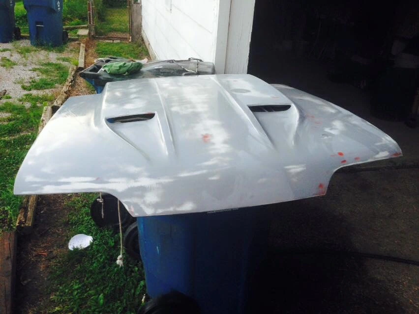

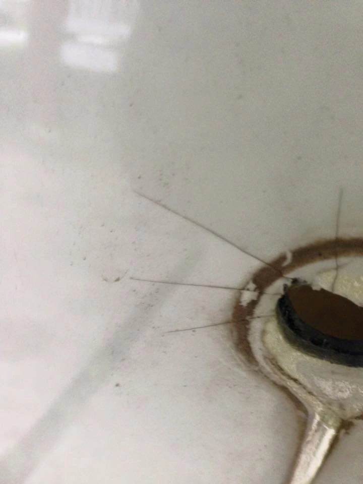

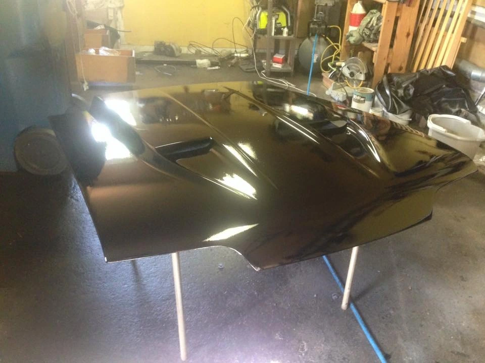

I think ( could be wrong) my issue was using filler( Bondo) on spider cracks. It was a black hood, after a couple weeks I could see a faint outline of the repair. But for a first time painting it was decent. Should of blocked more and I never got around to cut and buff. It was a single stage black like factory. Will Likely do the same on this one. It's s 88 top that was a factory 1c black that was painted white..
Painting a black car white is just wrong. I know it's a little more high maintenance for black, but it just looks better.
Help me here, is your hood metal or fiberglass? If it's glass, you'll want to use a mud deigned for fiberglass. You also will want to take the cracks all of the way out and do a more thorough repair. Glass work takes extra steps. Let me know.
Was the cracking due to an old repair in that area? You might have to go back in and take out the old repair if that's the case.
If it's just an outline of the repair around where you sprayed primer, just color sand and buff it out, unless it's pretty severe. The outline is just the paint shrinking back. This happens to a varying extent with all paints due to the solvents required for the paint to atomize enough to spray and flow out on the surface. When those solvents leach out of the paint, the paint literally shrinks in size, and unless the repair is done just about perfect, you'll see varying degrees of this problem.
Post a picture for me, if you would.
Single stage jobs can be a beautiful thing, it won't be as durable as a base coat/clear coat finish, but jeez it can lay out beautiful when it's sprayed right. It'll also have a depth to it that can only be achieved by using a pretty high dollar clear.

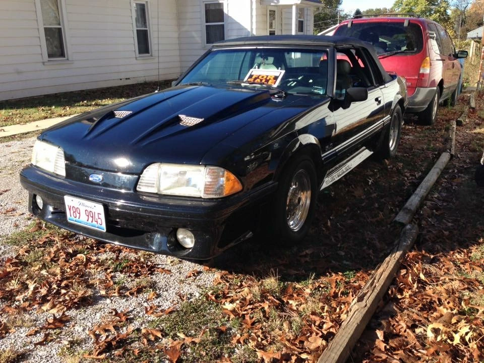

I'll see if I can find pics. I've sold that car. The cracks were spider cracks from old age and from drilling out the hood pins.
Yeah, the fiberglass is cracked through there, it would have to be dug down deep and use fiberglass matting with resin to permanently fix something like that.
I finally caught on that you sold that! I'll cover the repair process for something like that during this thread.
I used a Dremel and ground out the cracks then filled with Bondo, if I could do it again I would've done the same thing but use some kind of fiberglass instead. It was only slightly visible afterwards, honestly if it was anything but black I don't think you could've seen it, it wasn't even enough to catch your finger nail, so a cut and buff might've fixed it. I'm also a rank amateur

It's good to remember that fiberglass is still glass in the end, with a little bit of glue holding it together. When it cracks, it's breaking. Just like a window, you can tape it up if you want. But it needs to be cut out and replaced in the end. Not replaced like an entire panel, just the broken area.
You will want to use the appropriate fiberglass repair as well. Bondo is too brittle for fiberglass. It will eventually let go of the FG. The repairs for FG use fiberglass resin and varying types of fiberglass itself. From actual matting to small piles of fiberglass fluff (that, by the way, you will not want to go piss right after using! Trust me on that one, unusual and long term pain there). There are cans of fiberglass that you mix just like mud, but it is not mud. It retains the flexibility of FG, bondo won't.

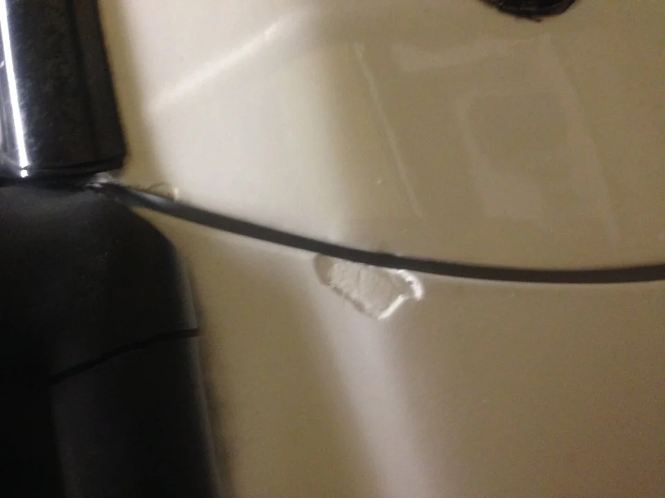

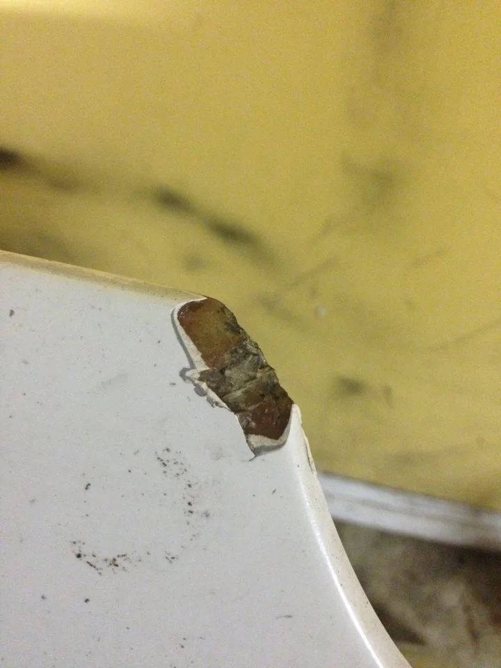

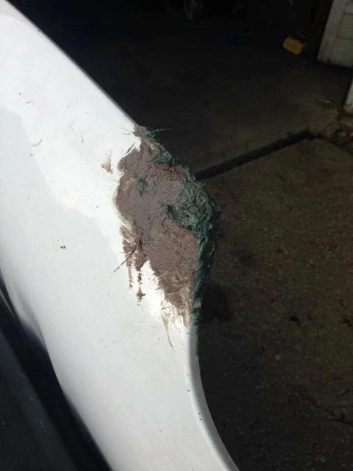

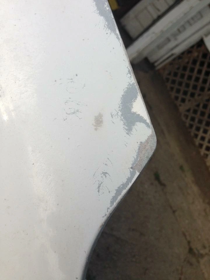

Looking over my car, I only have minor spots that need work. Some small chips on the edges of the door.

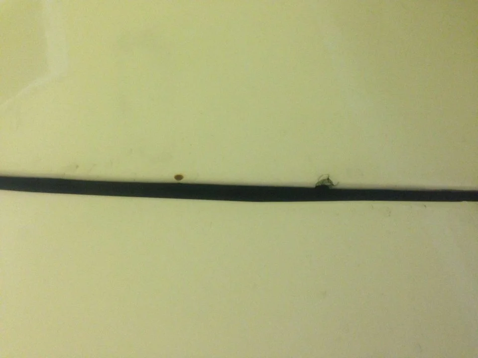

And one larger ( smaller than a quarter) chip. The larger chip was a small rust spot that I cleaned up and touched up but never did the body work to.
Suggestions ? The car will be black in all likelihood so I gotta go good.

Looking over my car, I only have minor slots that need work. Some small chips on the edges of the door.
Chips on the edge of the door are easy just take some 320 grit sand paper to,smooth them by hand. then back over it with 500-600 by hand.
The larger chip will need to be feathered out using 320 on your DA and primered with maybe two, three at the most coats. It'll be black and black shows EVERTHING, So block it out with at a minimum of 400 grit sandpaper.
If you want information on the feathering of the chip and how to block, let me know, I'll answer tomorrow, I'm off to bed.
