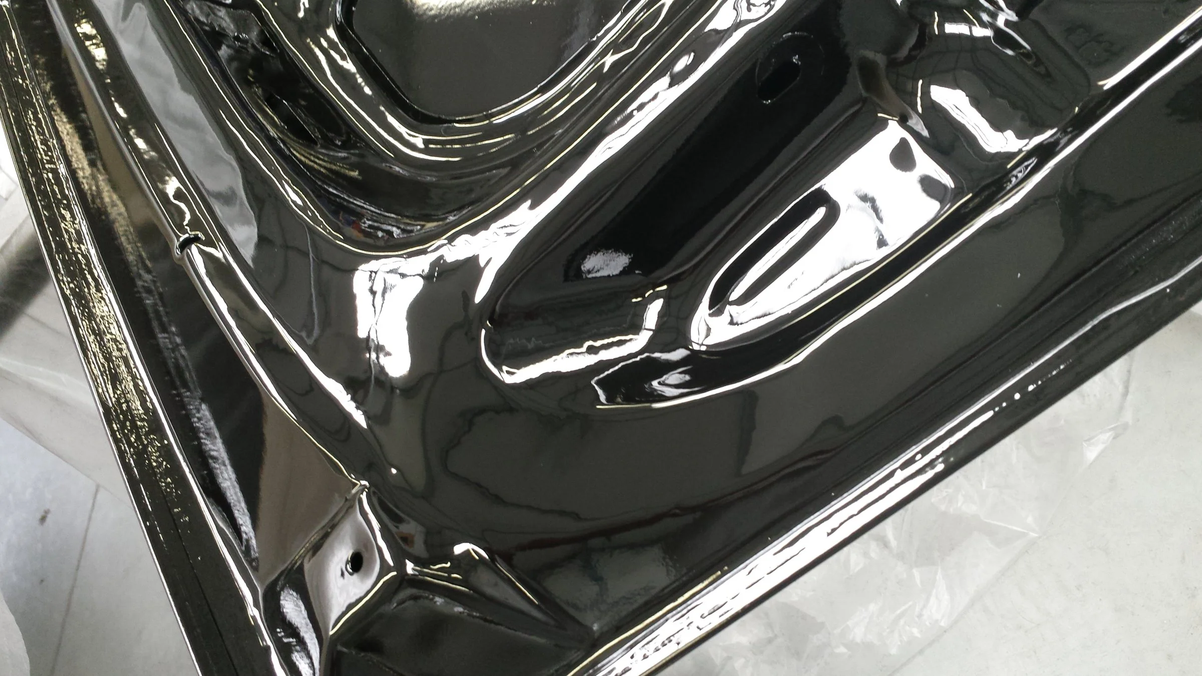

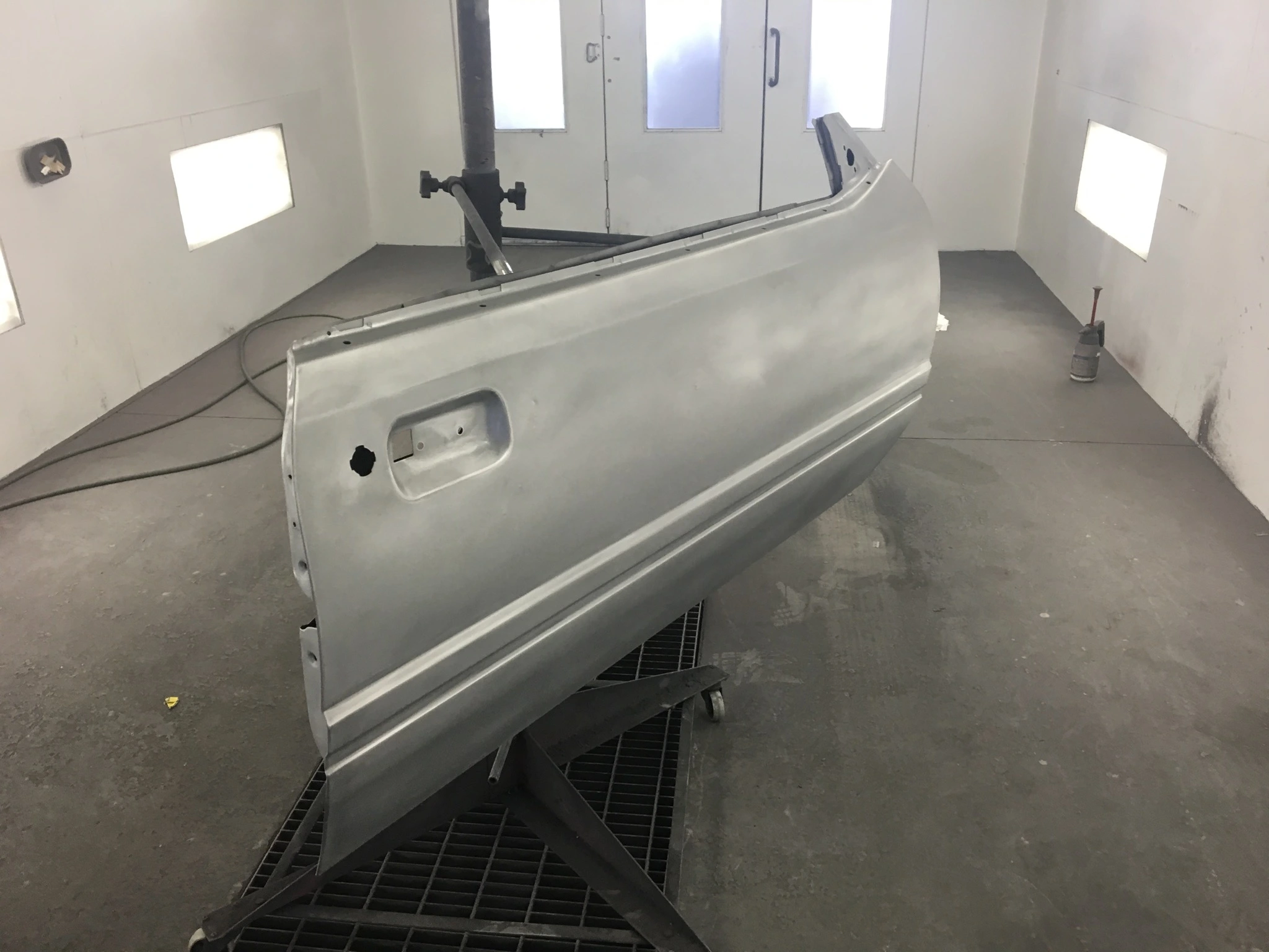

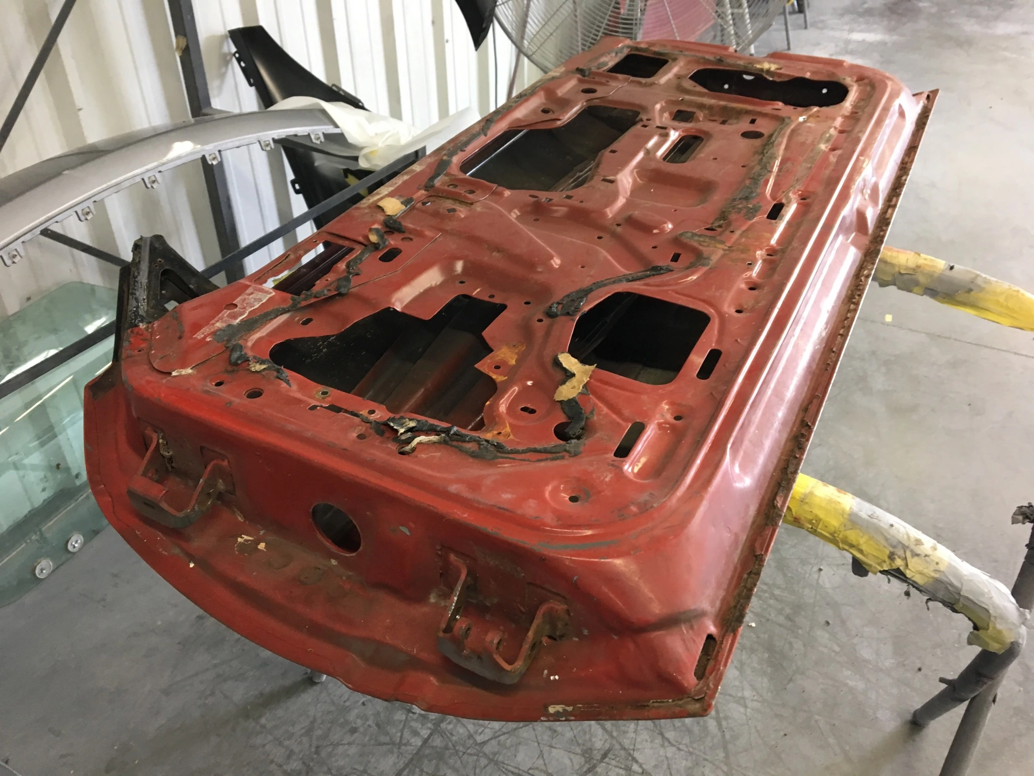

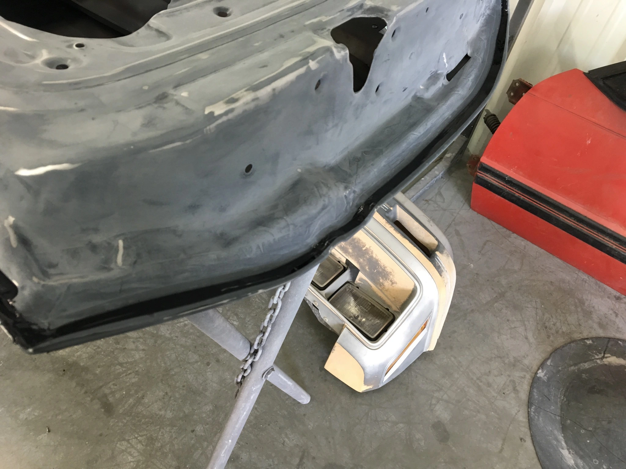

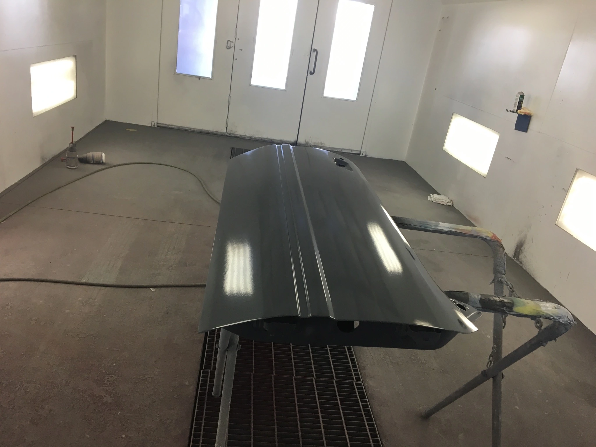

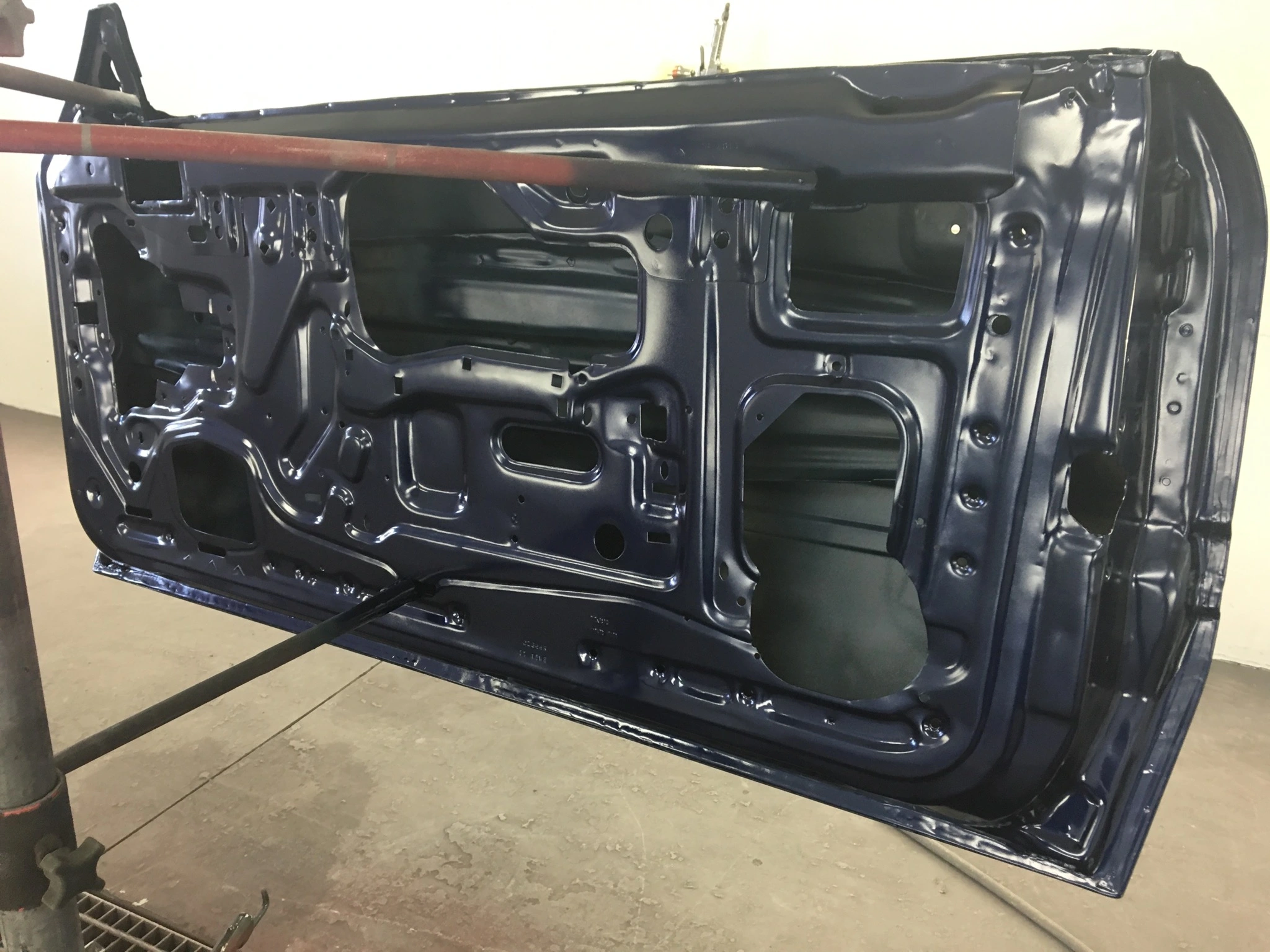

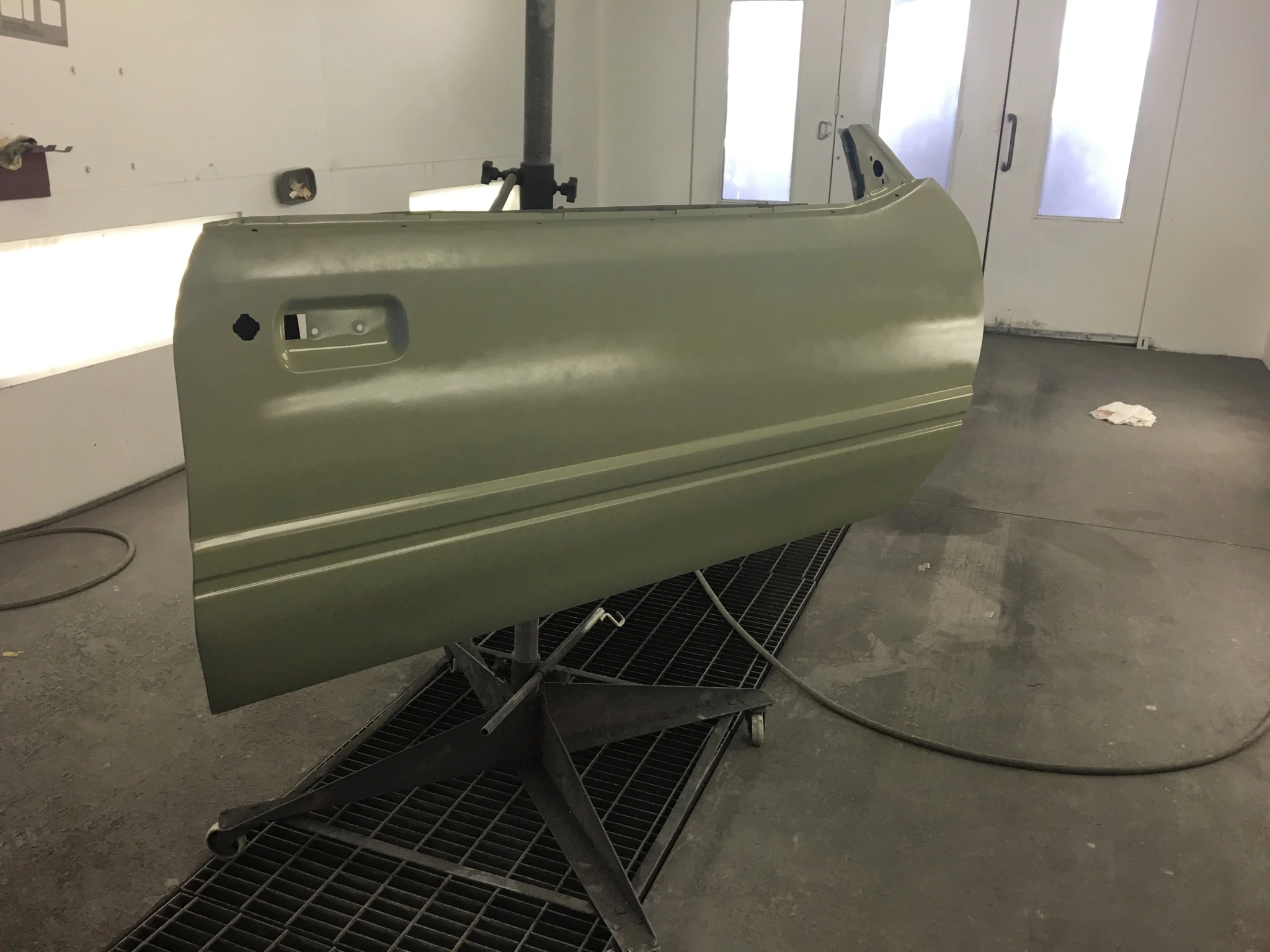

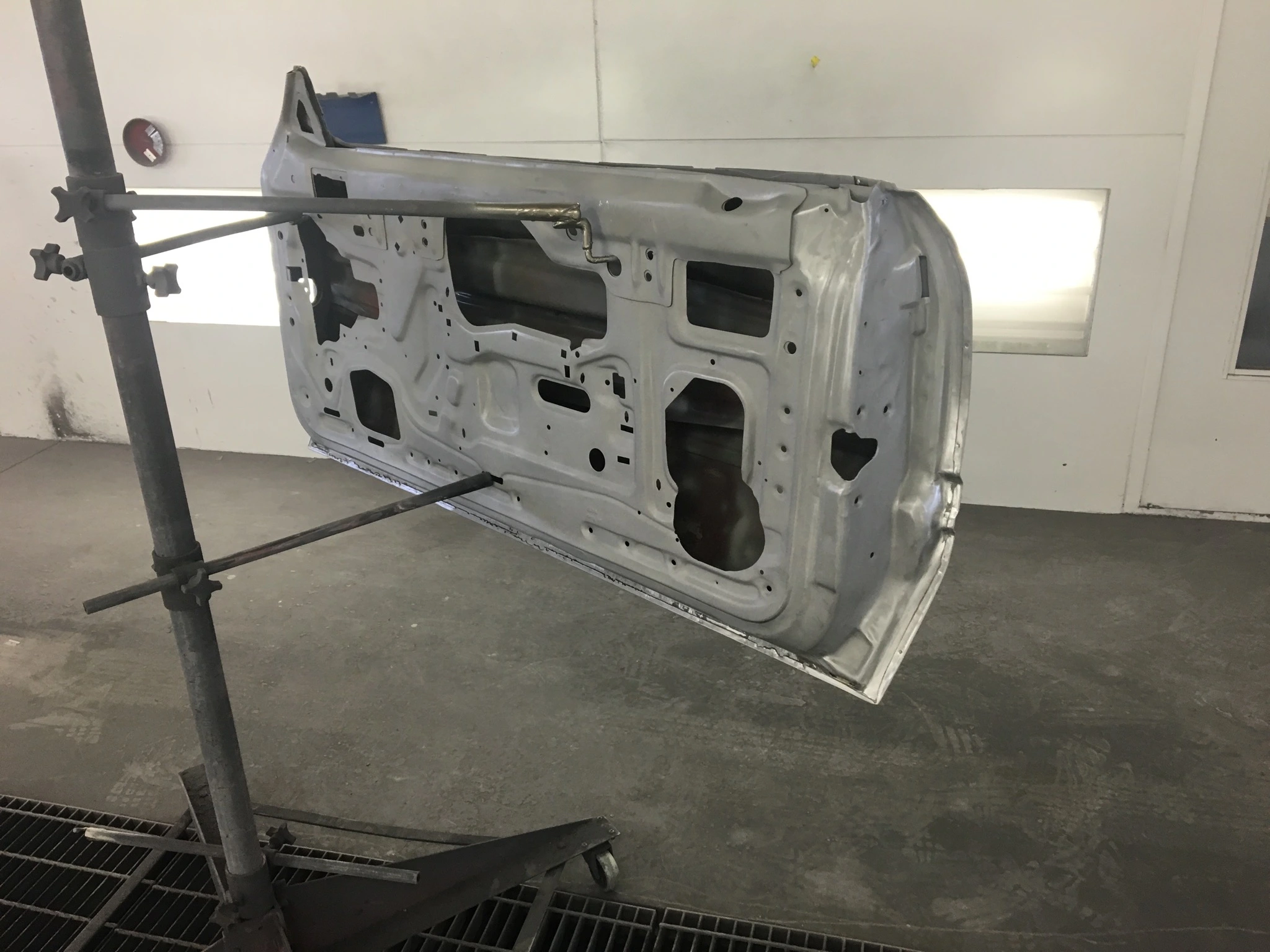

I have been posting in my regular thread about my blue car and the work I've been doing to it.
If y'all are crazy enough to do what I'm doing, I'll help you out. Here are the pictures of just my door from getting it to completion. I won't have too much of a running commentary with it. Just ask me any questions you might have about whatever step. The only caveat to that is I tore the door down and that I welded up the holes along top of the door because this is a door off of a convertible and they have different trim than a t-top.

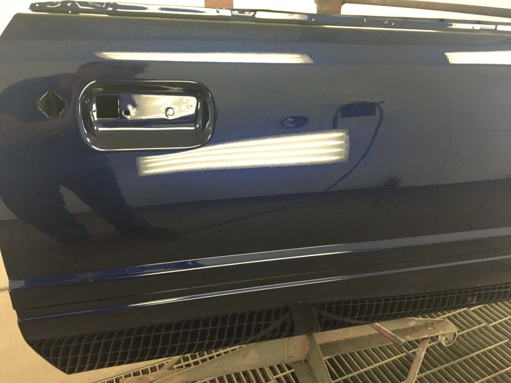

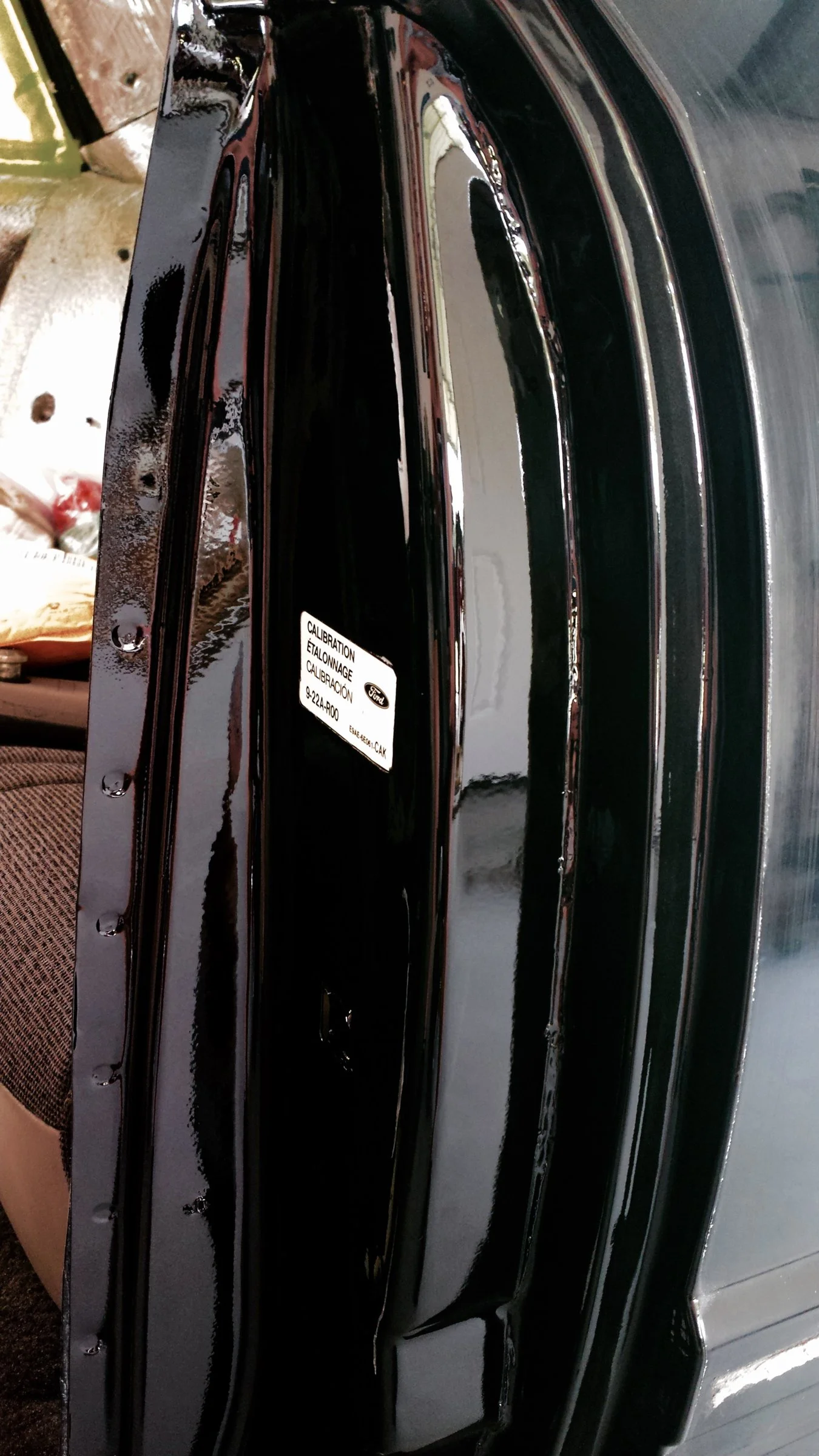

View attachment 566281 View attachment 566280 Hey all, thought I'd share a couple of pictures of the doors, trunk lid, and jambs, I painted Sunday and cleared on Monday. Turned out pretty nice.
Looks nice man, good job.
