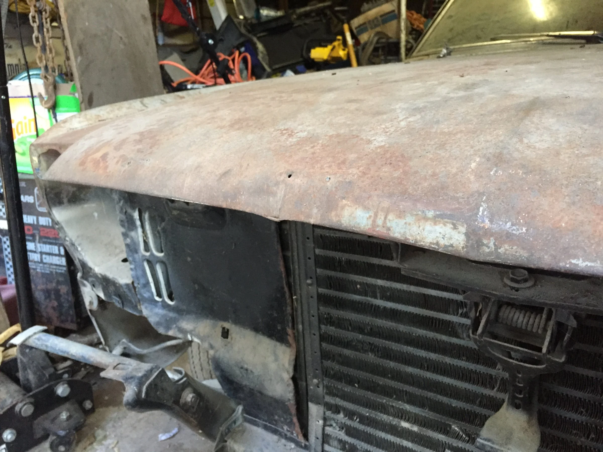

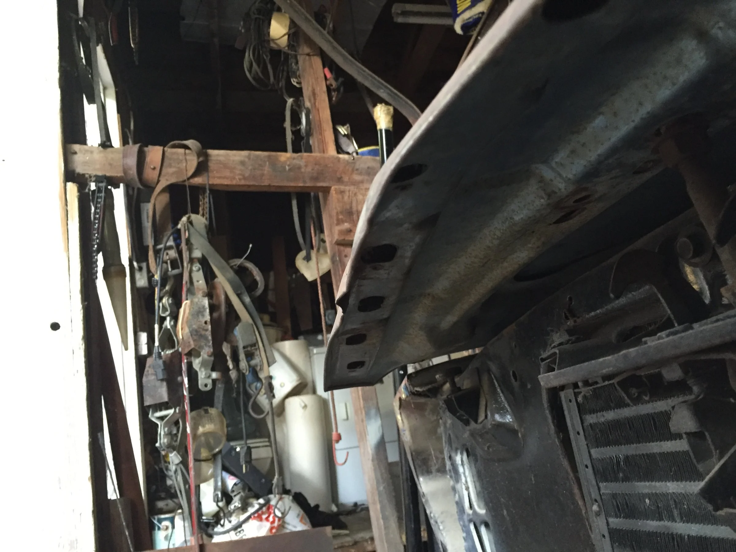

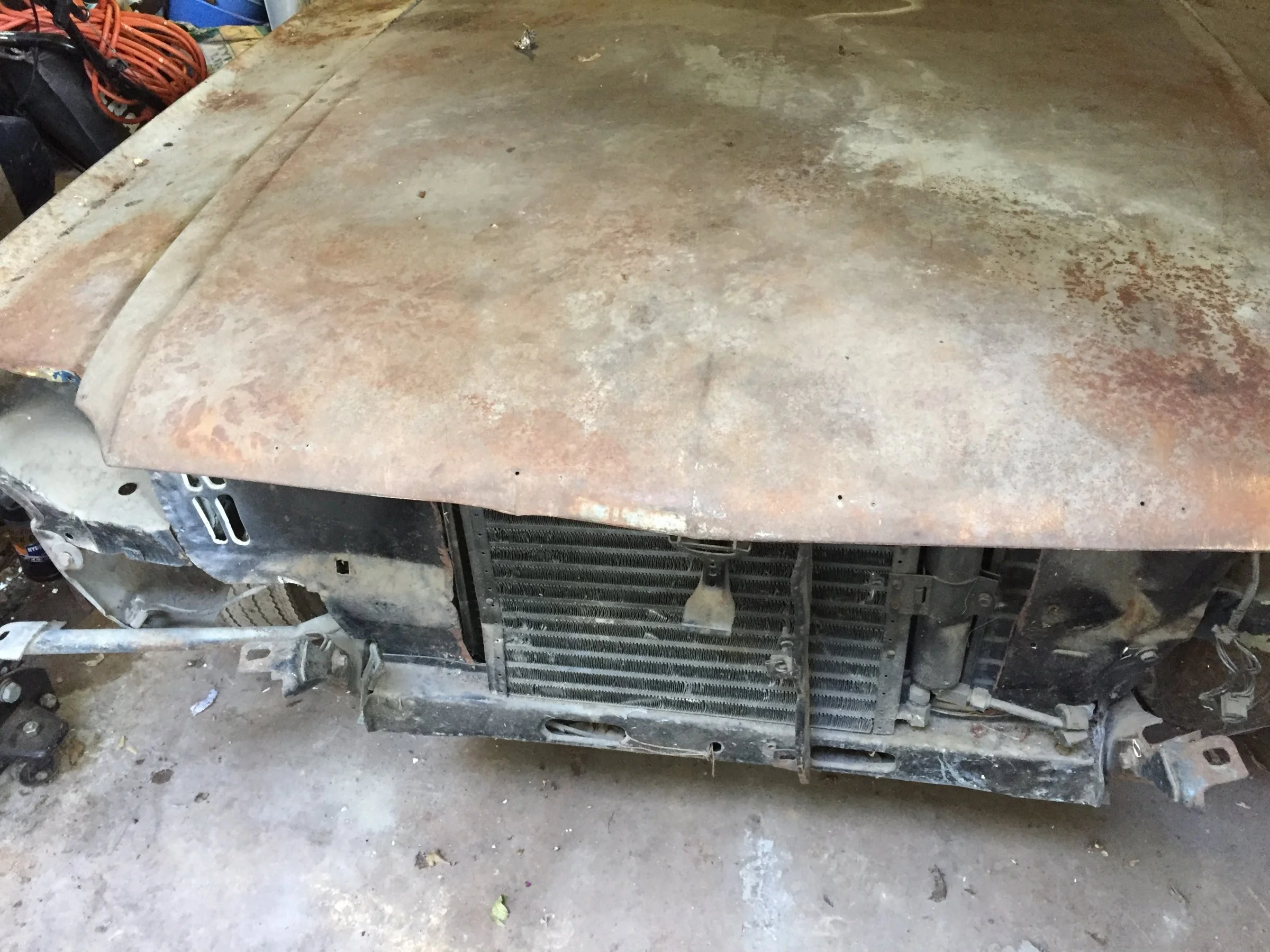

I have a '66 Mustang coupe I'm getting from my in-laws. It's been tucked away in a garage buried in junk for the last thirty years. We finally got it out yesterday and there are some body issues that are already evident. I plan to have it blasted, at which time I'm sure there will be a few more surprises.
Until then, one of the obvious problems is the hood. How would you go about fixing this? The front lip of the hood is bent downward.

Aftermarket hoods are cheap. Then ones I've used restoring classic mustangs have been fairly nice too.
If you don't want to go that route, beat it out for the bodyline on the edge of the hood to be "right". Then work on pulling out the dent or pushing in high spots. Mud a little, primer, block and live happily ever after....

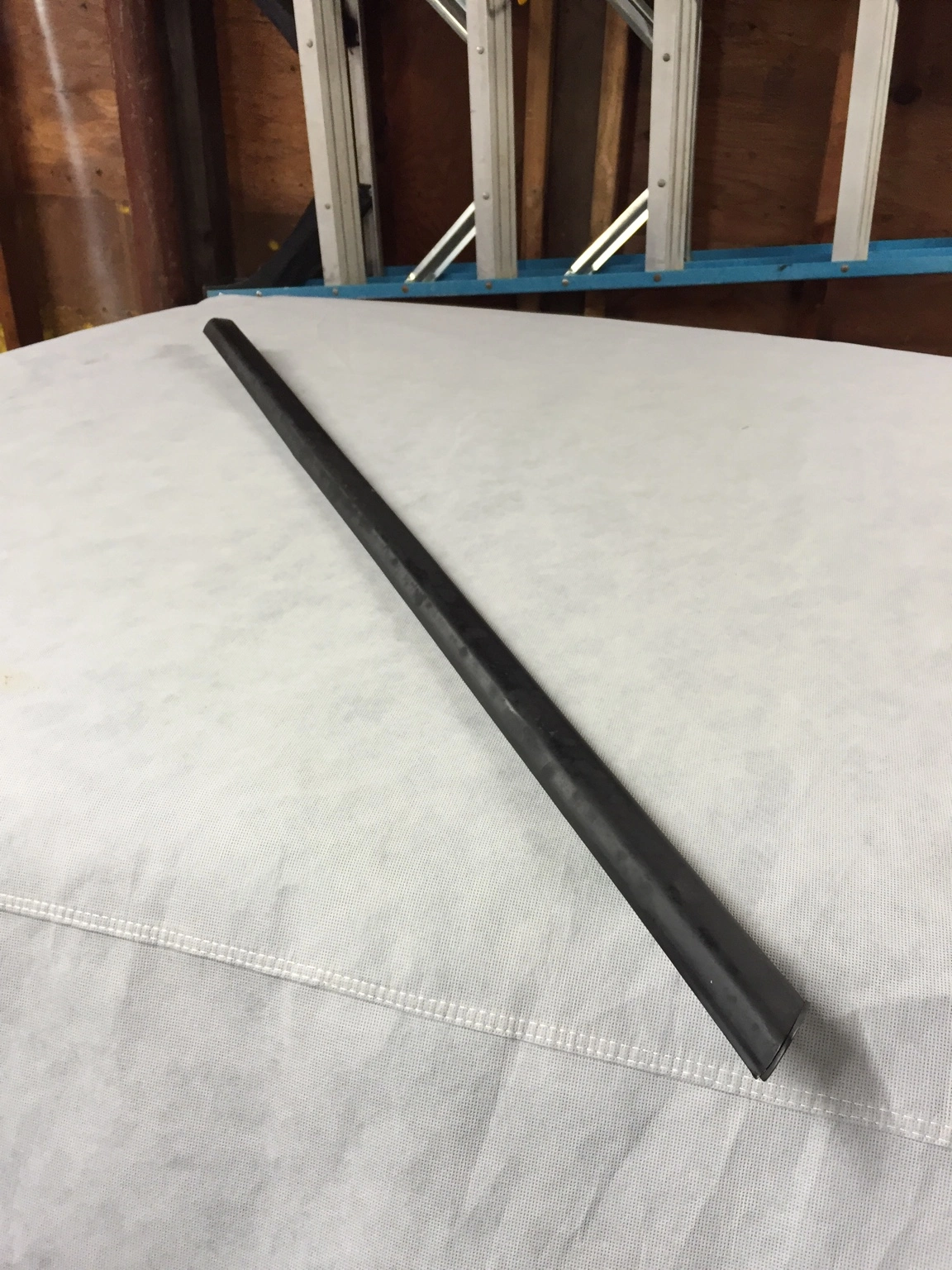

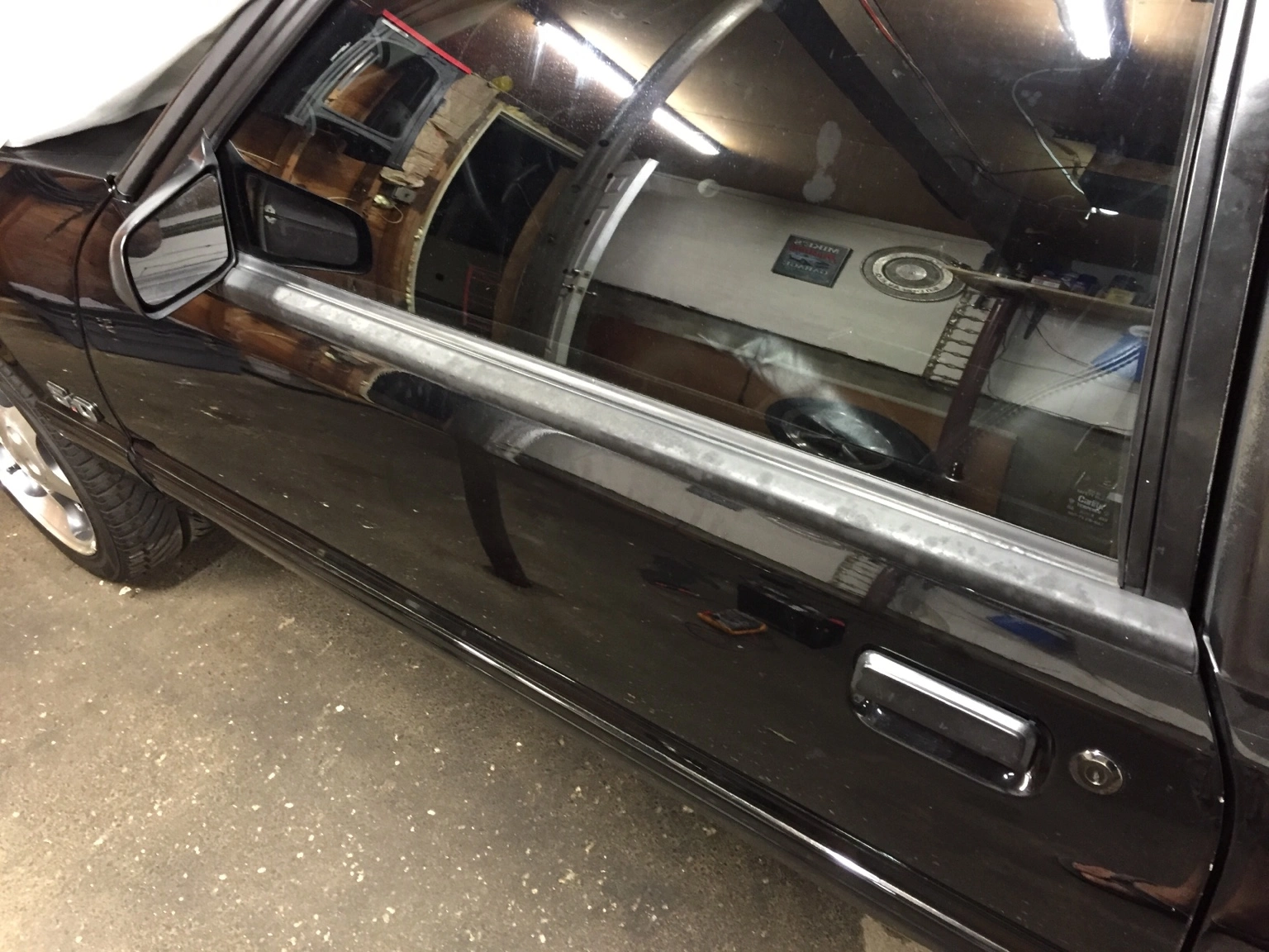

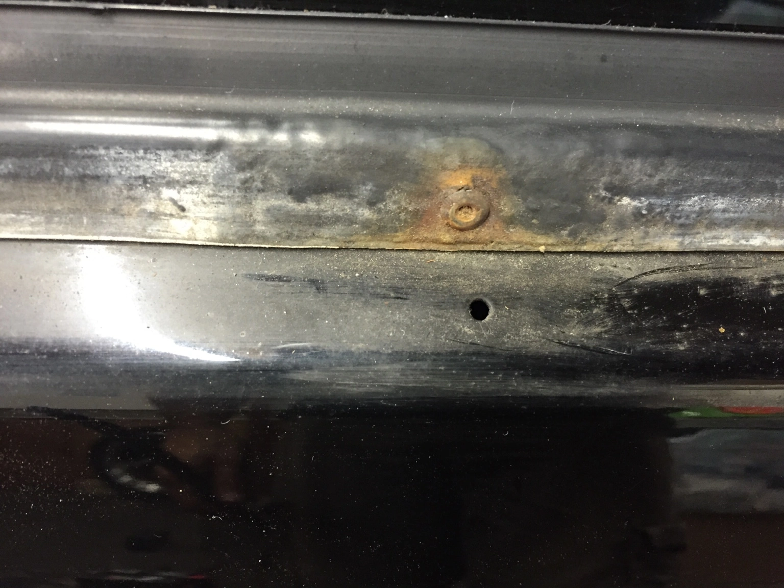

Dave, how does this trim piece come off? I need to redo it in trim black
Sent from my big ass iPhone 6 using Tapatalk
I'm not Dave, but I know how to take that off. There's a screw at the end of the door (handle end), open the door and look for it, remove the screw and slide the trim towards the rear of the car. It'll come right off. You have a sharp looking car !!
Hmm, aparentky one of the pins that holds the trim on is MIA. Are these available? How would I install?
Dew wipe could prob use some replacement as well . Starting to bubble right there
I need to go order 2-3 cans of SEM trim black now

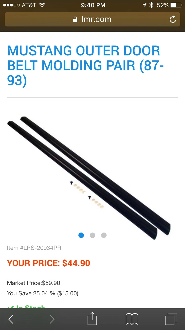

Aparentky LRS has new belt molding and retainers for pretty cheap.
Now debating if I should go with the repros, or keep my originals
