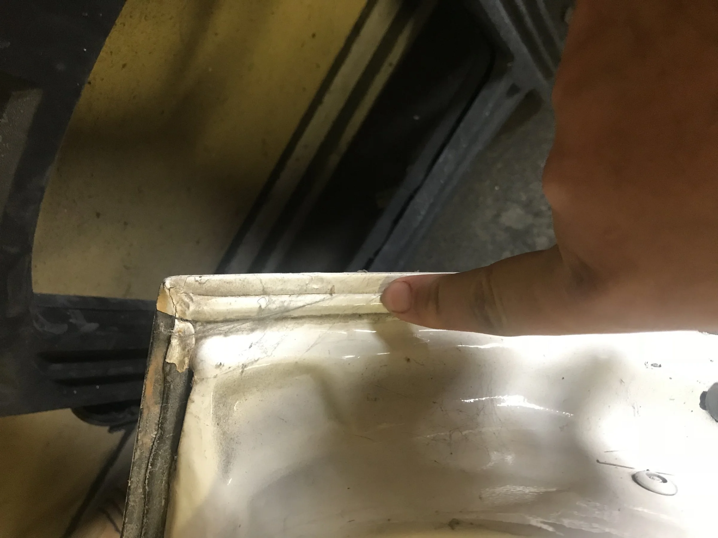

Hey Dave, a couple questions. I’m starting on my doors. In the jamb there is a strip of “ I dunno what” that’s chipped up , same thing on my hatch. What is it and how do I replace it? Pic below. My guess is seam sealer. While I’m working on it, how would I check to make sure the door drains properly? Or is drilling a hole a bad idea?

Yeah Bill, that’s seam sealer. I use a wire brush on a drill to take the old stuff of my panels. You’ll find that in areas under the hood as well.
You’ll want a good two part “epoxy” style seam sealer to replace it with. Flowable seam sealer is the best to use, but it’s a pita when doing the curved areas of the door, it flows back along the curved sections and wants to
puddle in the center area. I used a heavy body seam sealer on the doors for that reason. It takes a little more work to make it lay out nice.

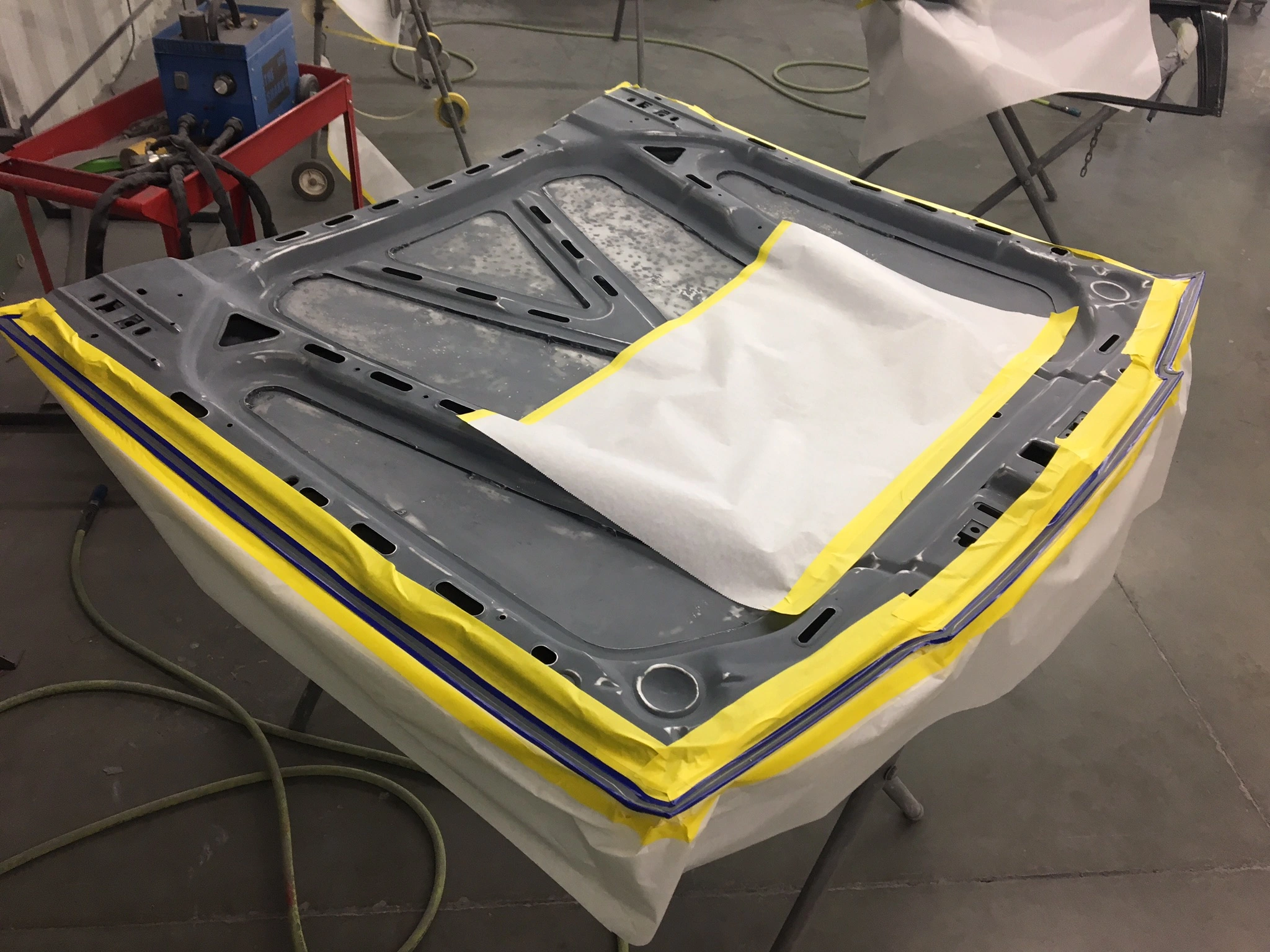

Here’s a picture of my hood when I masked it to seam seal. I’ll come up with a couple more pictures in just a little bit.
The seam sealer helps, believe it or not, to prevent rust along the entire edge. It causes moisture to be directed towards the weep holes.

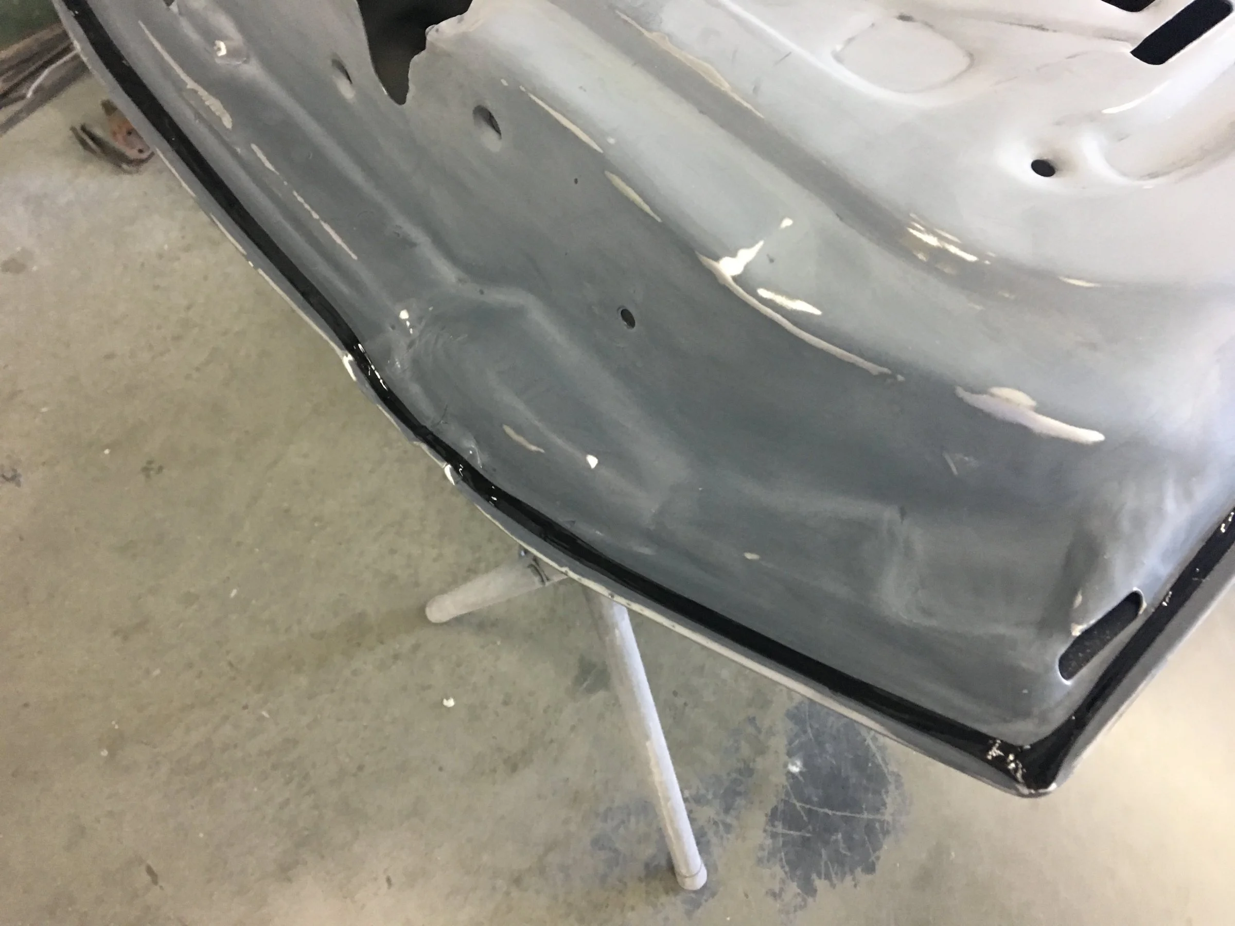

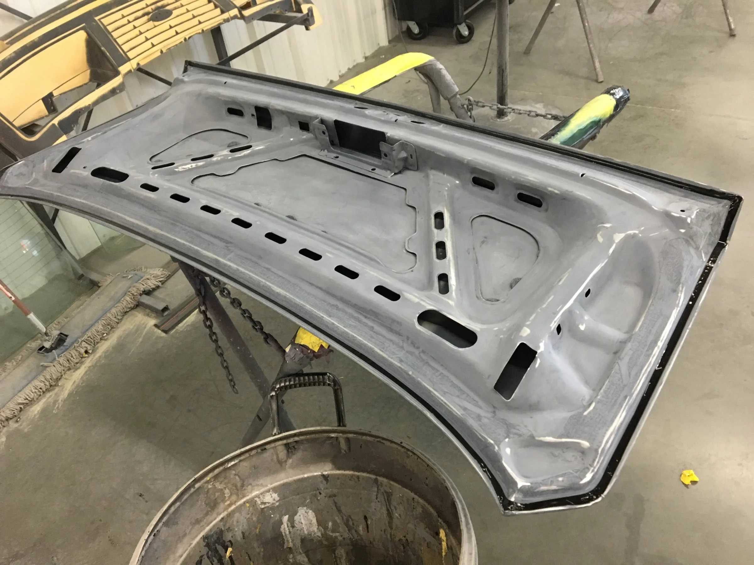

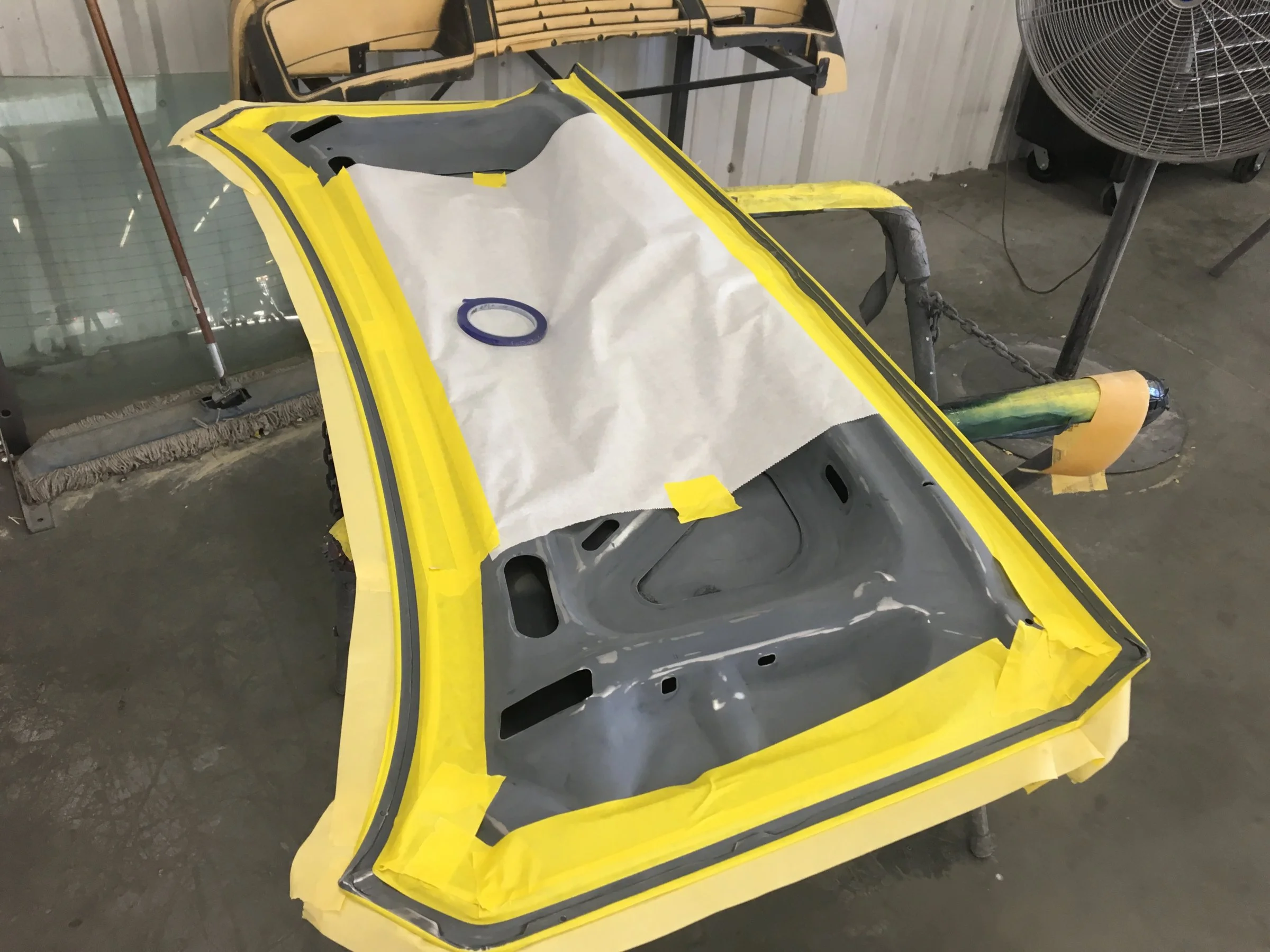

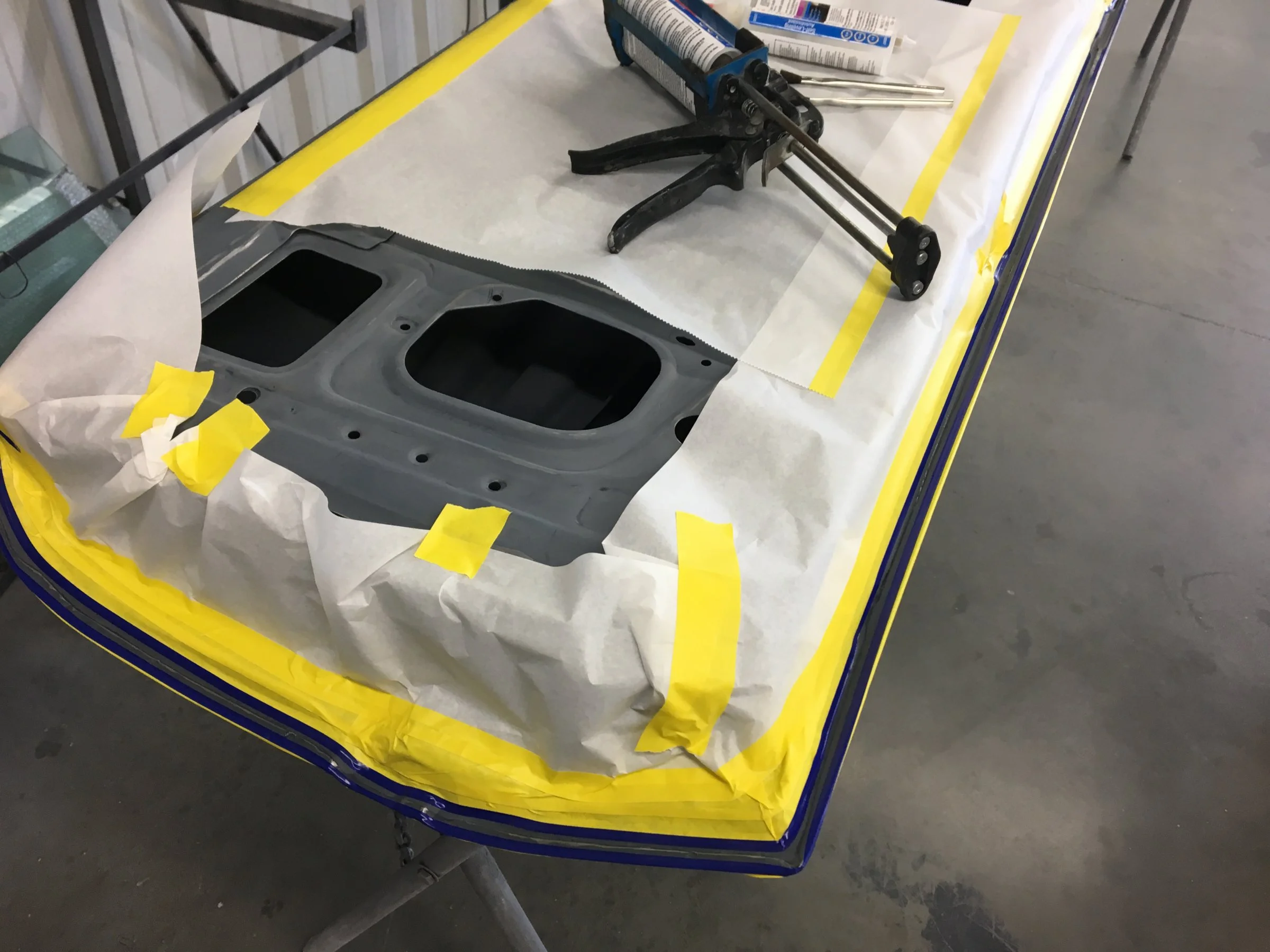

I'm running out of battery, so here's a few more pictures of prep for seam sealing. You'll want to be able to remove the guide tape just shortly after getting the seam sealer on the panel so it can flow out on the sides. Wait until the ss starts to harden, it'll only be three or four minutes, then pull the tape. In the end you can smooth it with sandpaper after it hardens though.
