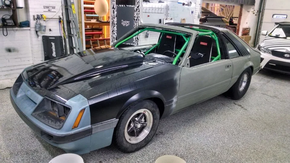

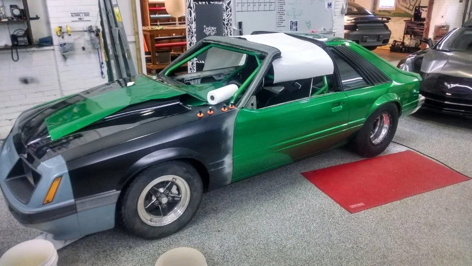

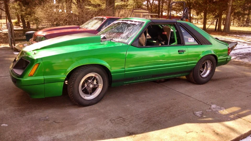

@Davedacarpainter Thanks for the kind words! I will interject that while a vinyl wrap will cover the car in color it is not a cure all for poor body work. You will see every small imperfection under the wrap in great detail, most people expect the vinyl to cure all and I can assure you that is not the case!
Pictures for reference:
Before- (it was raining when I dropped the car off )
During-
After-
