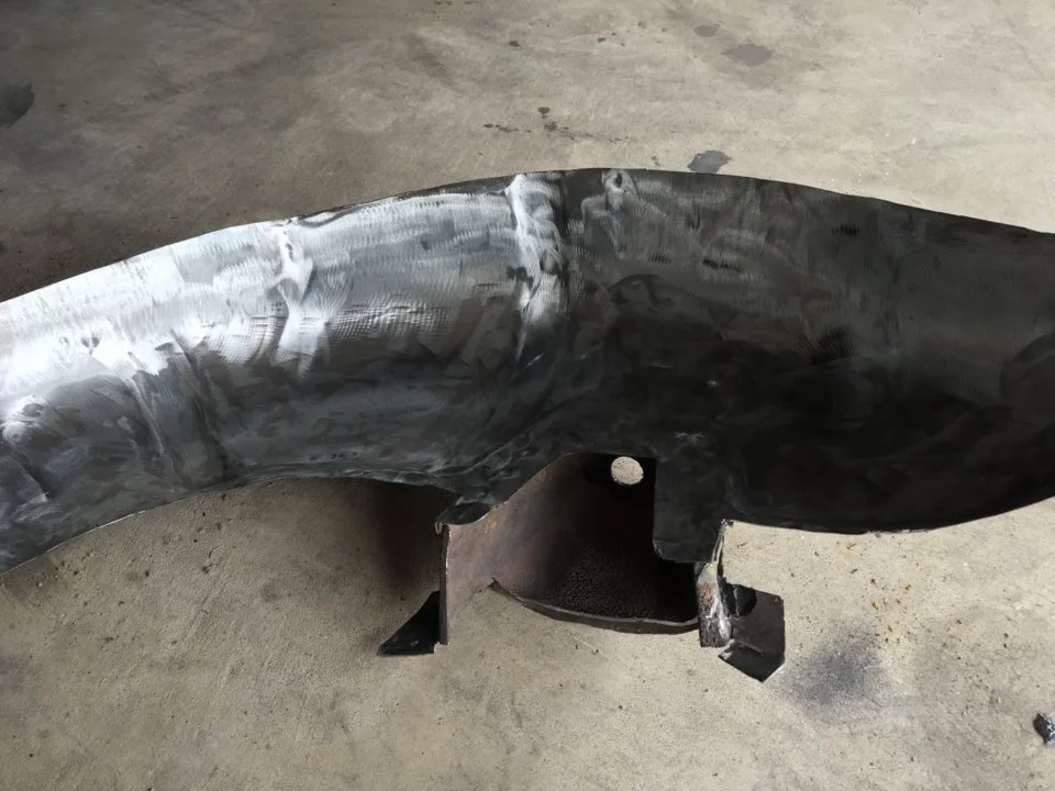

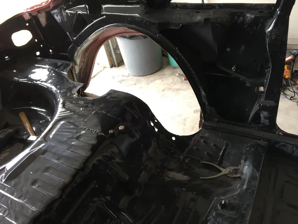

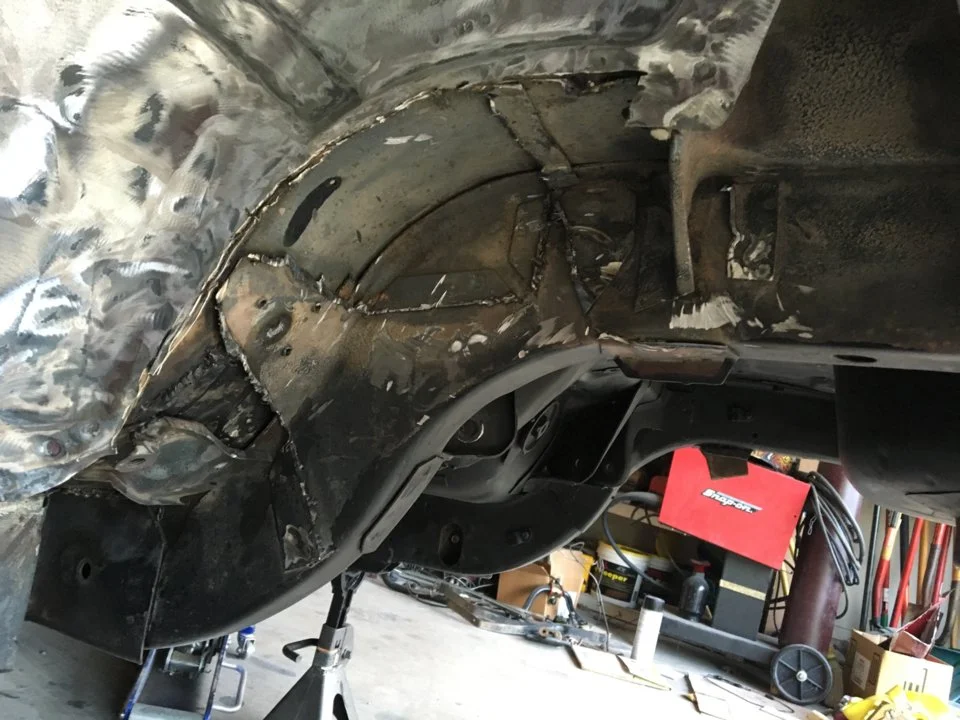

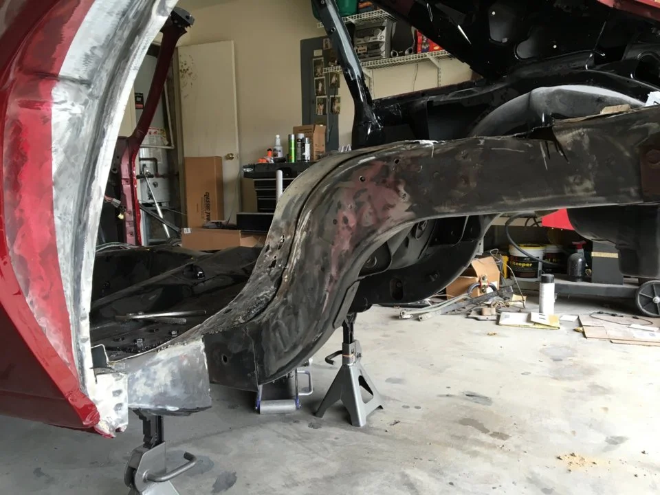

So, today I cleaned the frame of all brackets. Then I proceeded to marking the wheel tubs with a crayon and a ruler to be sure I cut fairly straight. I initially cut along the lines in various places with a die grinder to have openings for the jig saw to get in.
I could have just cut the whole thing out with the die grinders, but the jig saw is quieter and doesn't shower you with sparks!
After cutting out the inner tub, I cut the floor along the crayon lines I had made earlier to add the desired two inches of width.
While doing this, you will cut into the frame where the shock towers are. Don't sweat that if you will be notching the frame like I will be doing.
After I removed the inner tub I cleaned all of the edges of extra metal and ragged edges and went about fitting it.
Fitting it just means I placed the inner tub over the 2" cut out I did on the floor to match them up in preparation for welding. I trimmed where necessary to finish the fit.
I left the shock tower attached to the inner tub. The shock towers have brackets that weld to the frame. I did not cut these off earlier when I cut off the rest of the brackets, I just used the 1/2" belt sander to grind out the factory spot welds. I trimmed two inches off these brackets so they will fit with this procedure. I had to bend the brackets back out again to have the area I will weld to the frame when I get to that stage.

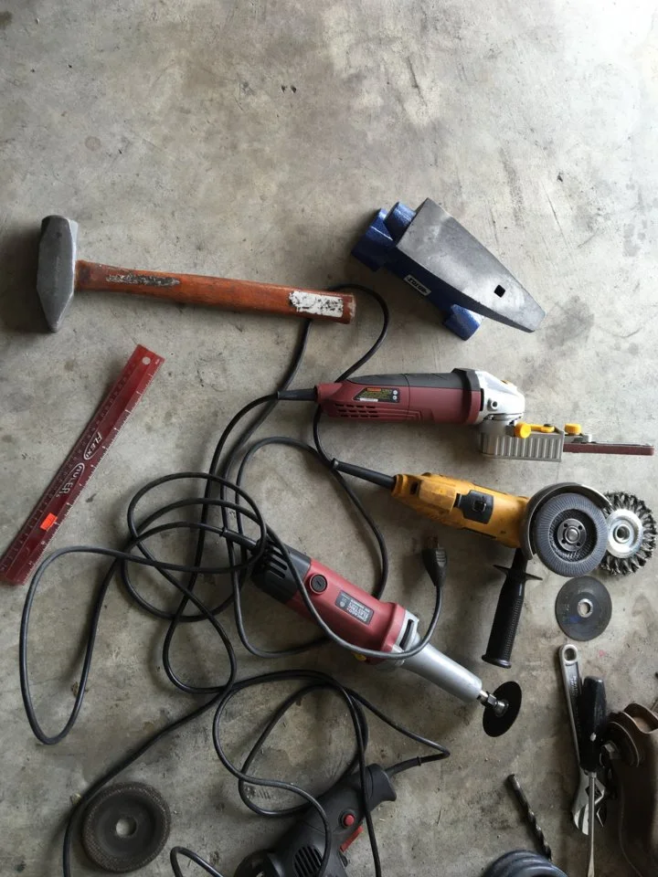

Tools I used: 4.5" grinder with cut off wheels and knotted wire wheel, 1/2" belt sander for cutting off the factory spot welds, electric die grinder with 2" cut off wheels for the tighter areas, jigsaw with blades for cutting metal, BFH, My daughter's crayons to draw lines for the cut off wheels and jigsaw. And a RULER! Must have item there, don't even try to guess on this.
Tomorrow, I will be notching the frame and taking 2" off of the seat belt bracket and then....I weld it all back together with my home made frame notch kit and 2.5" strips of metal!
I should be pretty close to have the driver's side done tomorrow and the other side done by the end of the day next Saturday.
I'll go on to the modifications I will be doing to the differential to accommodate the coil overs immediately after this is complete.
I will take more "in process" pictures when I do the right side. This was a moderate learning experience for me, I watched others do it on their threads, but actually doing it is always different than watching someone else doing it. Hopefully I'll post enough info for you to not be overly intimidated in trying this yourself.
Remember! Harbor Freight is your friend.
