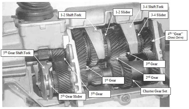

The cluster gear transmits power in every gear except 4th. You may have a problem in that area.
Diagrams courtesy of Tmoss & Stang&2birds
T5 Cutaway showing T5 internal parts
http://www.veryuseful.com/mustang/tech/engine/images/5_Speed_Cutaway_Illustrated.jpg

There's no sleeve that locks the two shafts together for direct drive, and even though it's a 1:1 ratio, the cluster still transmits power from the input shaft to the output shaft in 4th gear. However, since that's the only gear where the input and output turn together at the same speed, and that's the only gear there isn't any noise, I suspect there's a problem with the pocket bearing where the two shafts meet, or, the snout of the input shaft is galled up and ruined which is not uncommon. They even make sleeves to repair them.
