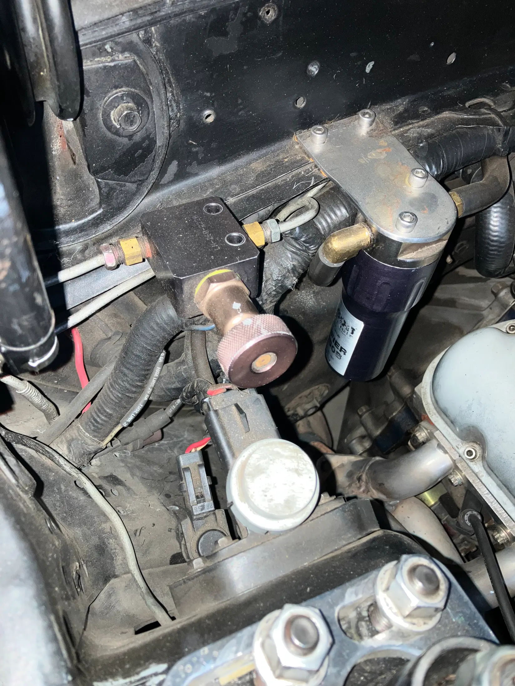

FYI--The adjustable proportional valve can be located where the stock proportional valve was at. Looks cleaner IMO. Only 1 adapter is needed for the top fitting, the stock lines will thread right into the bottom and rear of the valve.
For now the prop. Adj. valve will stay where it is now, it is kind of easy to access it to make adjustments for bleeding. Just will delete the stock proportioning valve and leave just the hard lines tucked against the strut tower, it will look clean and maybe latter I will install a lock-line solenoid

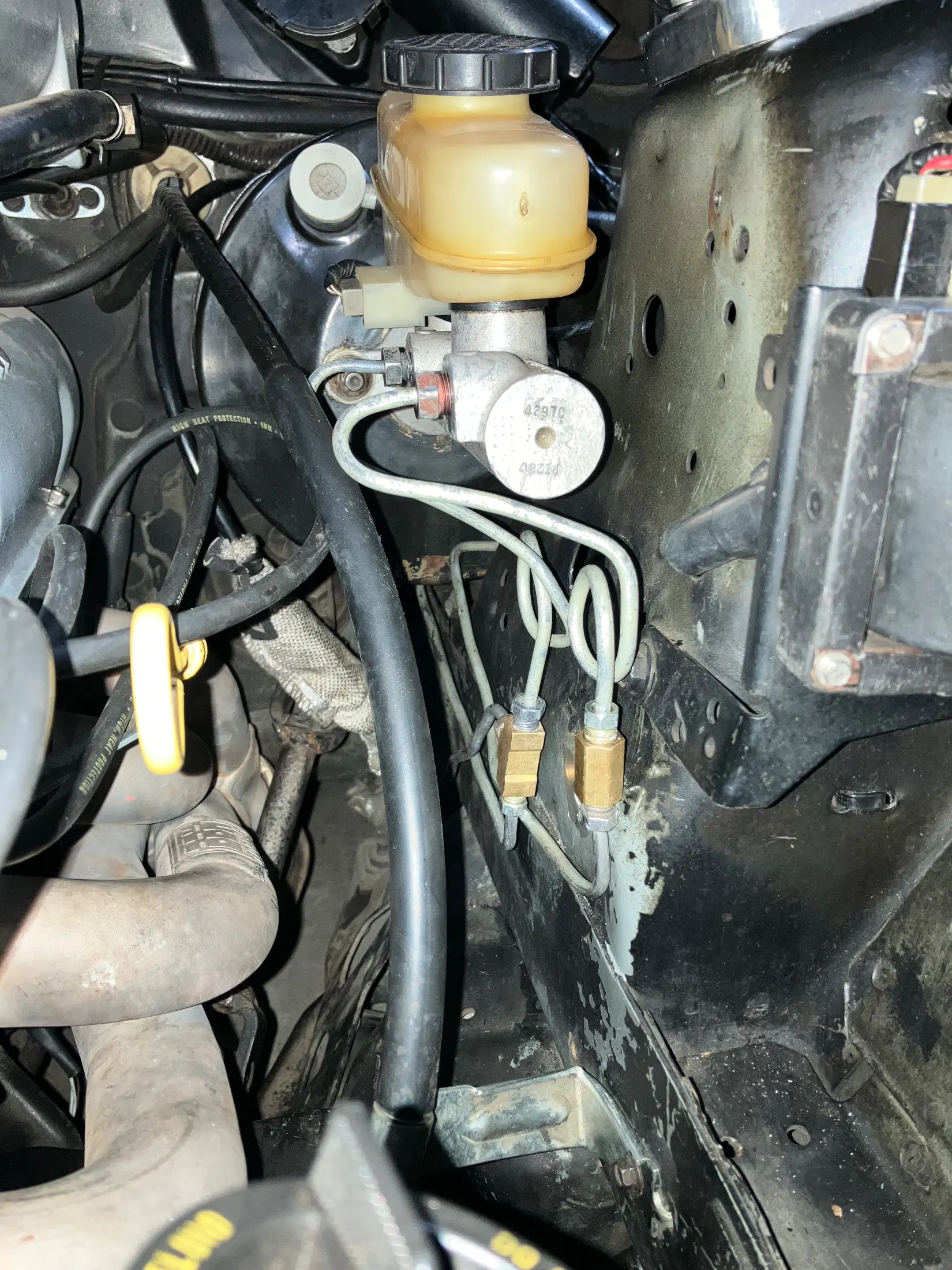

By the way I will customize the hard brake lines under the master cylinder replacing the mixed size brake line nuts for one size only. It will look simpler and cleaner

Deleted the stock proportioning valve, with all one size custom brake lines nuts, dumped all the synthetic DOT4 from the master cylinder replacing it with fresh synthetic DOT3 and did a complete bench bleeding, reinstalled the master cylinder, fully opened the Willwood adjustable proportioning valve (Knob all the way in) and started bleeding the system the order I always do; Rear Right / Rear Left / Front Right / front Left.
Purposely Ileft the Willwood adjustable proportioning valve fully opened and went out for a test drive.
