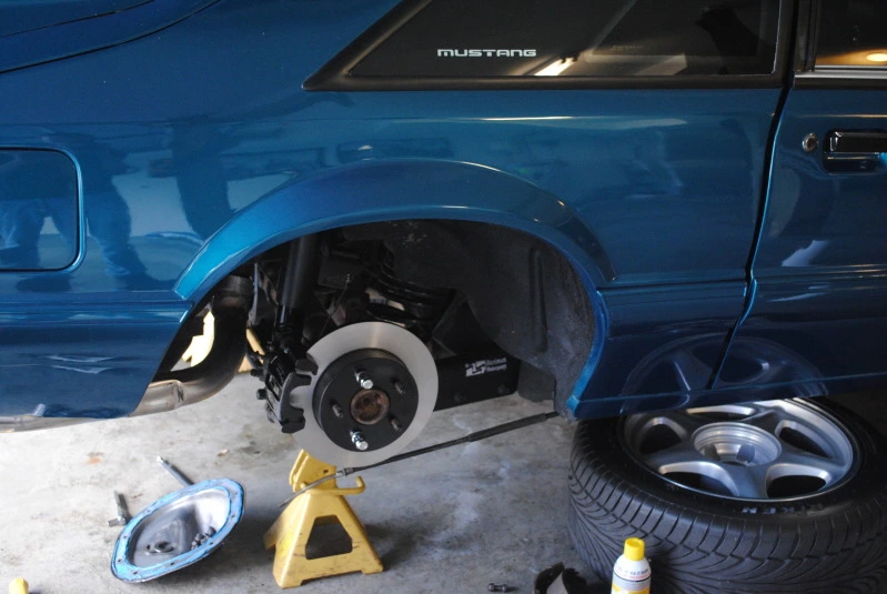

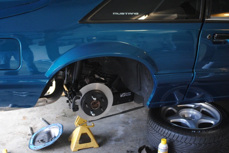

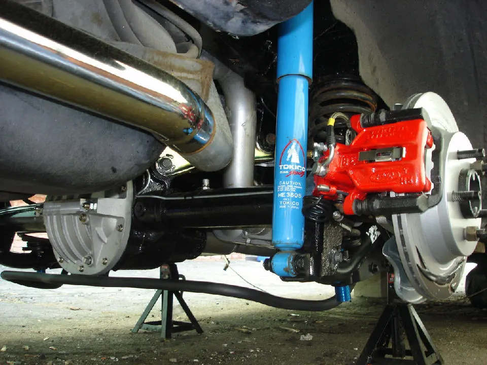

I'm in the middle of doing this conversion on my car, but I'm using my existing Fox housing with Ranger axles. Does anyone have an idea on mounting the SN95 soft line brackets?
Purchase 94-95 Mustang rear soft lines. They bolt to the axle housing. 96-later lines bolt to the body, so you don't want those.
I think the lines are $10-20 each from an autoparts store. I sprung for the MM stainless lines on mine. Tough to see but the mount is right behind the shock
Thanks, Mike. I referenced the FRPP 2300K instructions; I removed the lower shock bolt, moved the shock out of the way, drilled and tapped a hole, and installed the line. I already have my swap finished, I just need to bleed the fronts. I can't wait to try out the new brakes and a fresh Trac-Loc.

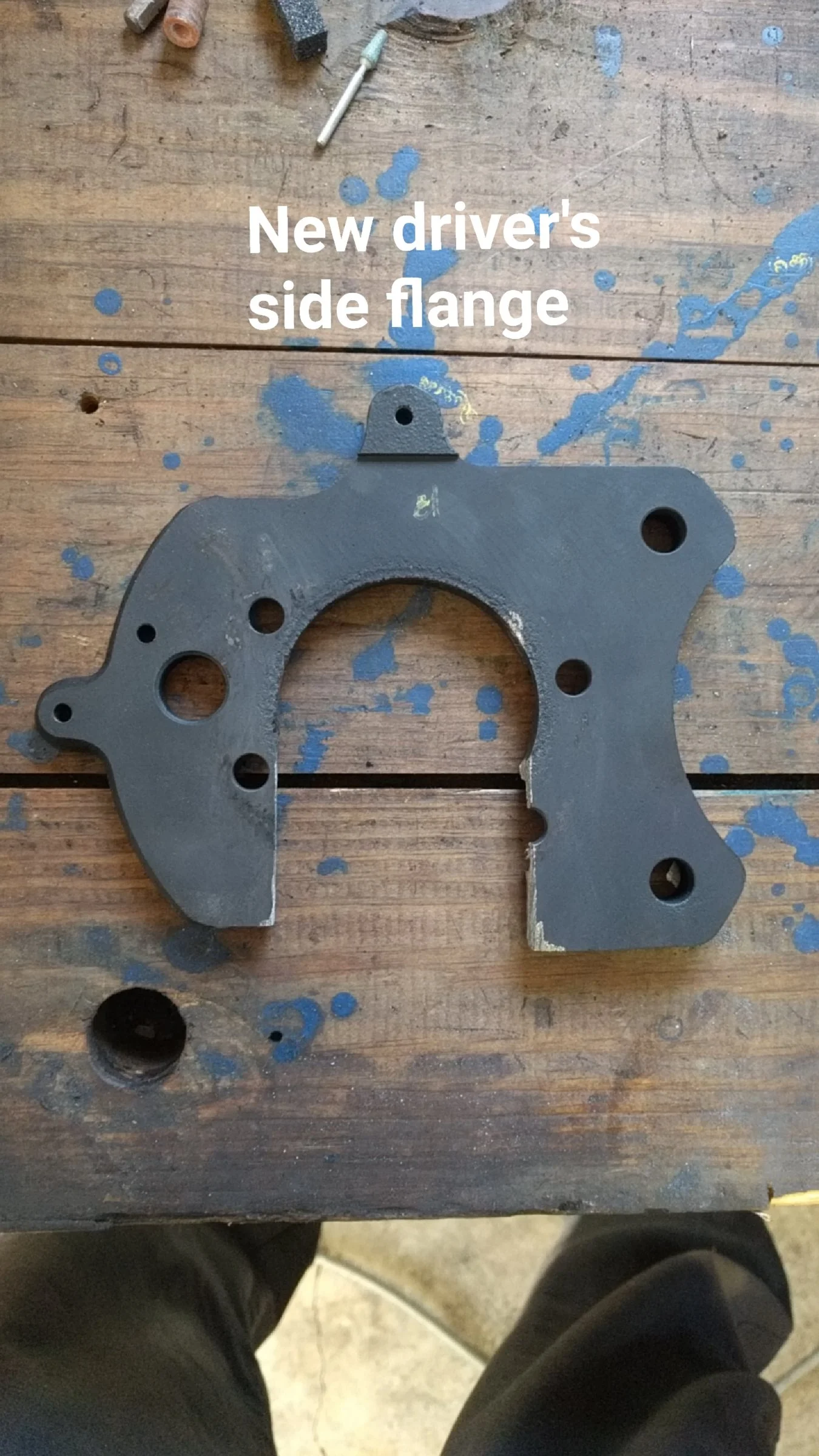

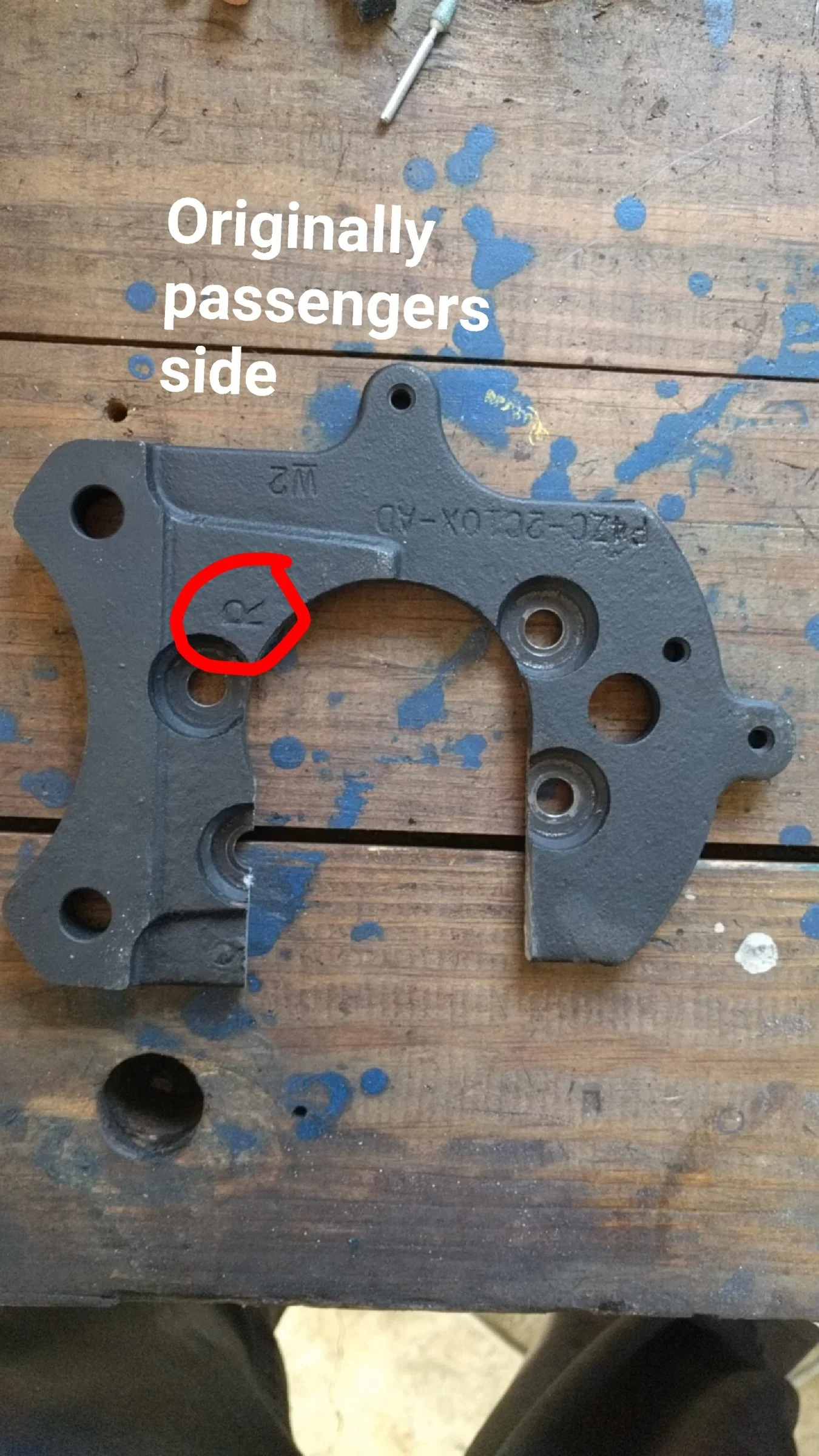

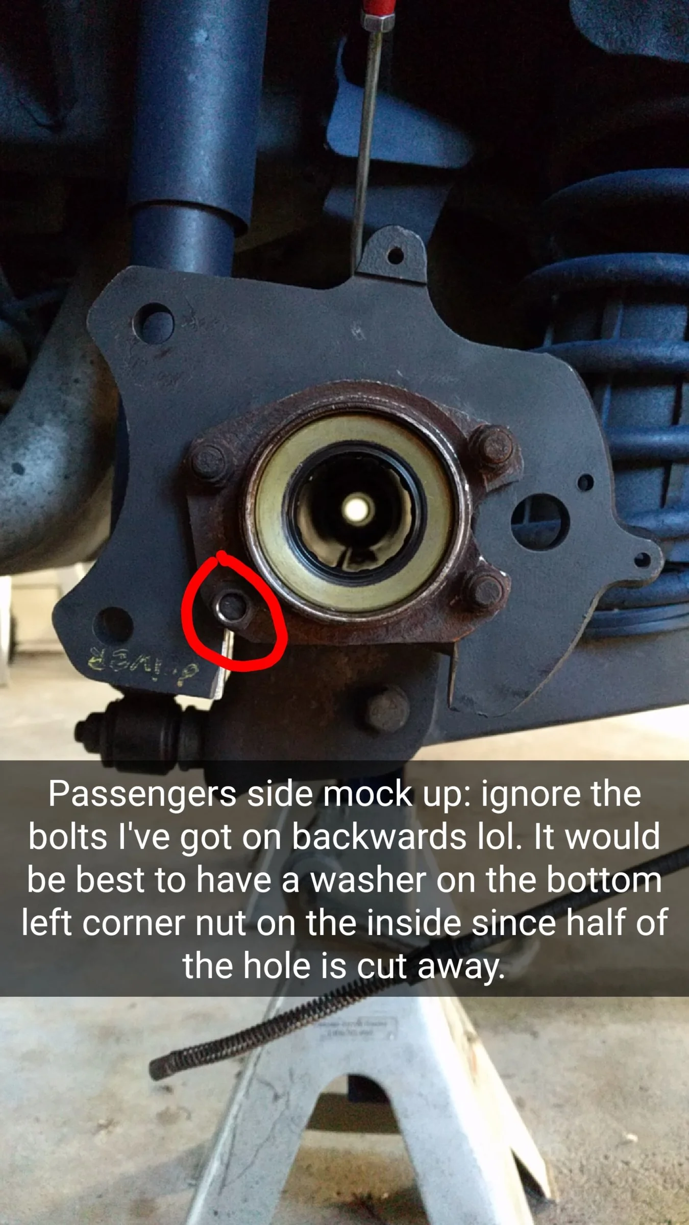

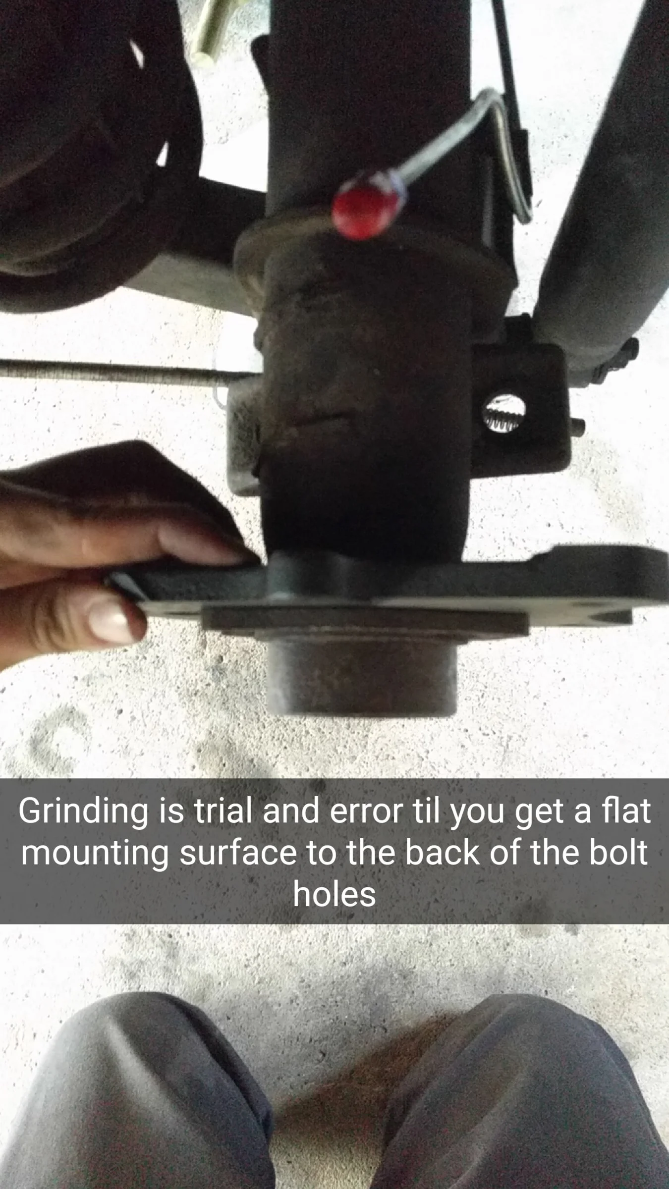

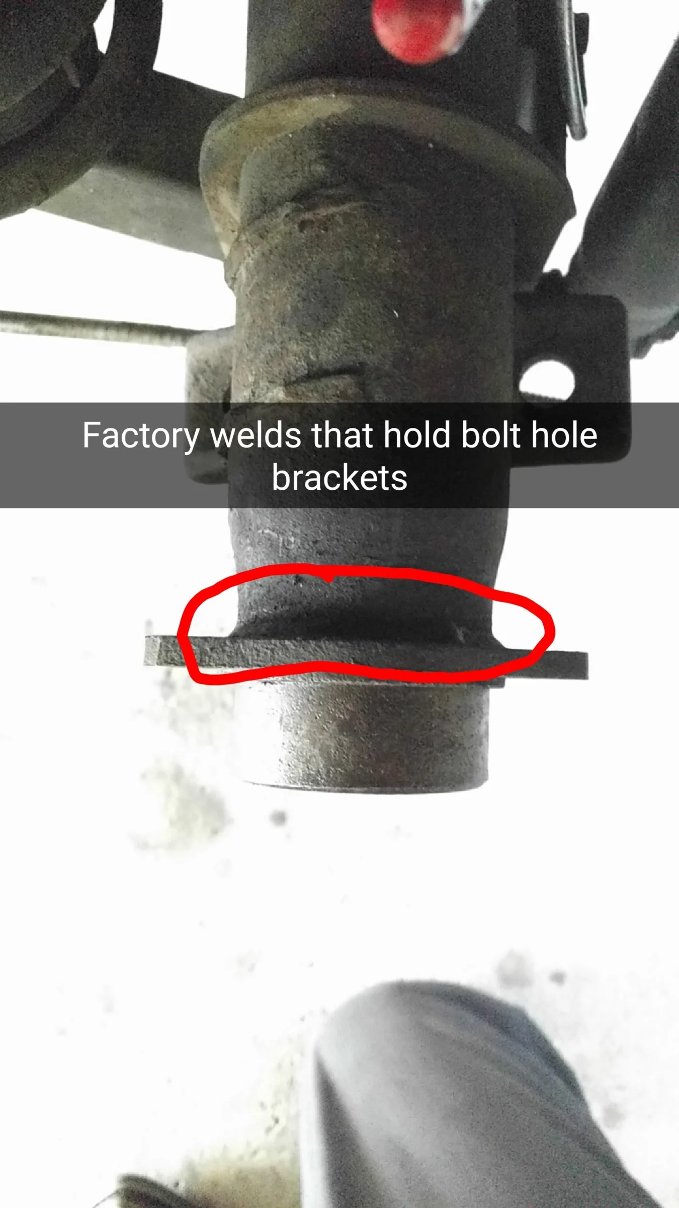

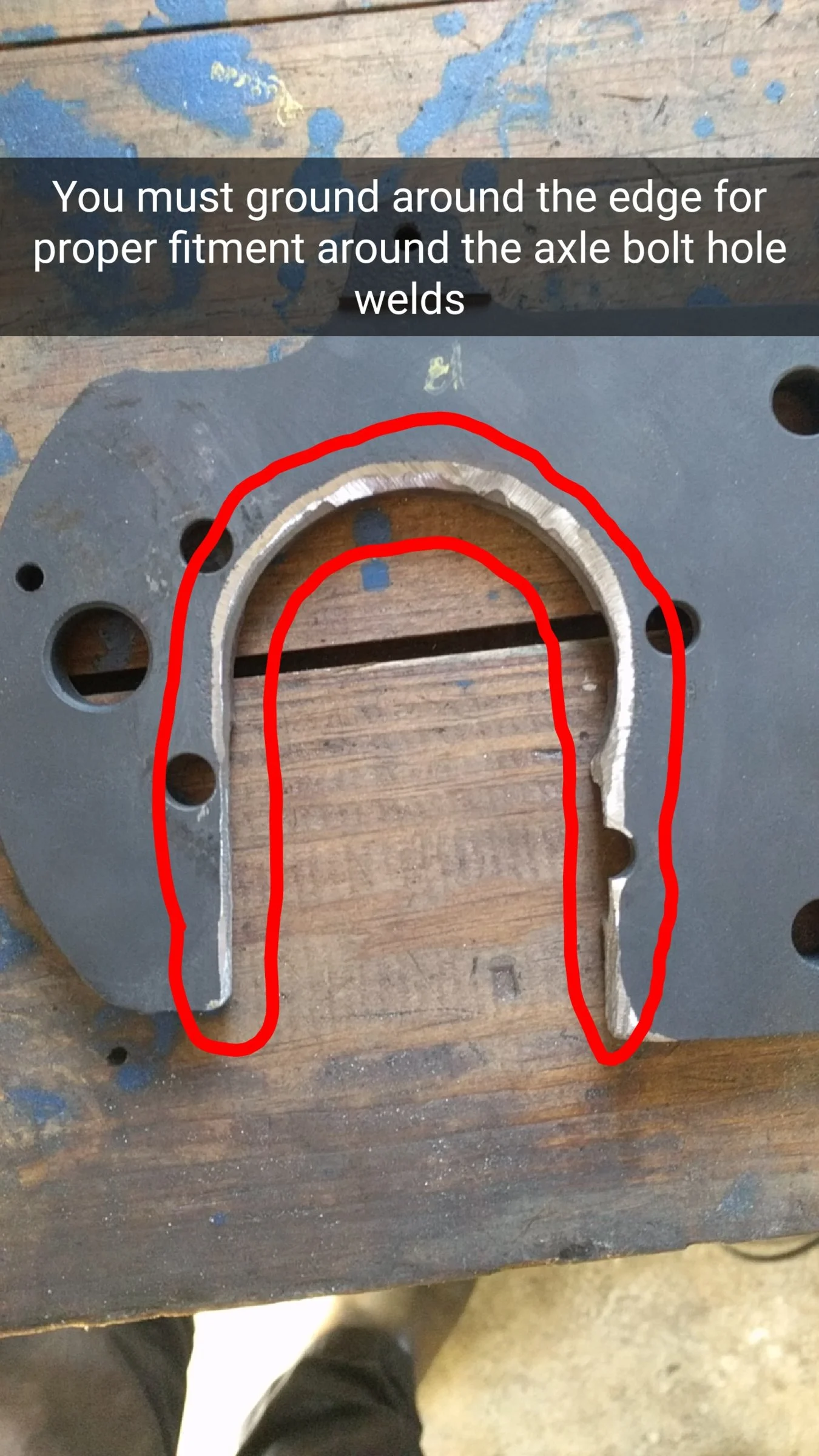

Okay so I made some progress on my own flanges this afternoon.
I cut away the "bottoms" of the flanges for the OEM left and right sides first.
When you do this,
Left side will now be right side mounted
Right side will now be left side mounted
Both should mount flat against the inside of the axle bolt holes.
You will more than likely have to grind a radius to the opening in order to clear the factory welds on the inside of the bolt holes where they are welded to the axle. You want to make sure that these are flush against the bolt hole plate.
On the flange plate, you'll probably want to use a washer for both of the bottom left corner bolts as you will cut away half of the original hole.
Hope this helps along with the OP.
