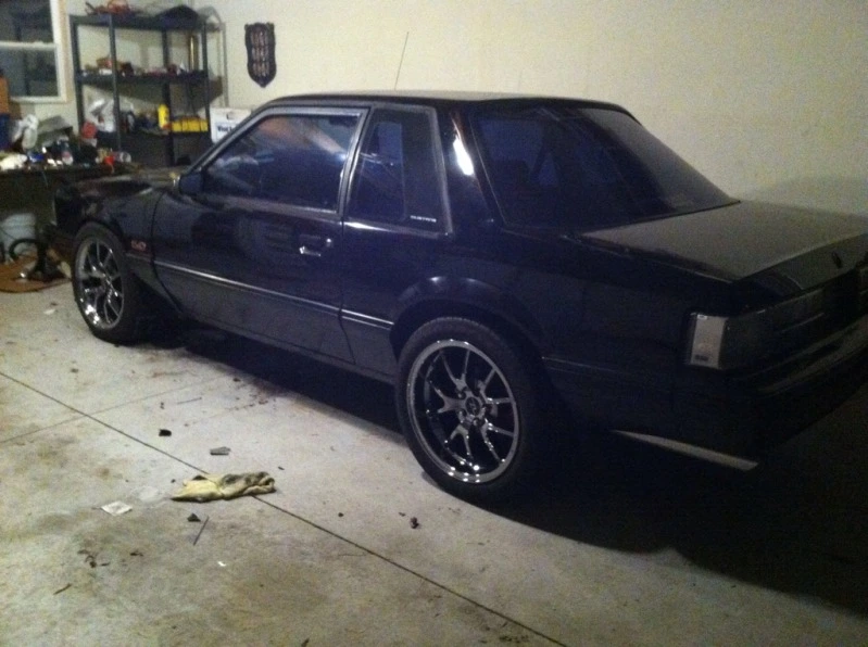

I have a set of 17x10 10th anniversary wheels that I need to get mounted on the car. The time has come to round up the necessary parts. The front end I have under control, the rear wheel wells have been rolled, and if necessary take the inner wells on a date with the ol bfh. However, which axle would be the best looking, and/or functioning fit? I do not want to do this twice. Back end is going rear disc as well. Anything else I may need to know? Thanks!

Someone will correct me if I am wrong, but I believe that those rims are designed for an SN95, therefore they will fit best with an SN95 rear axle and discs...
If you were to keep the rear at Fox width, those rims would have too much backspacing.

Most 10" wheels won't fit on a Fox with SN95 axles unless the BS/offset is DEEP. Since those wheels have a dish, i doubt they are.
That means you want fox lenght axles axles or the edge of the rim will hit the fender lips.

yeah most 18x10 and 17x10.5 need fox length axles and some will need a 1/4 inch to 1/2 inch spacer depending on wheel spacing.
roll the fenders, beat the inners.
to find the correct size spacer get a crapload (its a measuring term) of washers and stack them until its clears the inner and looks good on the outside.

you will need fox axles for 10 inch or bigger wheels, or with a sn95 rear end like i have go with s197 wheels, i had 9.5 inch wheels on my fox and they stuck out too far, now i have sn95 front rims and s197 rear rims

as long as you stay 9 inch or smaller and run a 275 or smaller tire you will be find with sn95 backspacing with sn95 rear end

IMO, always use fox axles, you can add spacers if necessary, if you use sn95 axles only way to take them in is different wheels.
