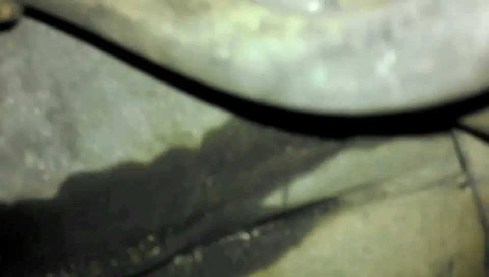

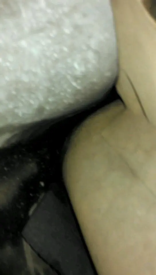

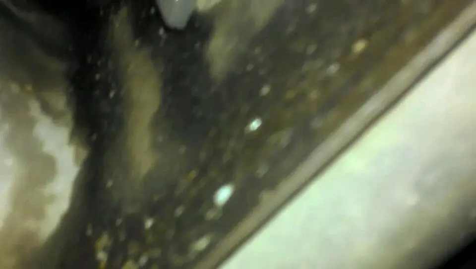

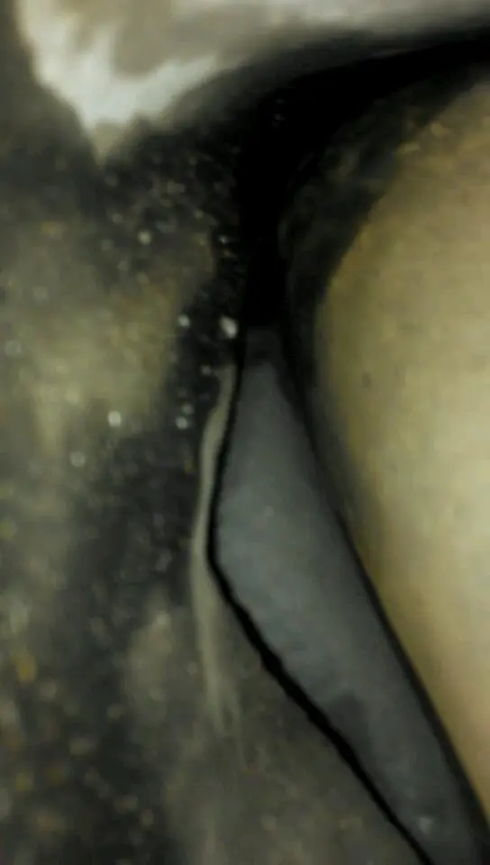

So I was able to get underneath and take some inspection pics, looks like it's leaking in the in the middle and moving down the valley toward the axle and turning right toward the right rear tire.
