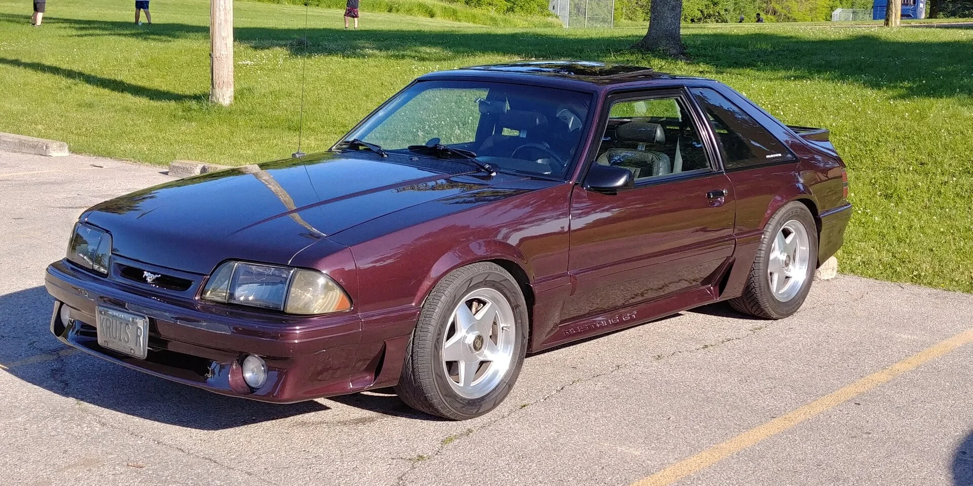

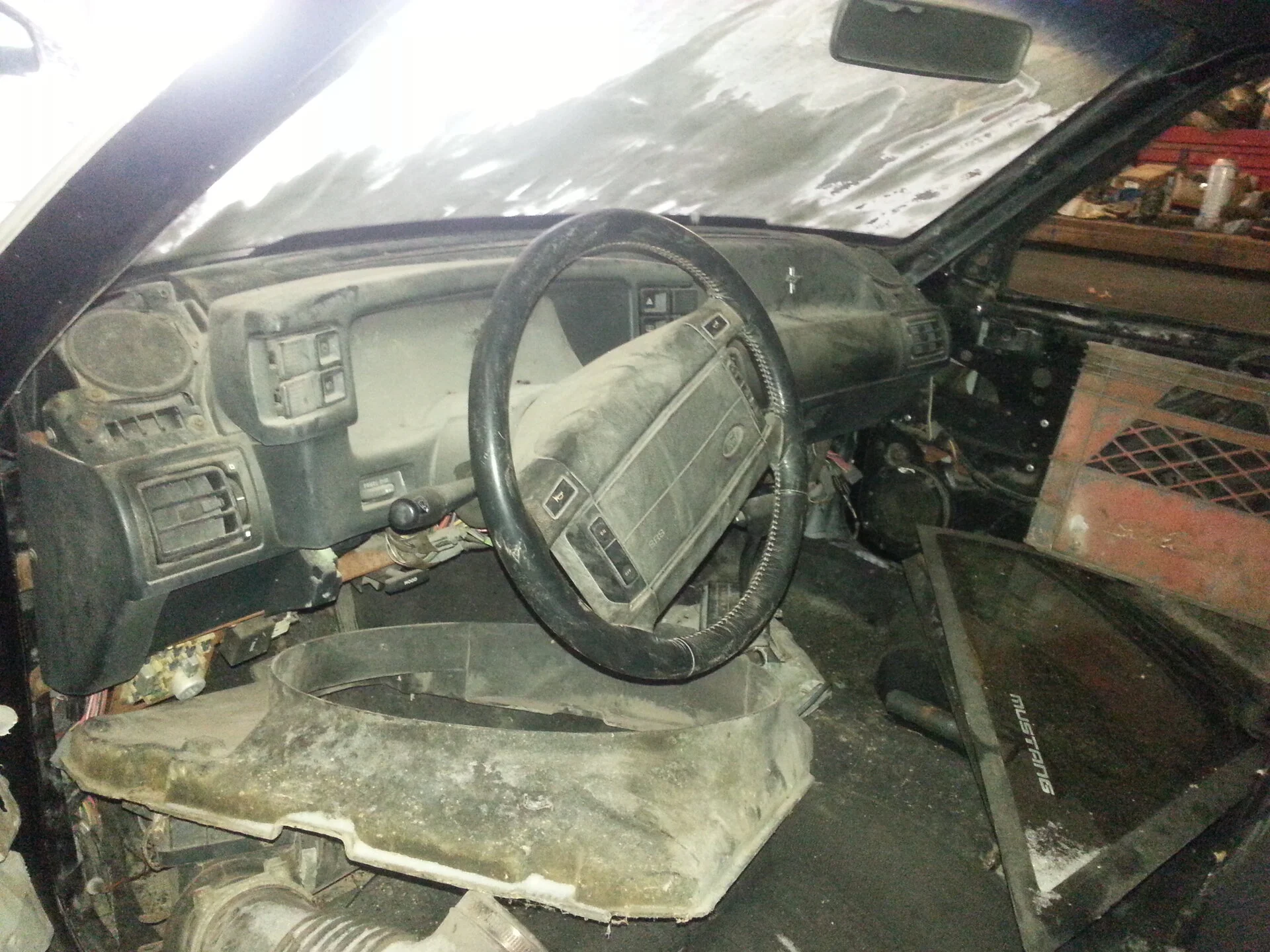

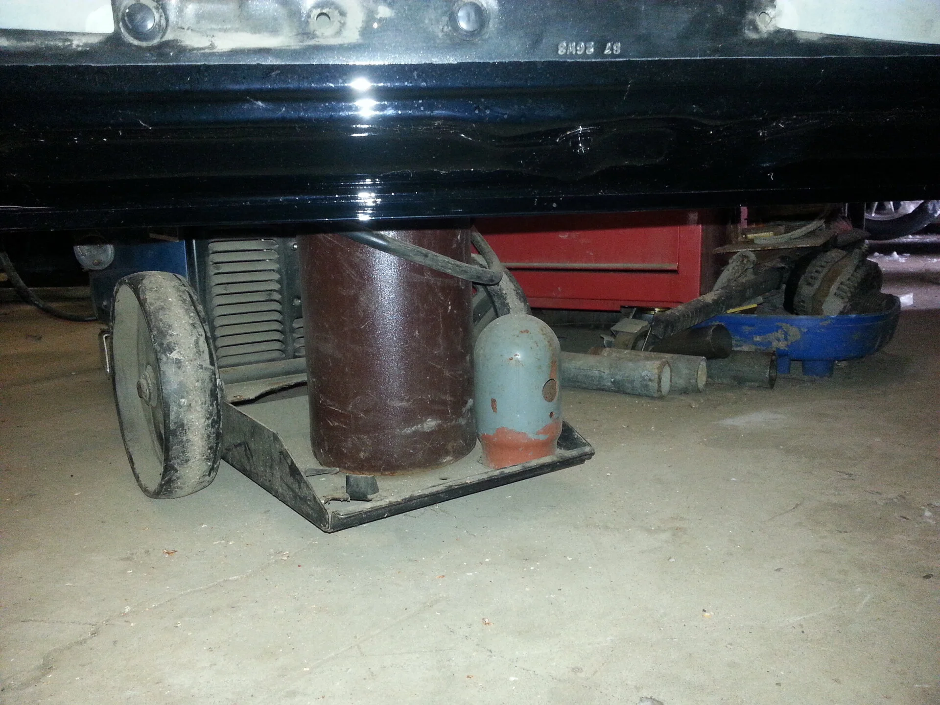

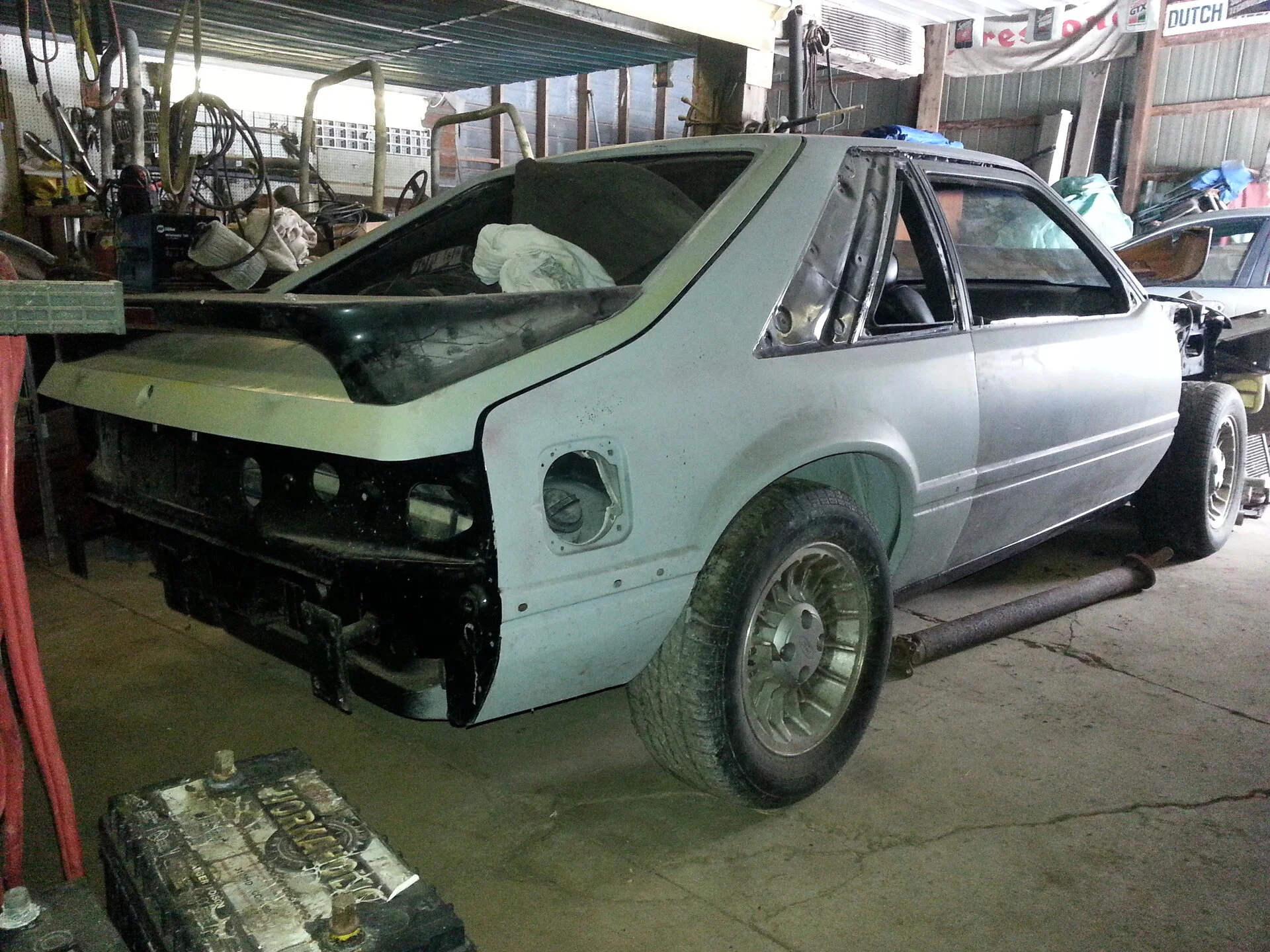

Steve102... I started with my car that needed only a small amount of floor pan repair (mainly on rear frame rails). It was disassembled but 95+% complete. I bought it for a project to put back together and build. As mentioned numerous times about, chassis/body integrity is key. It had 243,000 km and had been sitting in a barn for 12 years. I paid $1500 in 2015. Had it build, repaired, painted by June 2017 working on it on every other weekend. Did all the work myself (but that's what I wanted when I was looking for a project) and loved every minute.
Here is what I started with and what it is now.
Where are you located? Are you looking for something to just jump in and go or are you looking for that finish off and enjoy?
