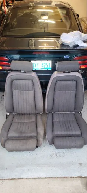

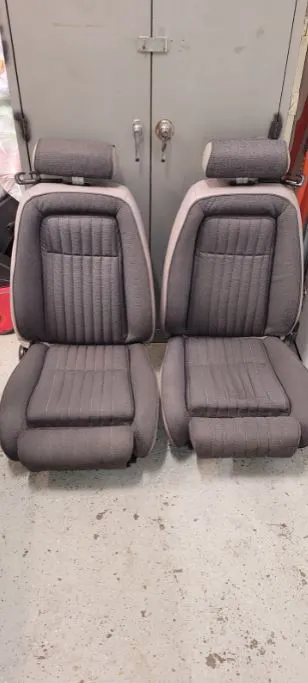

So, I stand a chance to buy a decent set of seats from a 1990 fox, cloth with manual tracks. Its Titanium vs Opal gray and won't match 100%, but that's not my main concern. I just want a bolt-in solution. And because most people are unhappy with height 'increase' with sn95's in a fox, I can only presume presume if I put fox seats in my 95, it will sit lower. Just curious if anyone has ever done this and what was your take on the setup?

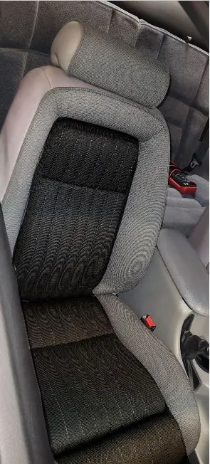

Personally I didn't see what the rub is on Fox seats until I realized there are a few different kinds. The 'standard' is kind of blah so I can see why the distaste. But the ones I picked up, they were sport seats? , pwr lumbar, adjustable bolsters and pull-out knee support. That's kind of cool for a cloth seat. Picked them up for $50 and for that price, figured its worth the experiment. They just needed a good cleaning but in the end, I think it turned out pretty good.
And for a crude measurement, using a level and tape measure at different parts of the seat vs 95 factory seat, looks like somewhere between .75-1in lower
Before

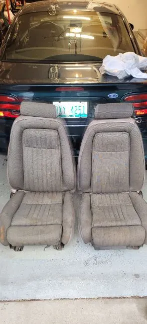

In progress
Clean

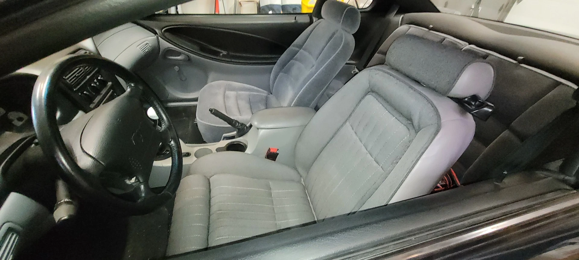

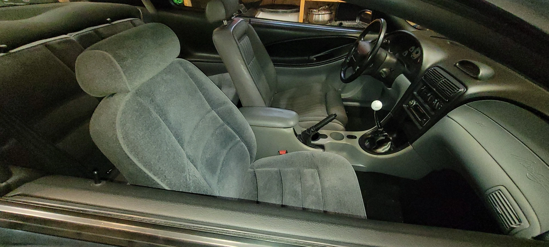

Installed
FYI, your seats are 1990-1991 Sport seats in "Titanium Gray".
$50 for a pair is a good price. With those cleaned up now, you could probably sell them for $200-250ish. I've never seen them in an SN95 before, so definitely a unique look.
That two-tone looks pretty sweet. How're you liking them?
In short, I love these seats. They are just downright more comfortable than the SN95 style. Plus no more space-shuttle launch feeling. The leg bolsters are nice when adjusted. I still haven't wired up a 12v source for the pwr lumbar yet, but then I don't do any extended driving beyond 45-60min.

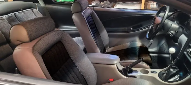

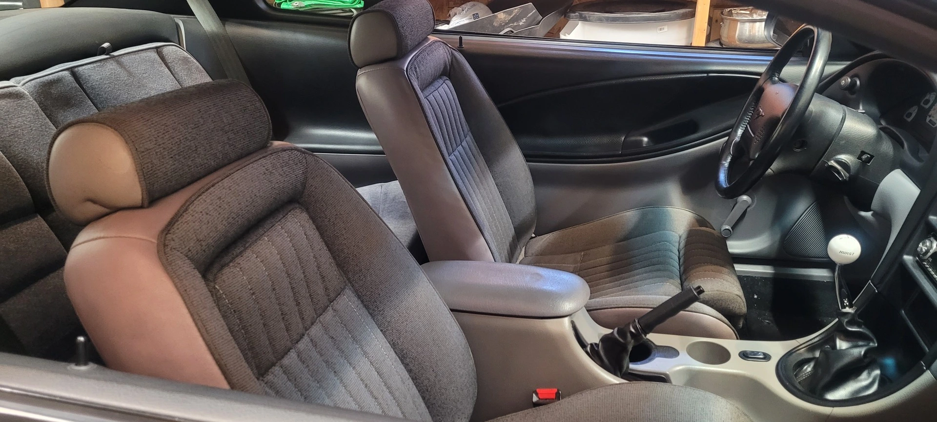

Frankly I'm surprised more people haven't done this mod since a lot of people usually seem unhappy with the sn95 seat height. Plus this is a direct bolt in making it super simple. As for the two-tone, I probably will try that done before the summer is over, plus I still need to add a rear seat delete too. Right now I got other projects (polish valve covers + GT40 intake install) I'm trying to get done in time for Woodward cruise.
