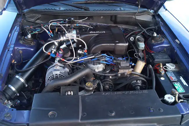

I just saw the below pic and was absolutely blown away.
This is the first time I have seen the fox conversion in a way that clearly shows the path air has to flow in order to get to the intake. :eek:
I run the regular SN95 elbow setup on my car. I got a single, straight pipe connecting my ProM 80/filter in the fender to the elbow.
No bends other than the one 45 at the elbow.
No way in hell the fox conversion is less restrictive with the TWO 90 degree bends than what I'm using now. :nono:
I know this has been talked about before but this pic ..................
To me ... the pic tells the whole complete story here.
Thoughts or comments ............. Anyone :D

As for the air flow resistance
The air has to pass two 90 degree bends. Bends in a pipe are a restriction to air flow. The more of them ... the more restriction
AND
The degree of the bend matters as well. A 45 degree bend will offer less restriction to air flow than a 90.
My best friend is an engineer and deals with air flow in his job. We've talked about the fox conversion several times. He always shakes his head and says
"Less total bends and smaller angle or degree of bend is how you cut down on restrictions when talking about passing air through pipe"
Anyway ...... Just a few more thoughts as I see it.
Grady

I can offer a bit more info on the air flow restriction part of the discussion.
When I first got my maf & tb, I had the maf/filter setup on kind of a temporary install. It was like it now is but, at the fender hole, I had a 90 degree bend with the maf/filter sitting down low by the frame rail.
After putting the maf/filter in the corner of the fender right behind the head light, which eliminated the 90 and allowed a straight shot to the elbow, I showed an increase of air flow in my data logs.
Grady

Anytime air velocity is rerouted it slows the flow rate down. In that picture it clearly shows there is no way it would out flow a straight shot made out of the same material. A bend in front of a meter is also a No-No. It would make more power with the air filter bolted to the meter and that 45 degree peice gone. Not Earth shattering numbers per say but since we are thinking out loud.
A few years ago at UPR (when it was a reputable shop) we dyoned like 6 homemade ram air kits. The one that made the most power was the smallest. Meaning the old saying the quickest way from point A to point B is a straight line. It was bascially the meter only inches away from the TB. A straight shot, no bends.

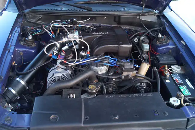

Hear this point of view from somebody that had performance parts on the 2 different setups. First of all most people that go to a Fox setup go with the home made cai, like I did. I havent seen that many people go with the fox Mac cai for instance for their new conversion. IMO the homemade version cannot be beat as far as velocity and all that crap. Take a look.
From the 80mm ProM mass air filter, in the 75mm pipe,to a small 45degree 75mm bend to the 75mm tb, and in the 75mm intake opening. Not much obstruction there, so in this case I see a good improvement with the relocation of that upper bend, compared to the stock place (tb wise). About the throttle response, I dont know what to tell ya. Its not the old electronics. There is definately a difference in it. Guess you'd have to try it to see it cause its there. The Fox TB conversion is not a myth if you know how to take advantage of it...

Hey Mario
I'm with you on this one :D
The way you have got things setup has to offer the least restriction to air flow IMHO.
Looks good to me :nice:
btw, is that 3 inch pipe?
Grady

Yeah it was my old setup when the engine was still running. It is in fact a 3" pipe. I decided to go with that instead of a 4" to keep the same size everywhere I guess. For me it was best but I might be wrong.
I also used to have it in shorter form but I made it longer so I dont get the hot air from the engine. I dont think the lenght was a bad thing since it was straight. To a point for sure...
