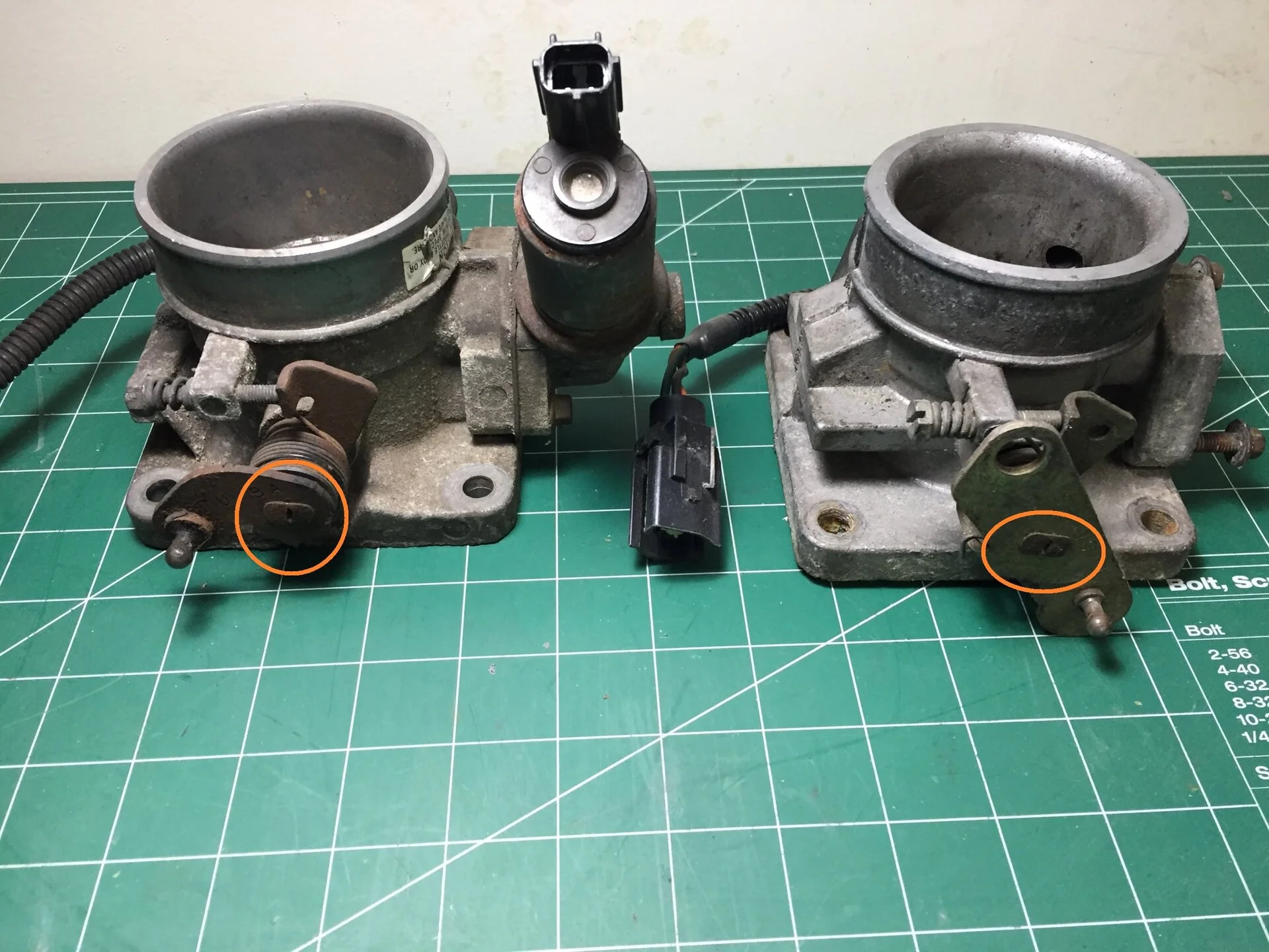

When I converted an Explorer TB for use on my Fox I just changed the throttle linkage arm and rotated the vapor tube. For the TPS, I made a conversion connector cord to adapt Explorer TPS to Fox harness. Simply take the TPS and cut the connector from the Explorer harness it connects to. Then cut the TPS connector from an old Fox TPS. Connect them together and Boom, Fox harness to Explorer TPS adapter. Then use an Explorer TPS and there will not be any fitment issue.
As far as modifying the throttle linkage arm, simply grind the circled tabs smooth. (pic borrowed from Mustang5L5's Tech Guide above)
You will then see the end of the shaft. The arm will simply slide off. Move the Mustang arm over to the Explorer TB and tack weld over the end of the shaft to retain the arm (I have seen some forums/discussions that say you can epoxy/JB Weld the arm in place as well, but I welded mine).
This method is not as involved as what Mustang5L5 describes but from my experience works just as good.
The IAC from Mustang will bolt up to Explorer without issue so nothing special there.
This conversion will work with both stock Mustang and Explorer GT40 style intakes.
