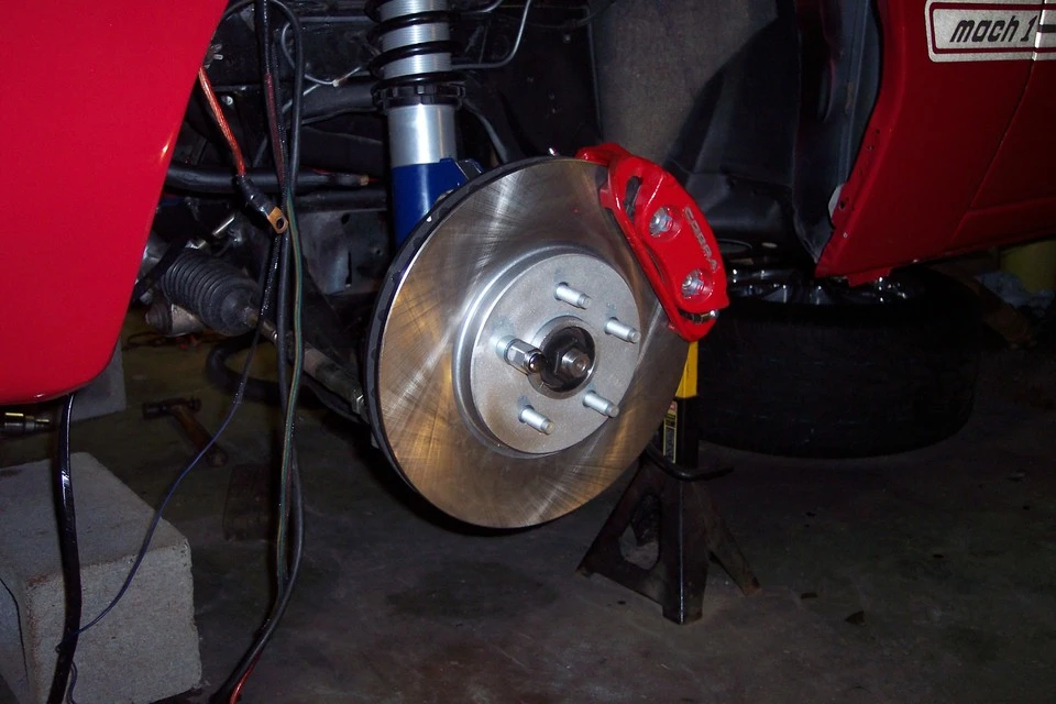

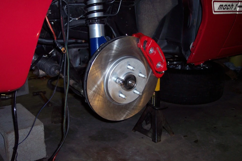

So I set off this morning to install the front brakes.
First issue: The spindle is 1/4" narrower than my 4 cyl struts. So I make some spacers out of 1/8th" plate x 4. 1 hour.
Second Issue: Drill the tie rod end out to 5/8 on the spindle for the 5/8 bolts that hold the rod ends I use instead of tie rod ends. 20 mins. Done.
Mount the spindle on my LCA, tighten the lower ball joint, put the spindle into the strut, spacers on both sides, bolt it together, done w/ that. Put the hub on the spindle, use that crazy nut to bolt it down, torque it, and throw that big assed rotor on it. Caliper's next, two bolts later it's on. Put my heim end through the spacers on my 5/8" bolt, and the drivers' side is done. 15 minutes tops.
We all know what it looks like, but for me it's the first time I've seen it so you'll have to humor me.
For those that pay attention, I dropped the rack 3/4", and the front end is as low as I could get it,..so I had to use a few........spacers.
I go to the other side, and start to assemble it, and it moves along just the same way, until I attempt to attach the steering to the tie rod mount point. It's bent like a b itch.
Guess it was hurt from the wreck after all. Now I gotta try and take it back to the JY and get another one two months after the fact. Fat chance huh?:nonono:

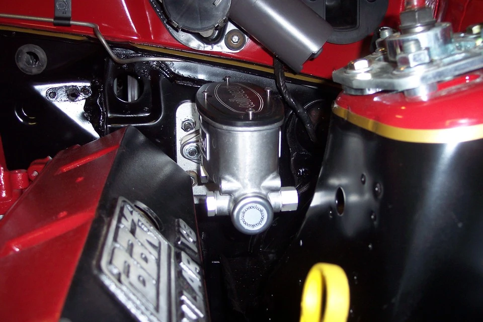

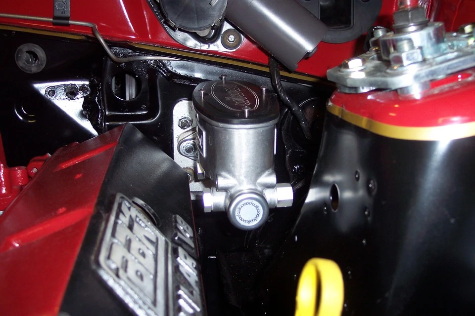

Moved on to the M/C. I bought this Wilwood unit to get more clearance because the lines exit on the shock tower side as opposed to the engine side like the stock unit did. According to Wilwood, there was no other benefit to upgrading to this unit from the stocker NikwoaC recommended. Well, ...It does look good,...so I got that going for me......... Which is nice.
As for getting additional clearance, I got some.
A little .:shrug:
The thing cost 189.00, so lets add that to the total, now just a little over 600.00 in the brakes.
