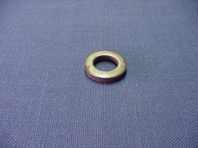

I machined my own, some guys on forums do sell them. There was a vendor selling them but can't think of who it was.
Some guys used 5/8" ID washers with a stacked hieght of 0.330"
The force on the spacer is compression, so as long as you use a quality steel or washer, there should be no issue with mushrooming.
I made mine out of 316L Stainless. been 2 years...no issues. And sorry, i can't make anymore at this time.

My custom machines spacer. New fox balljoints in ford racing a arms....so I didn't want to ruin anything by pressing them out.

Nice washers.
Yea, those are a much better width than the Breeze Auto washers. But, my guess is that it would also be $20+ each for those washers because of the time involved and the material/machining cost.
If people really really want to use single washers, they can use emachineshop, design them, and pay ~~$150->~$200 for ~2 to 10 pieces.
