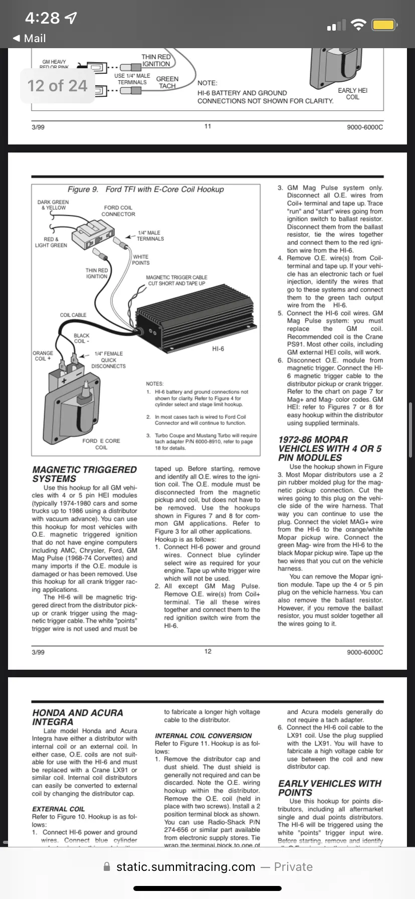

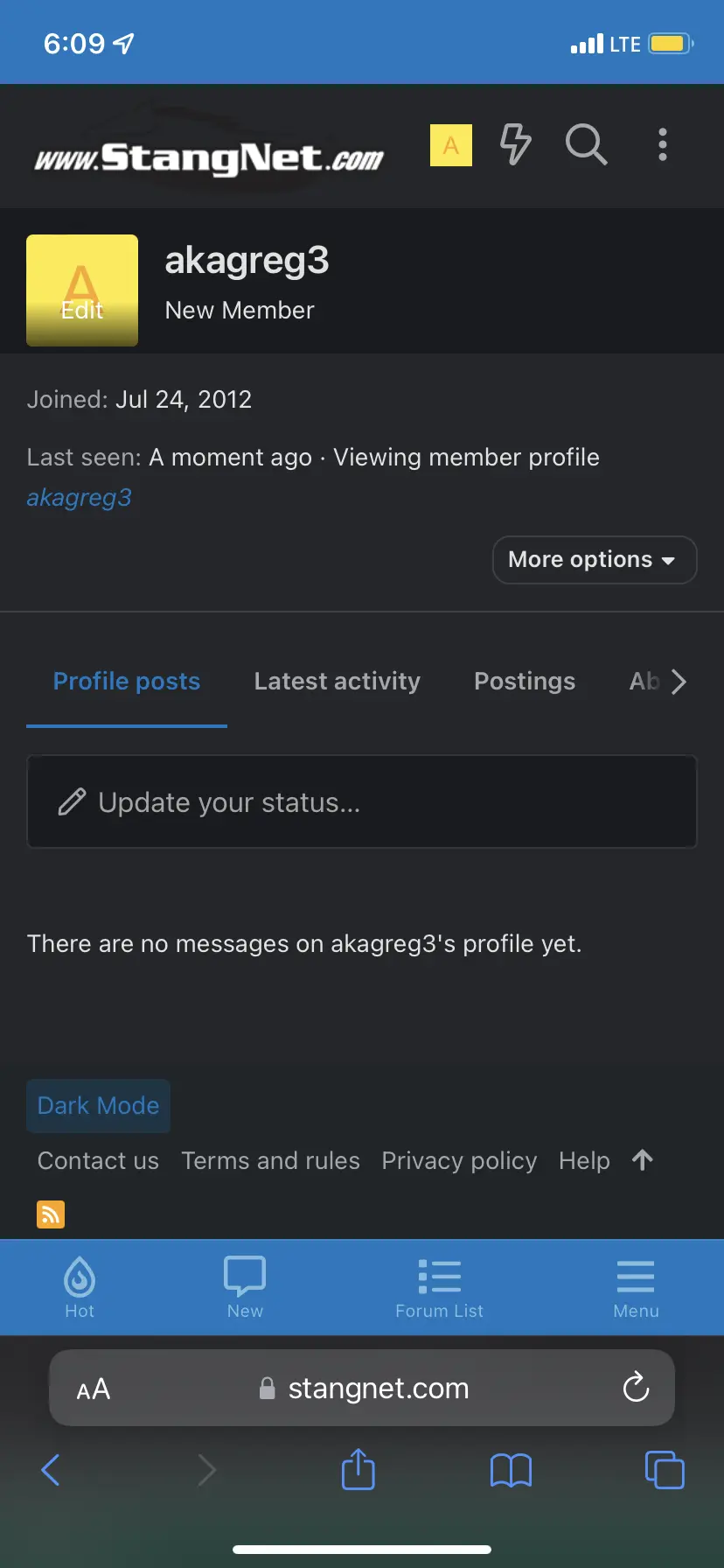

Lol yea probably had this account 12 years now, there just people that post on the Internet because they can, it’s not helpful telling someone they don’t need it because you don’t know how to hook it up. But here how you hook it up, you’re welcome
Trouble is, that's not what happened. O_o
If you look closely enough, there are [droves] of Mustang Knuckle Draggers running over 500 CHP on the stock ignition systems (I'm one of those folks). Along with that are [droves] of instances about dumping money into these ignition systems only to remove them again for the issues that they cause.
We already get a nice, hot, fat, spark from the OEM system. It's one of the few things already present that's just crying for forced induction. :)
Has nothing at all to do with knowing how to hook one up and a lot more about preventing somebody from headaches we've already endured for [ZERO] horsepower[Z] and added reliability issues.
