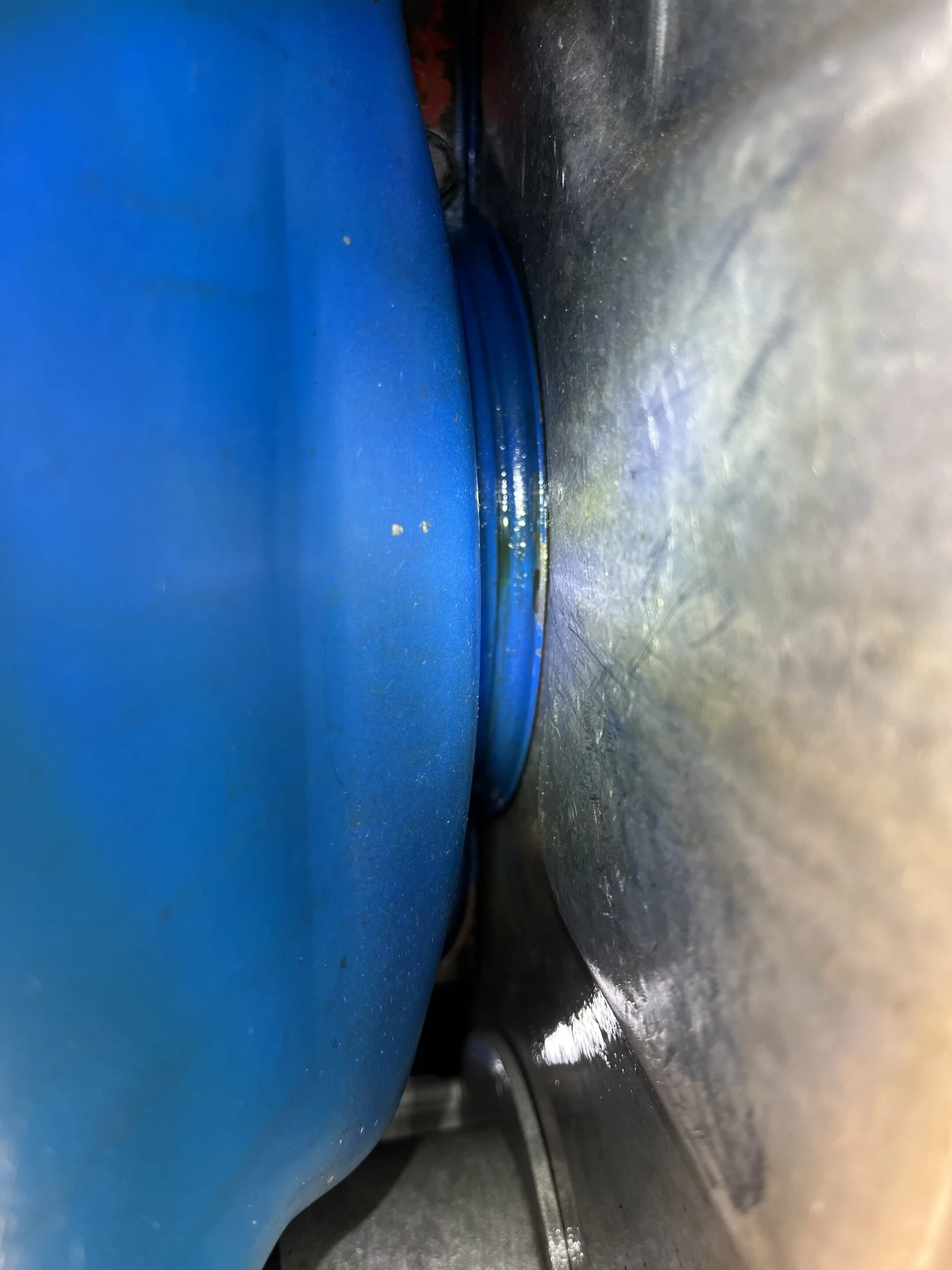

Alrighty, I can confirm a new PCM solved all my issues. Crazy how that works.. Anyways, only things I have left are an exhaust leak I’m trying to fix and with these aftermarket headers, that’s proving to be a pita. I do have an oil leak inbetween the pan and the transmission. It’s very steady, and it’s keeping me from driving the car. Sound like a rear main? It isn’t an obvious pan leak, it looks more like it’s coming from directly inbetween.

Here’s a photo for reference. This leak really only drips when the car is running, and it is really bad. Leaves a puddle every time. This is right between the oil pan and the flex plate

That’s where I’m putting my money aswell. Gonna get it pulled this weekend. Final piece of the puzzle and it’ll officially be fixed and ready to drive after 2.5 long years
