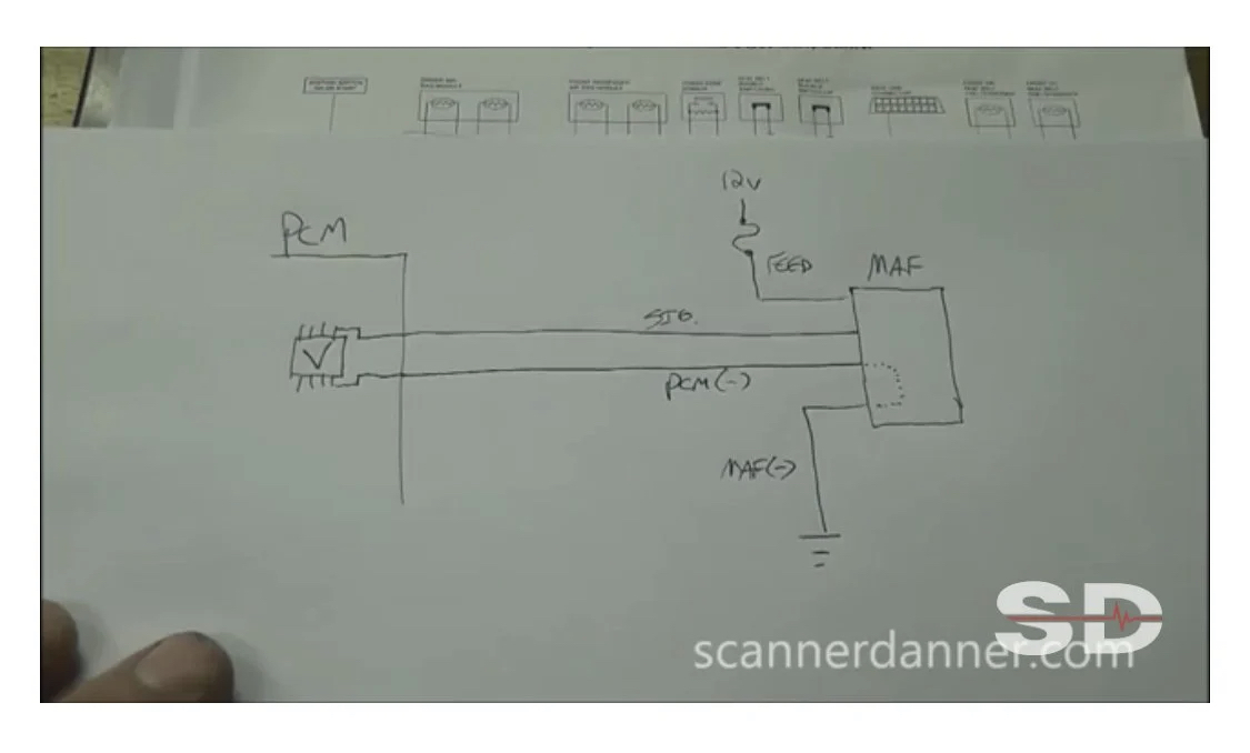

The MAF meter has to be plugged in to correctly test it. IIRC, the “ground” is a loop.

The Ford MAF has 2 grounds, (sorta), and no 5v ref.
-you have the battery voltage wire
-Signal return wire
-A signal ground
-A chassis ground wire
the 2 ground wires connect to each other through the MAF. So if you unplug the MAF to do the test, you disconnect the signal ground.
The MAF must remain plugged in.
