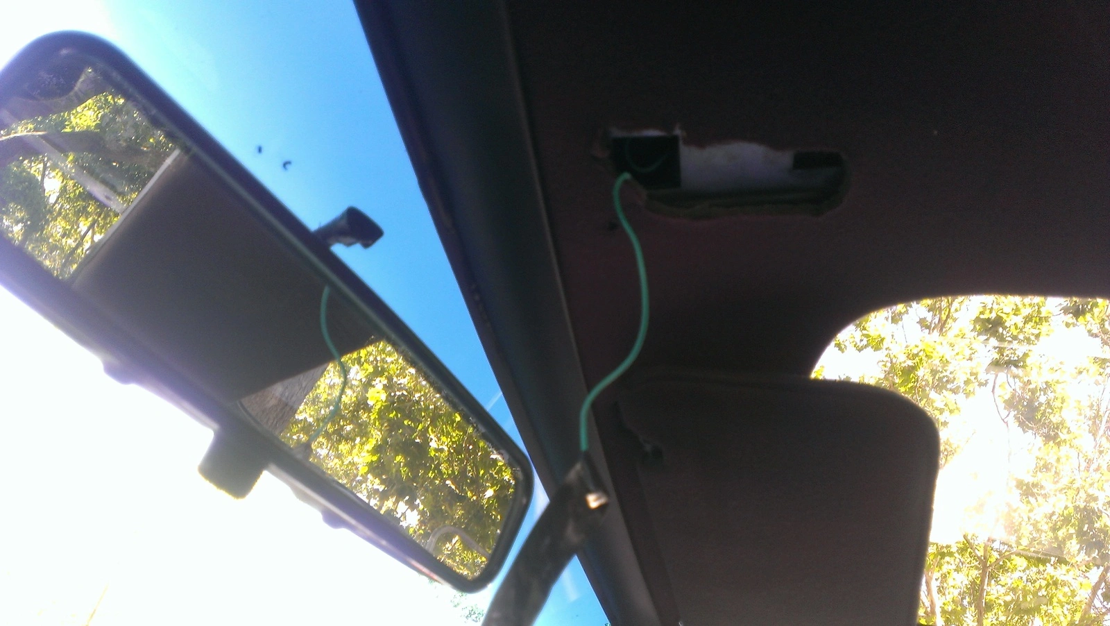

Here is a picture of a lighted ford rear view mirror and the start of deleting my map light. Can't remember what car it came out of, but I found it from a local salvage yard.

If you look under the dash, ford had originally installed two light bulb sockets for a 168 bulb on each side. One is by the driver's left knee under the dash and the other is dead center of the passenger foot well. If you stick bulbs in here, they will light when the doors open.
What you could do is install some sort of interior accent lighting and tap here for power

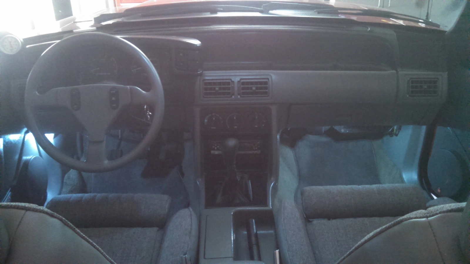

I installed LED's in place of the stock bulbs in the rearview mirror and lower courtesy lights under the dash in my vert.
They're really bright, make a huge difference and look really cool at night with the door open.
Pardon this terrible pic. You can't see the rearview mirror, (note a glow on the center a/c vents) but can see how bright the courtesy lights are even though the sun is shining into the window of my garage. LOL
I'll try to take a better pic tonight if interested.
I do agree that it would be cool to somehow slip in a small LED under the window/door lock switches to highlight them. I da know? I also thought about installing a low power LED under each seat to highlight the floor while driving. "anything to lighten up an otherwise dark interior"
