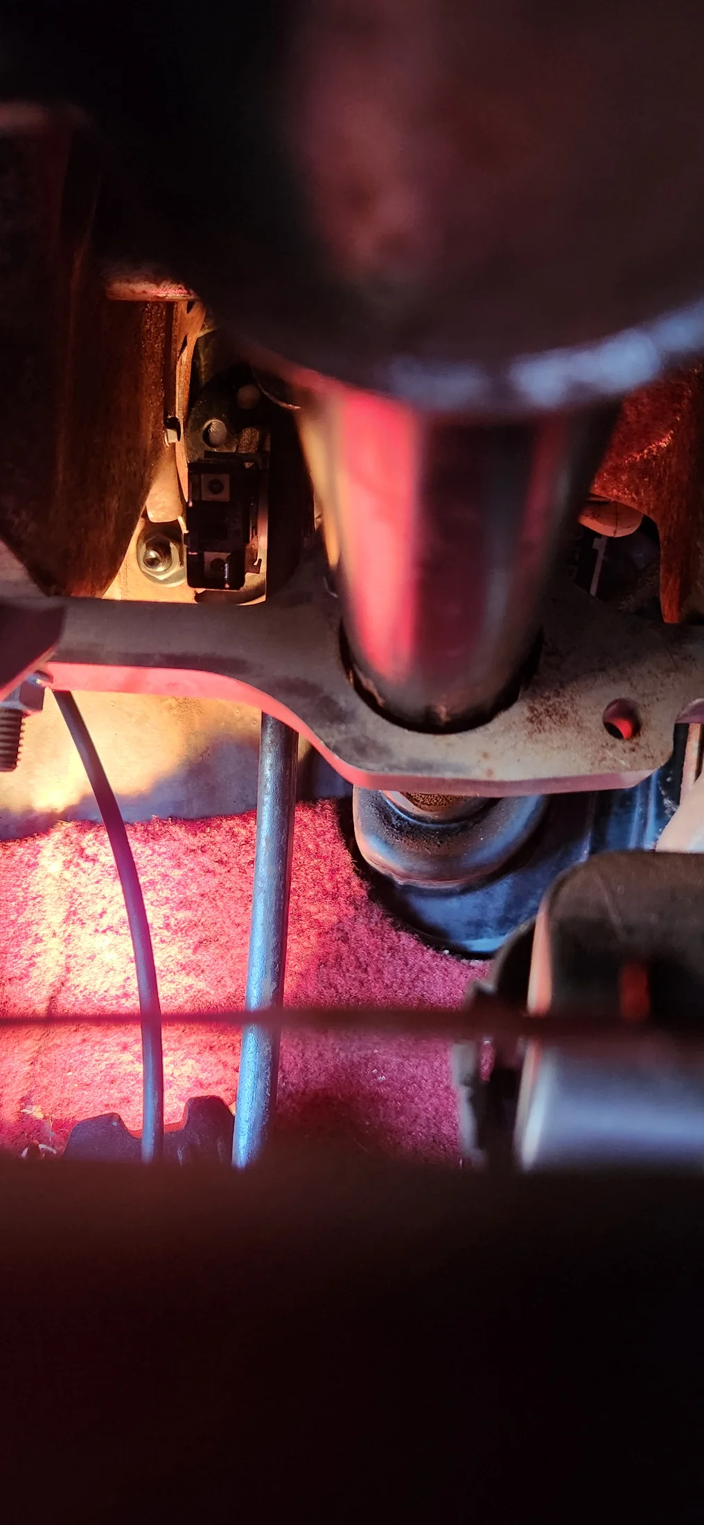

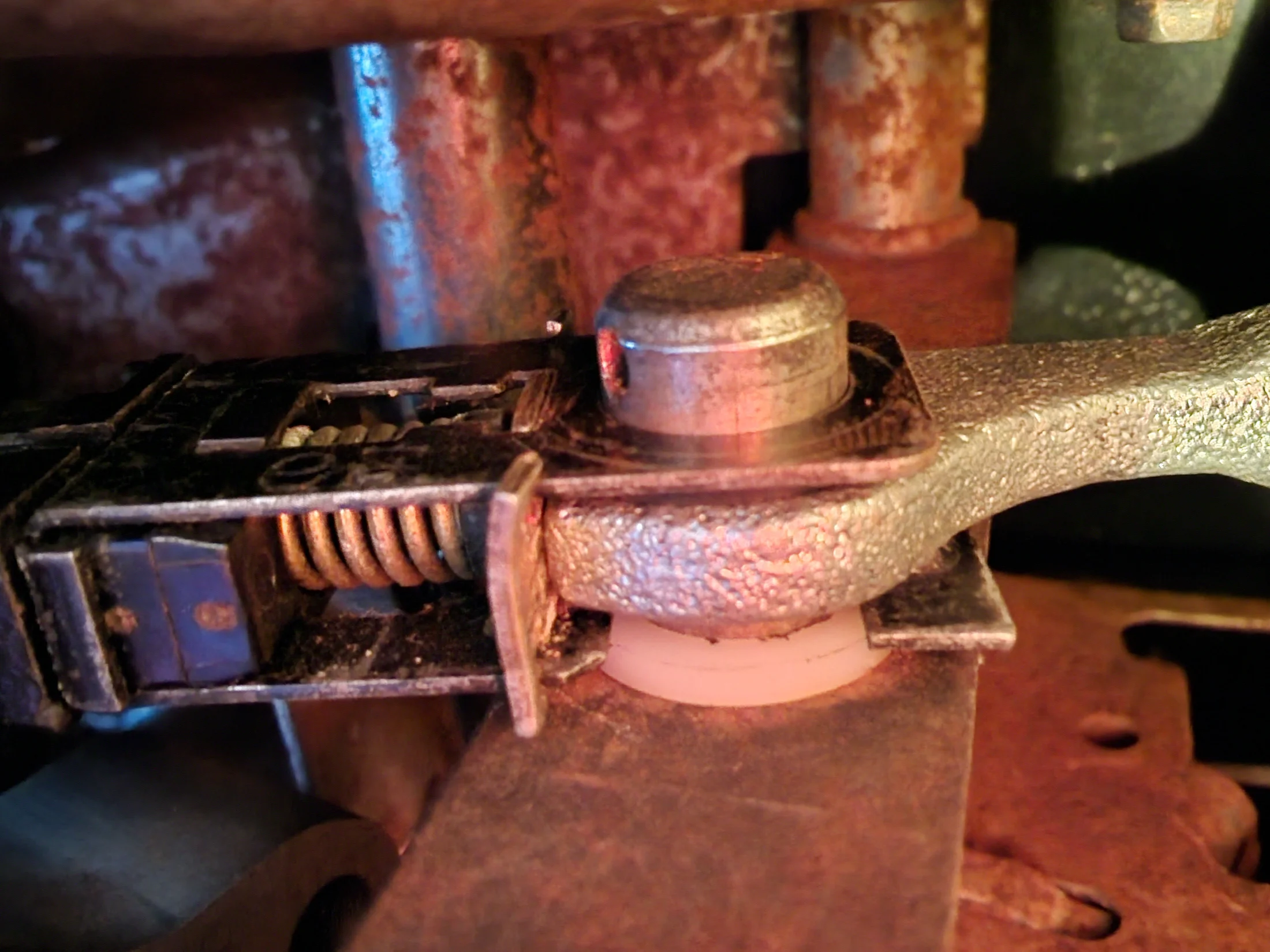

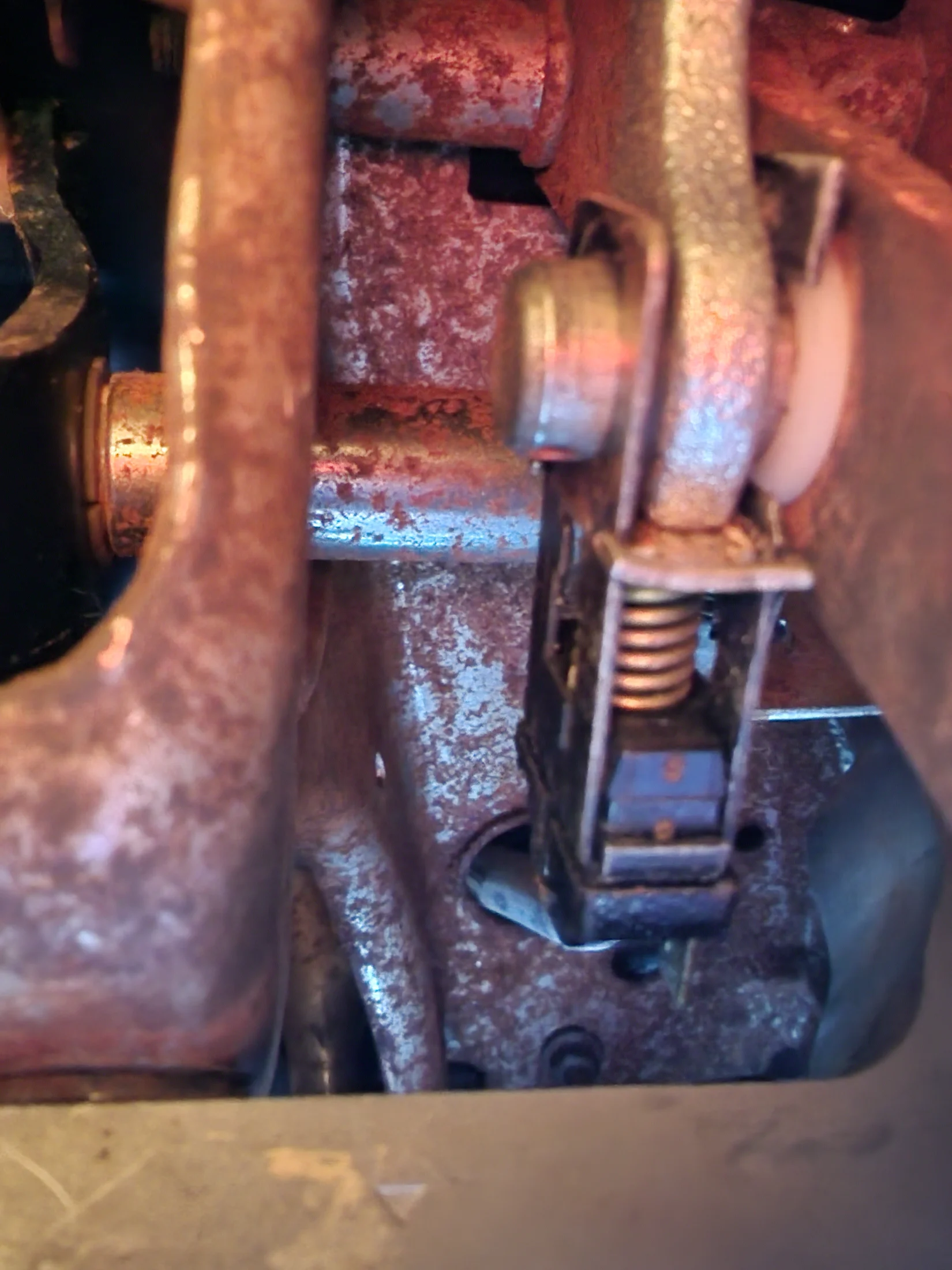

Your switch works, it's installed wrong. Switch does not 'rotate'. You have it upside down or backwards,.without a pic I can't tell what's amiss, I understand a pic in that area is challenging.
First and foremost, don't crucify me for the surface rust on the structure under the dash, I haven't gotten there yet. They are attached including a video for the movement to validate the booster arm with plastic bushing fits appropriately on the knob of the brake pedal, as @Scrapla347 suggested above. Thanks again for your help.

So by the looks of it you do not have the cruise control piece on the brake pedal so you need two of the white plastic washers on the brake pedal stud before you install the switch. You should also have a plastic bushing in the brake booster rod which I think is installed but hard to tell. You have the switch oriented correctly so that is not an issue.
If you can try and upload a video or what the switch looks like orientation wise when the pedal is depressed.

It looks like your brake switch has a problem. When the pedal moves forward it should compress slightly which is what completes the circuit in the switch. The plate part of the brake light switch right behind the brake pedal rod should move and compress that spring. Watch this video:
View: https://www.youtube.com/watch?v=nbNPbCCuHlM
It looks like the plate in yours is bent and causing it to jam up and not move.

Great pics. The electrical connection portion of the switch is suppose to face towards you if I'm not mistaken. There should also be a red clip that holds it all in place.

This video is what fixed my brake issue. It explained, specifically with the plastic hat bushing, how it compresses the light switch causing the brake lights to illuminate. I measured my old and new plastic hat bushings, not a lot of discrepancies there. What i did do was take a dremmel tool with a sanding drum and sanded my booster arm that connects to the brake pedal allowing for this movement to compress the plate enough to illuminate my brake lights, but not so much that they illuminate without requiring brake pedal movement (not coming on just sitting there). Thank you so much for this. Now on to my next project, engine vacuum lines and connections. Thank you so much again.
