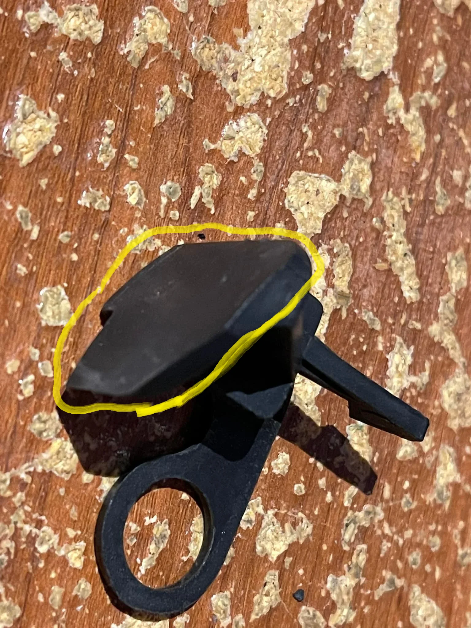

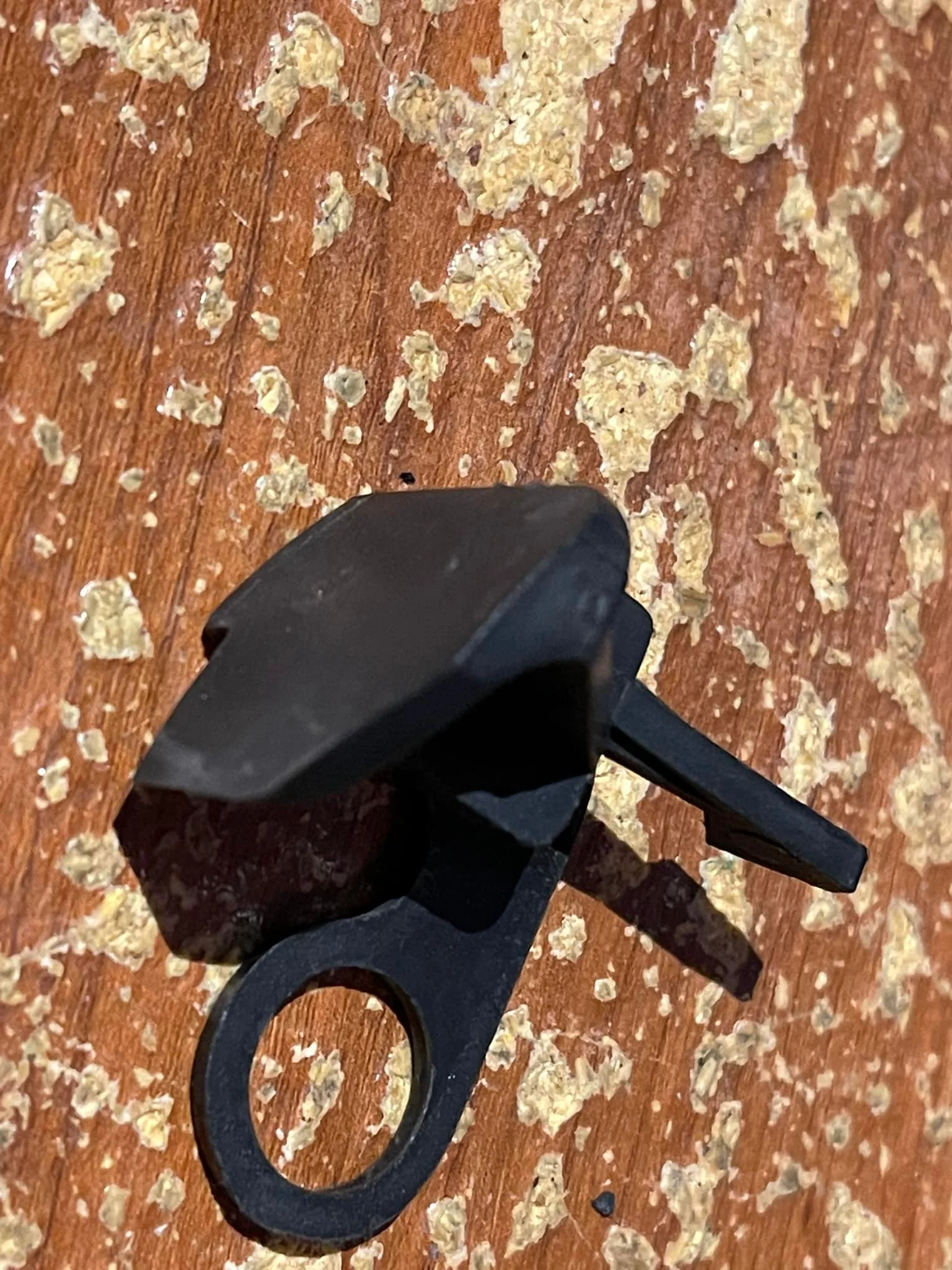

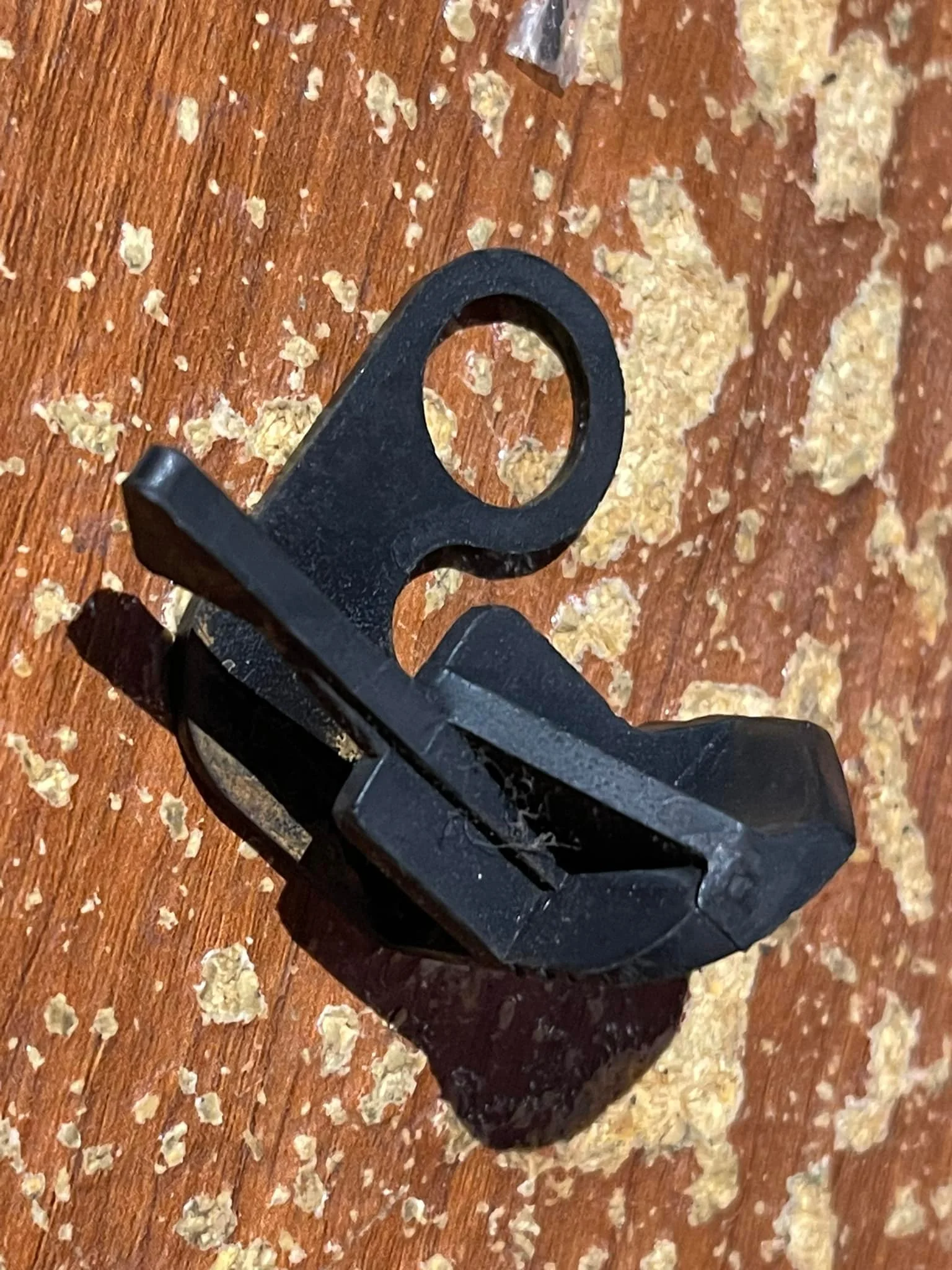

The striker part for the newer mustangs are not in the same spot. Where the striker surface for my foxbody would be in one spot, it is offset for the newer cars. Hard to explain really. For the foxbody, the striker face would be where the piece wraps around the face of the pedal assembly, on the SN95's it is offset, or lower towards brake booster. Certain this is clear as mud.
Yes Al, clear as a mud, I wonder because I gots a peddle assembly with all the widgets
@Scrapla347 posted a picture earlier in my thread of a good bracket for the cruise control. I highlighted the striker face that contacts the switch for cruise control. On the newer set ups, this face is offset lower, or towards the mounting hole and doesn't contact the switch. That is the best I can explain with my limited vocabulary. Hope this helps.
