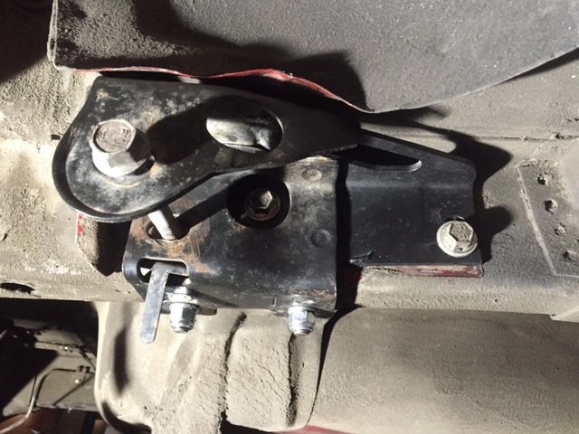

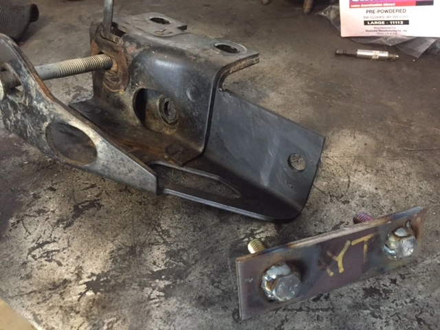

This is how my rear upper brackets were fab'd and installed.
yes i did install the irs. i also installed the rear brackets the same way. im think i am going to adjust the camber until it clears.

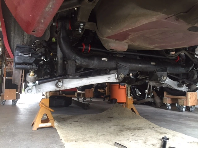

I haven’t aligned since I installed IRS into the Daddywagon. As soon as I get everything squared away an alignment is on my list of things to do. 05 and up wheels fit on foxes with irs. My wheels are 06-11 17x7.5 crown vic wheels. I am running 25mm spacers up front.

sab24711 said:
Street only. Looking for a comfortable ride, since doing some more info I think 350 up front 475 rear. Reason being I have Bilstien HD shocks.
I called the Maximum Motorsports tech line to ask questions and order MM coilovers for the rear (IRS) of my car to match my MM coilovers up front. They told me to keep my money and run the factory Cobra IRS springs out back with a 3/4 coil cut (for the ride height I wanted) and run the Bilstiens. They could've sold me their product but insisted that I do NOT. I would call them and see what they recommend.

Before you cut anything you might want to install and check. I was given stock rear coils that still had the ford labels on them and my car is lowered. There must be a height variation in the upper spring mounting point between my old fox chassis and the cobra chassis. My fox is a 1985 station wagon... so there’s that. But you might want to check first.
