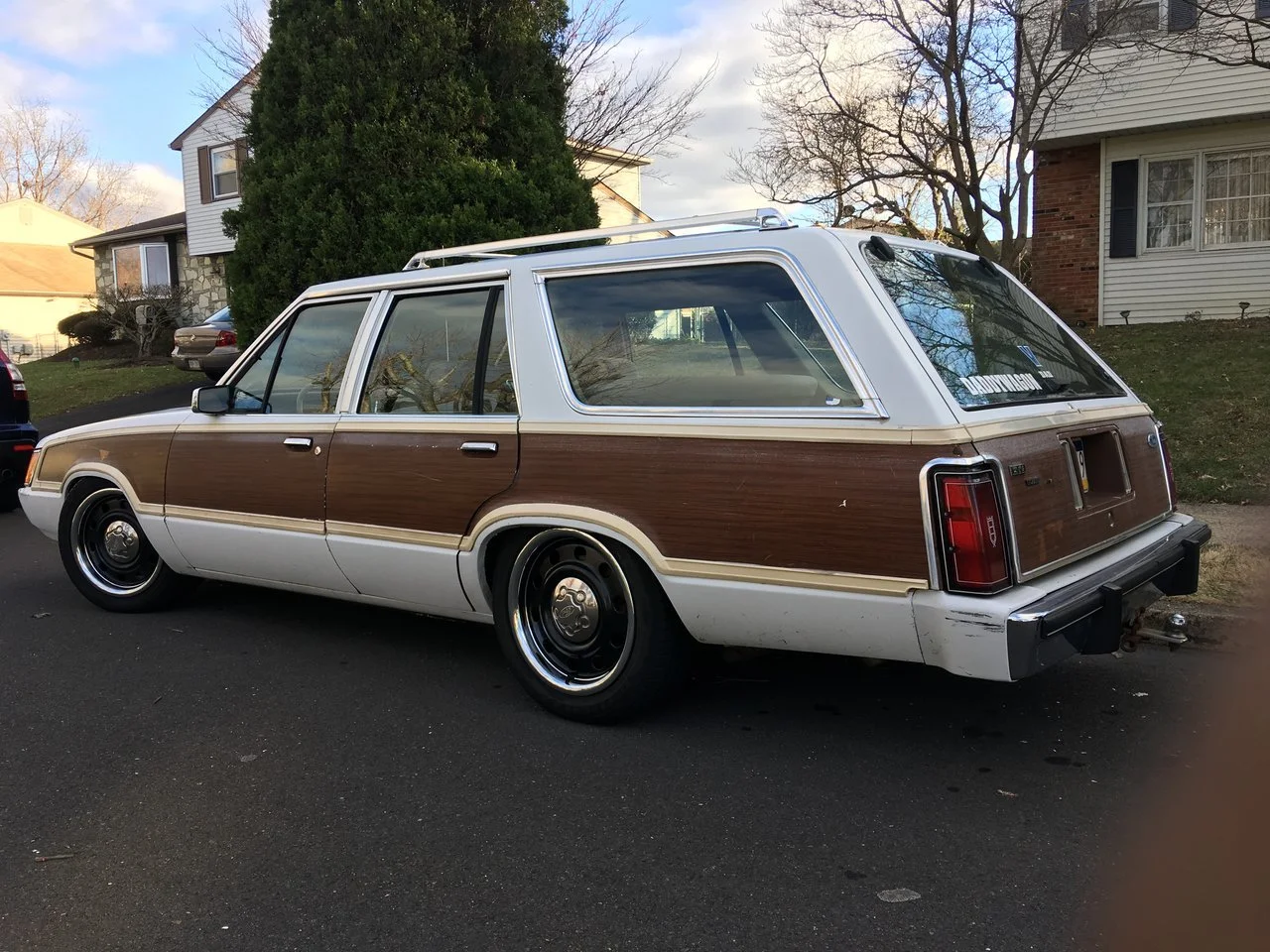

Before you cut anything you might want to install and check. I was given stock rear coils that still had the ford labels on them and my car is lowered. There must be a height variation in the upper spring mounting point between my old fox chassis and the cobra chassis. My fox is a 1985 station wagon... so there’s that. But you might want to check first.

I honestly don’t think the difference is all that much. But... maybe.

Wow! There must be a difference with between early fox chassis and later! Truthfully it bothered me at first that my car was low at the rear. Up front are ford b or c springs. I can’t recall which. When I had the 302 in there occasionally it looked nose high. Now it has a 351. The stance looks perfect and has grown on me. The car handles well. IRS foxes are awesome!

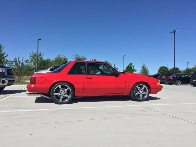

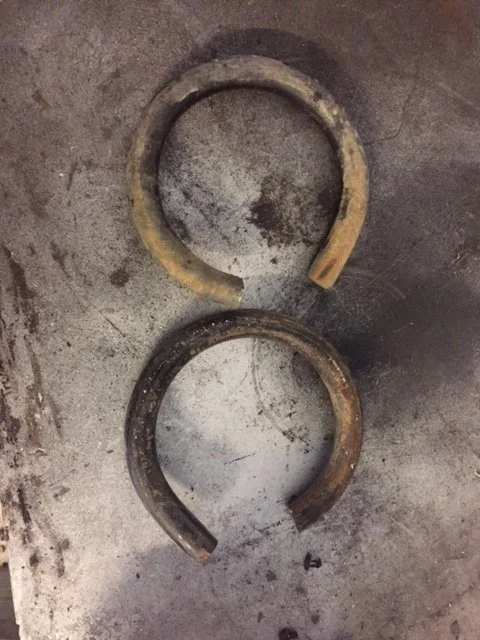

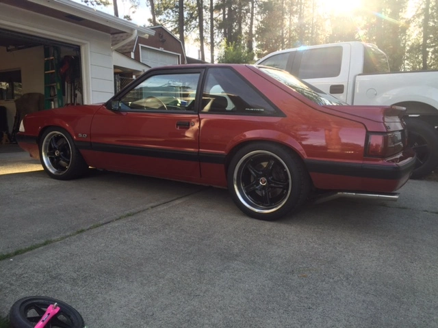

I cut this much spring....
for this much ride height....
I have 245/40/18's in the back which I believe is a 25.7" tire

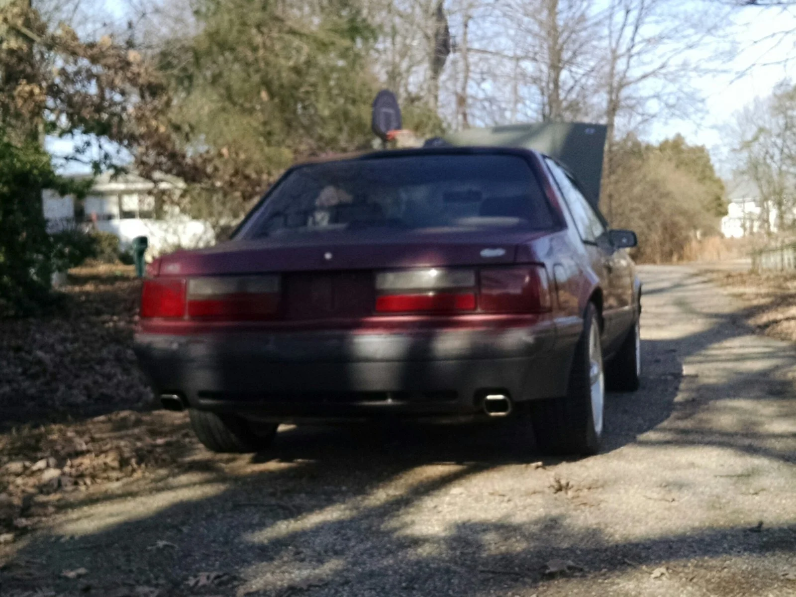

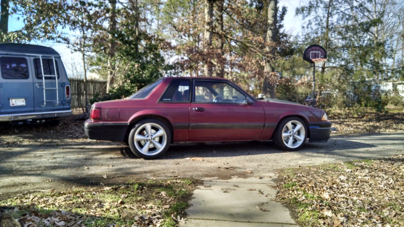

I drove mine with cut factory springs in the rear and Proline's up front... I didn't like it at all. The ride was way too stiff up front and way to bouncy in the back, plus it wasn't level. I cut a full coil and was lower in the rear. Now with coil overs all around it's very well balanced and level.
Before:
After:
