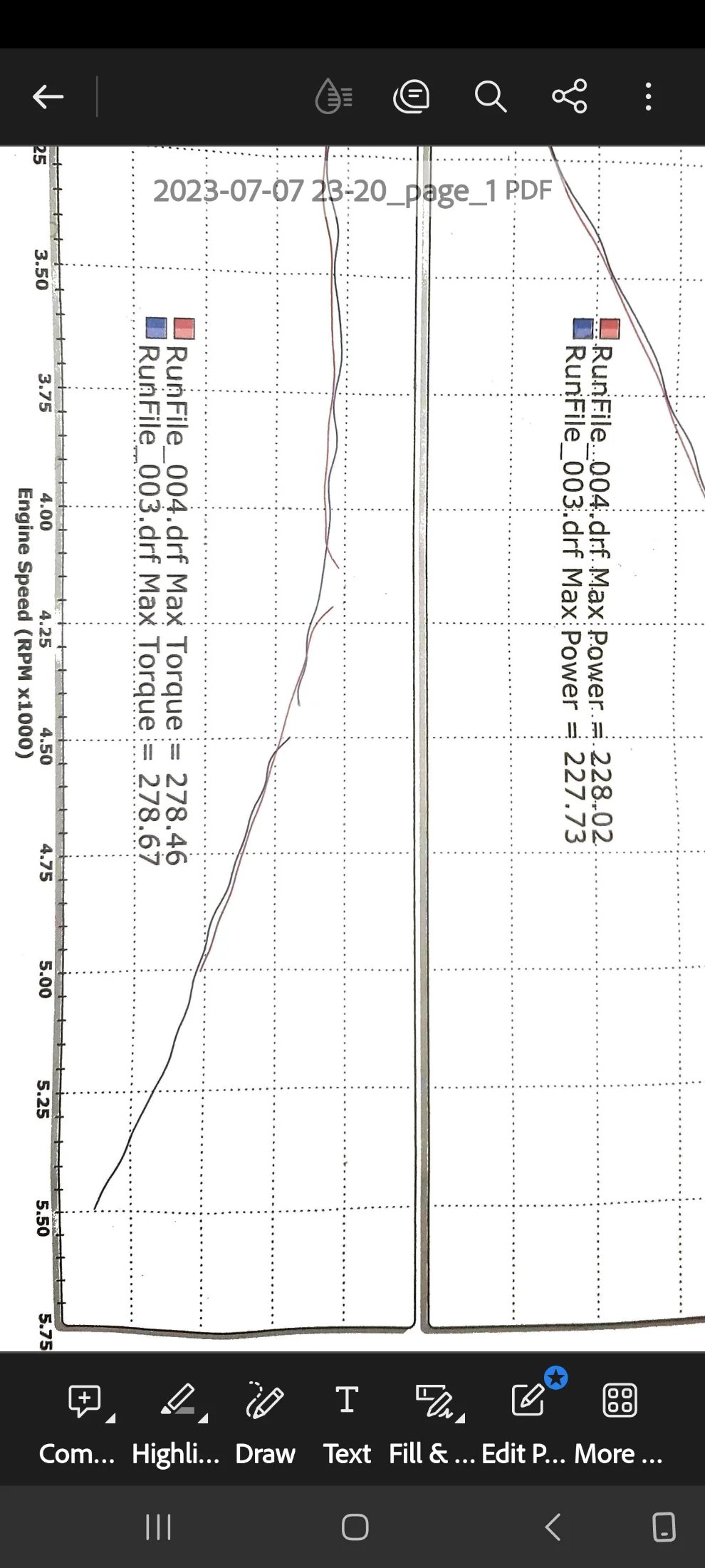

What is your base timing set at? Mine is tuned for 94 with a sct chip on dyno i got 278 torque and 228 to the wheels. but kinda pointless I guess since I have the stock e7 heads. With an explorer intake, my base timing set at 10degrees. She purrs like a kitten though lots of torque with my 4.10 gears and z-spec 5speed.
