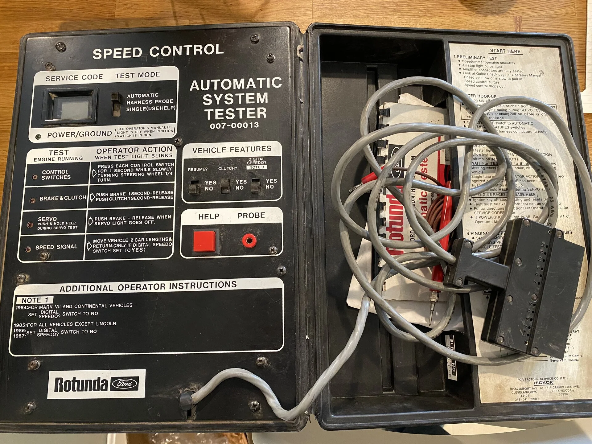

Ended up buying myself a Rotunda unit. I’ll test this out on my car when the time comes

Jack the rear off the ground and you can test it “driving” like that. Not the safest but it can be done easily.
The Ford manual actually tells you to disconnect the cable from the throttle body just in case it does go WOT during testing.
