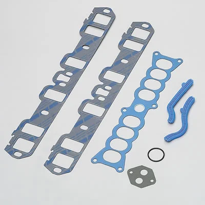

Oh yeah, the best intake gasket to get (IMO) is the fel pro ms93334. It now comes with rubber end seals with little lips on the sides of them so they don't squeeze out when you tighten the manifold. The end seals install dry. Just put a thin bead of silicone around the water ports on the gaskets and at the corners where the gaskets and end seals meet. That's how I do it anyways, and never have any problems.
Check out this pic, you can see the end seals.
