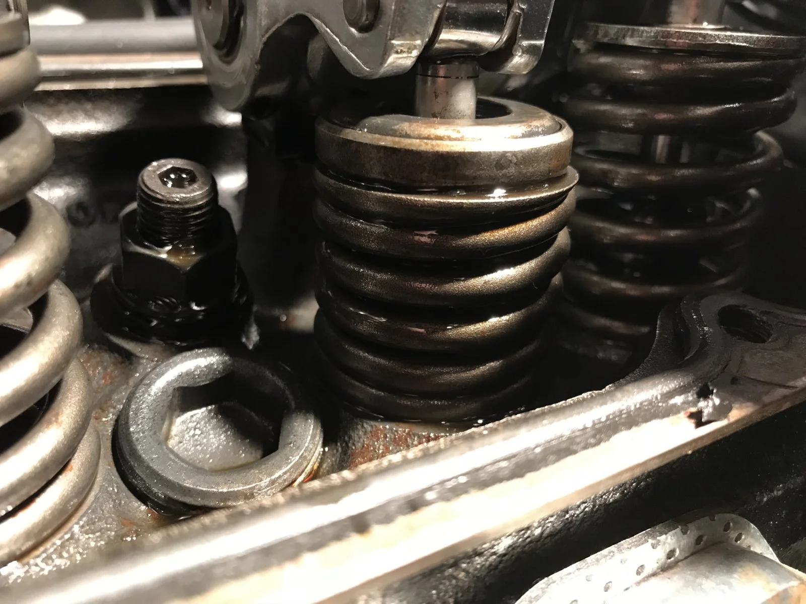

-1) Flange(s) pictured indicate Carbon streaks (edited pic. below).
-2) Flanges not parallel to each other nor perpendicular to the shorty Header/downstream exhaust piping Ball & Socket joint. Upper bolt @ angle to meet Header collector flange- incorrect Pipe flange? Hard to seal if not the same pattern..
I’d pull and clean/repair if joint(s) damaged, reseat/equally align & re-torque these & others like it. Apply a non hardening exhaust sealant. Never seize on all Bolts & spark Plug threads (below).

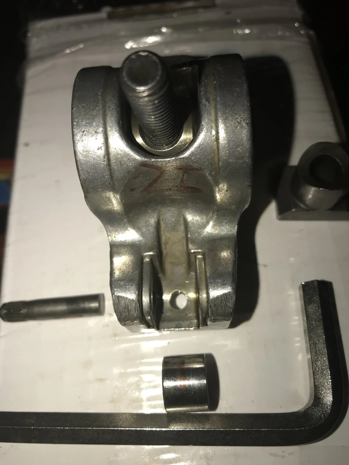

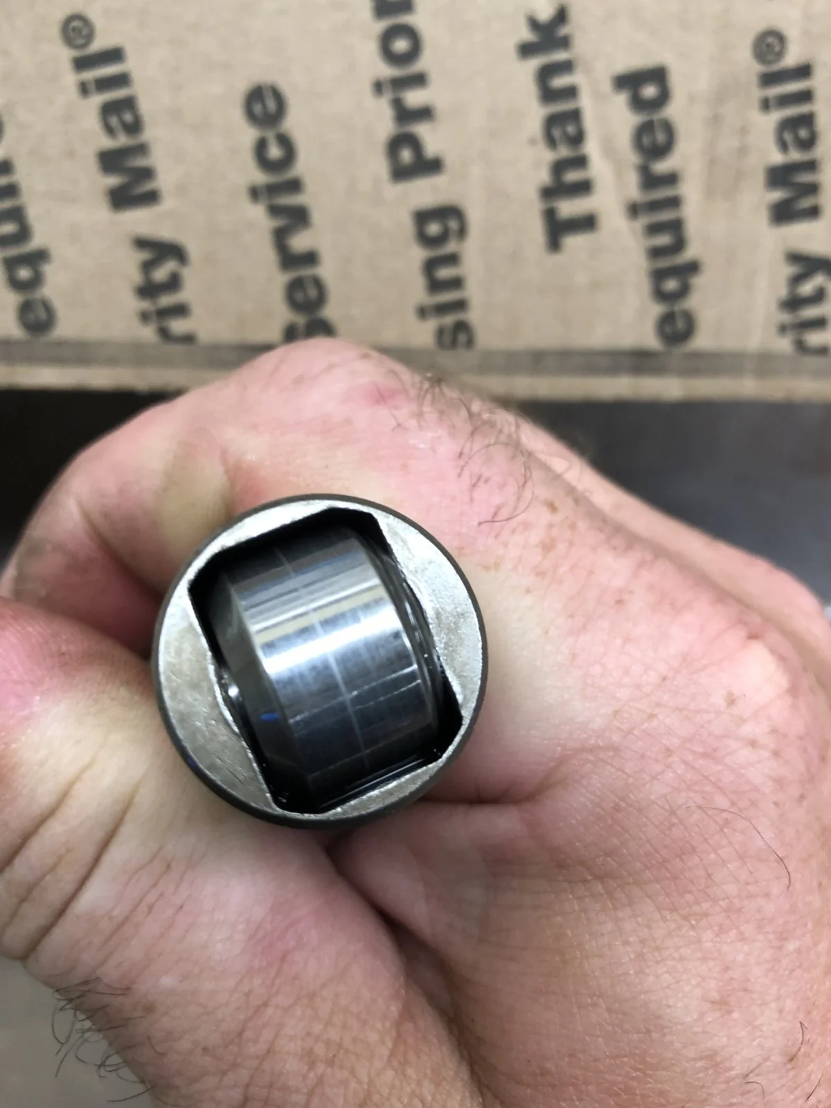

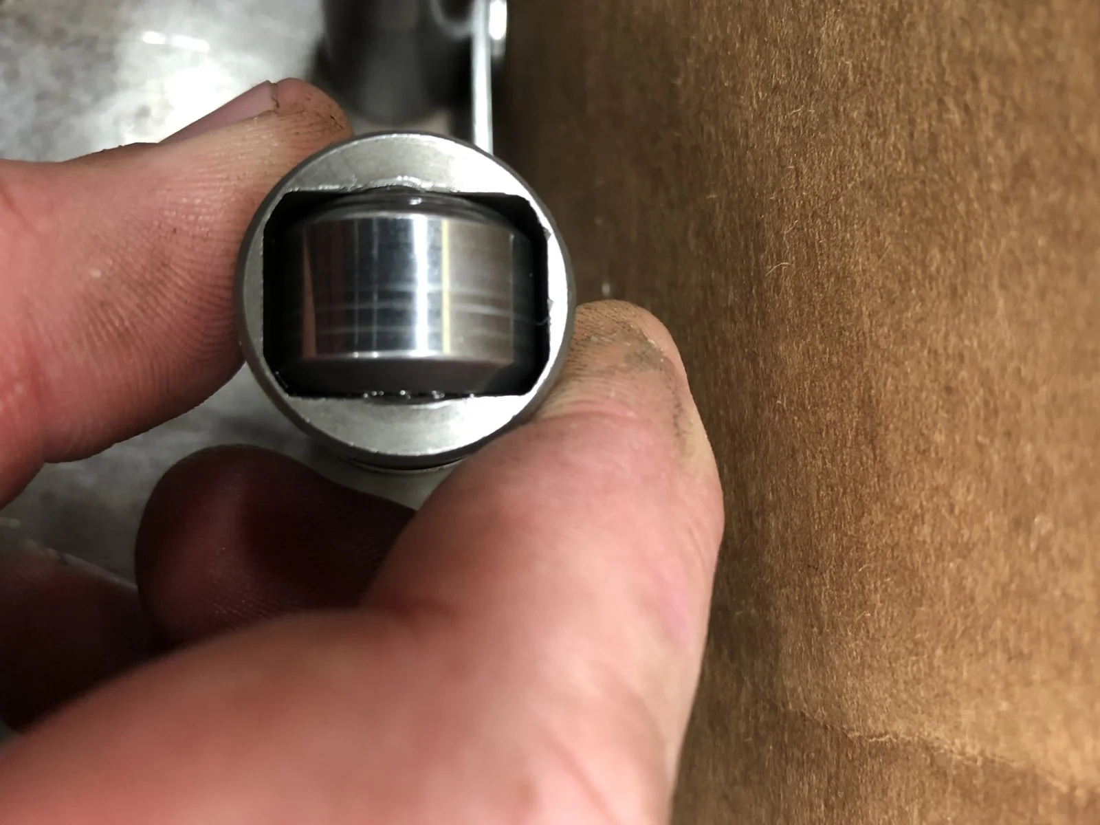

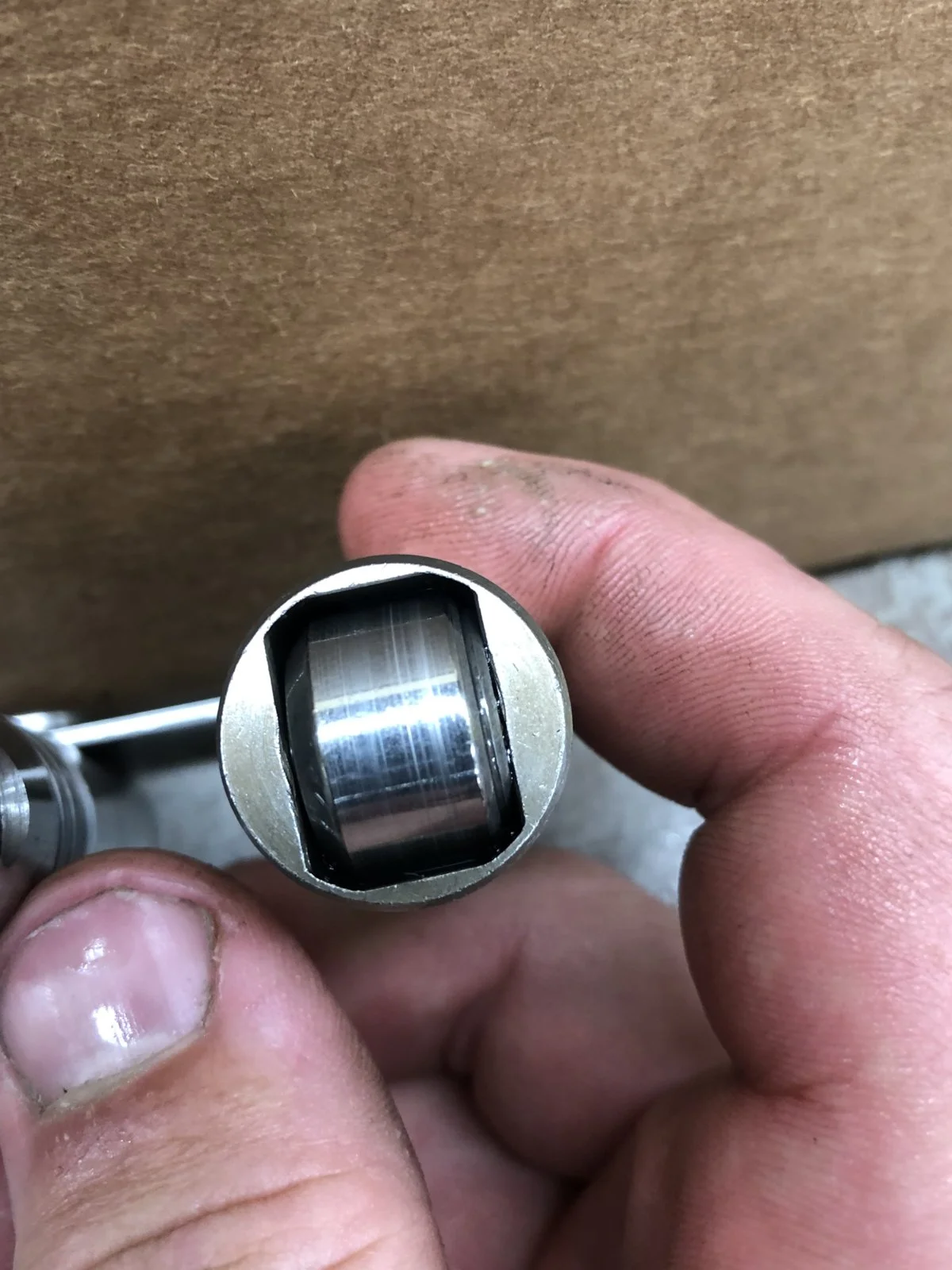

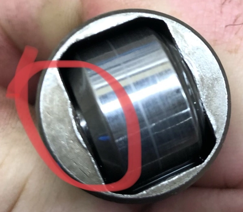

So I pulled the lifters today and found 3 with damage I can’t understand how it got there, one of the lifters with damage is the one I had trouble getting to pump up. Don’t see anything on the cam. I already have a new pair of lifter on the way because I believe the noise is coming from #4E. Is this superficial damage or should I replace the other 2 pair???

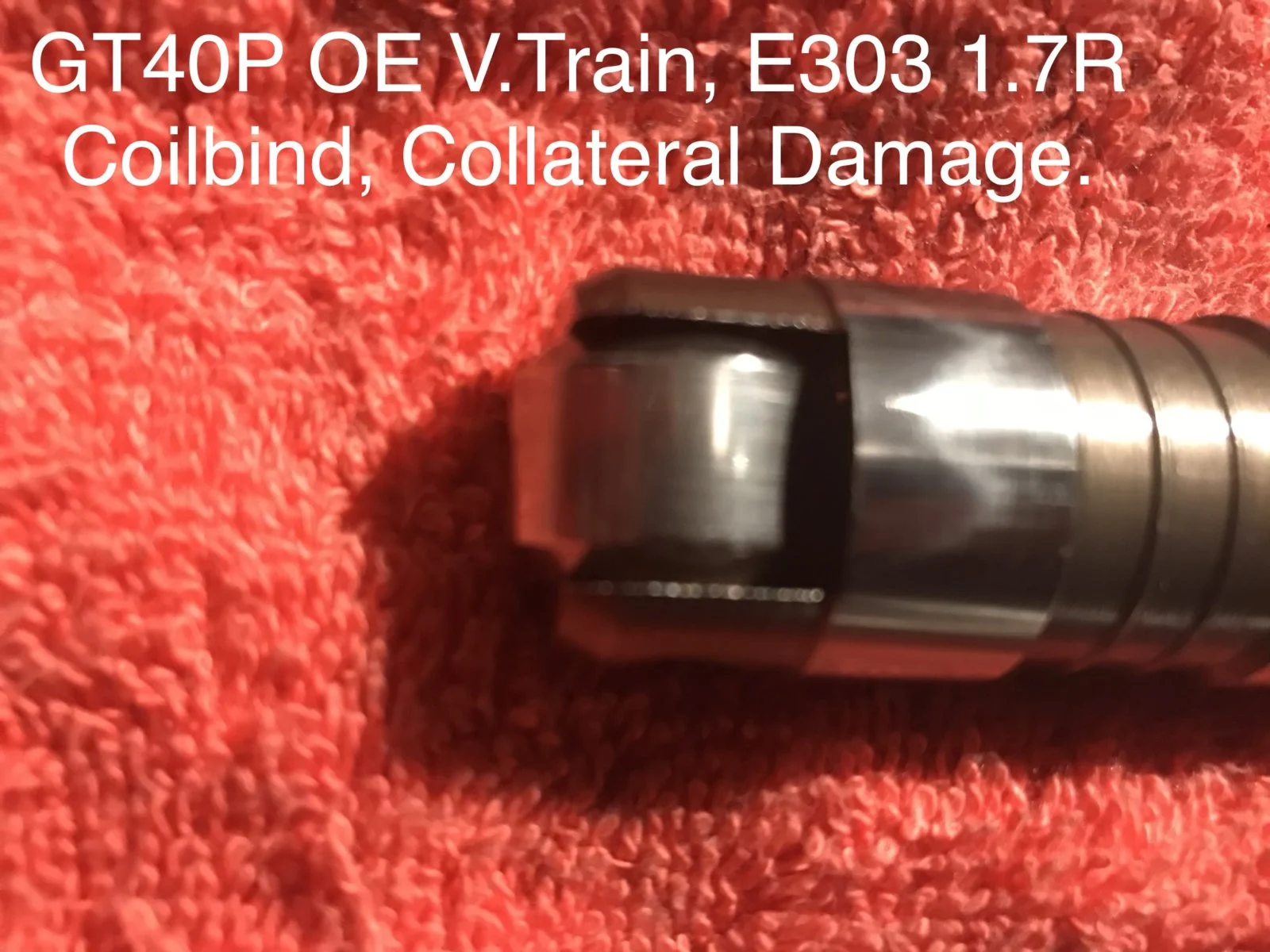

Hi, Thanks for the details, I now understand what you’re running. Valve-train Vid. posted, sounded almost solid flat Tappet..You’re correct, problem will “Find you”.
Think Lifter selection plays a large role, here. Marking on Lifter pic’s posted outweighed by other anomalies viewed. Quite possibly occurred as result of being “lazy” to pump-up.
Take the opportunity to see how well your Pushrods seat in the Lifter Cup, and Rocker. Also look for Pushrod/Block contact proof marking, as well as any other gross misalignment within each I & E Valve, binding points. Verify Springs are correct, look at Geometry; wear on Valve Stems.
EXTREMELY surprised to hear LUNATI directed you to run Sea foam.... They should be re-imbursing you for that #2 Lifter, if not all requiring replacing like your 1st Pic..
Are you running a Thrust Assembly (Cam button) to prevent Cam “walk”, whether Bronze, a Roller Bearing Thrust stackup?
ABSOLUTELY...replace any Lifters that are problematic, are questionable, have excessive lateral Roller endplay, burrs & chipping (Zoom in on Pic #1, Roller slot burrs, chips). Show these to the MFG.
Cam lobes look good? Your Oil Pressure numbers are good. Run a Mechanical Oil Pressure gauge, most reliable.

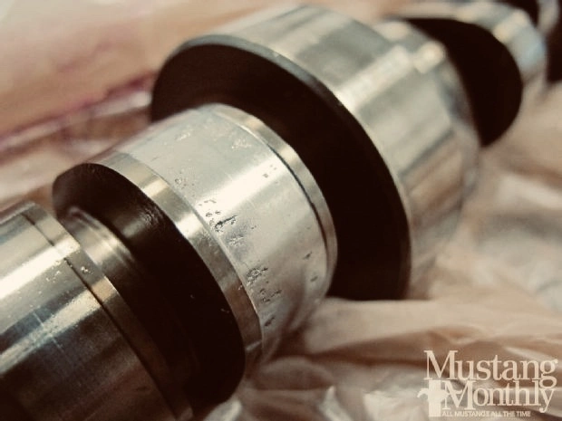

-I imagine you’re either running a non-Roller Block, or roller but decided to use Morel’s due to high RPM/Valve spring pressures.(?)
What is seated Spring pressure(s), Open pressure@ Full Valve Lift?
-You will experience slightly more noise due to the Lifters being run, preload a full turn or more sometimes applies, engine off- hot. You don’t want a Valve hanging open, yet carefully exceeding service limits work to stifle things, double verifying afterwards a Valve isn’t hanging
-You will experience slightly more noise due to the Lifters being run, preload a full turn or more sometimes applies, engine off- hot. You don’t want a Valve hanging open, yet carefully exceeding service limits work to stifle things, double verifying afterwards a Valve isn’t hanging via Compression test..

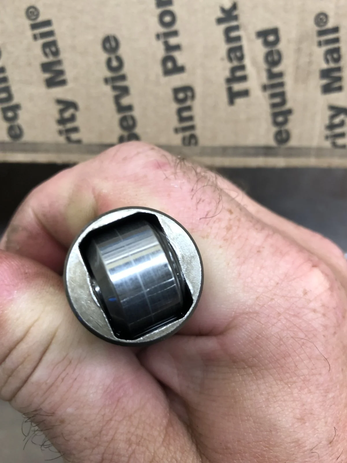

Very detailed response thank you, I showed the damaged lifters to lunati and got back “We saw the pictures. We have no idea either. I’m speculating but if the wheel was getting pushed sideways hard enoughand/or if there was hammering going, on the loads can do some amazing things.”
After having all the lifters our for a couple days and cleaning them with brake clean that #4E valve is collapsed again (the only one) I’ve checked the oil pressure with mechanical gauge and it shows the same. The sewing machine noise I’m getting could be from the poly lock kissing the rockers, I initially measured the push rod length and didn’t pay attention to the clearance. Pushrods are currently at 8.050 with a .43 sweep. Smallest I can get but obviously the clearance is an issue. Going to 7.9 gives me .050 sweep and it gets larger as I move down at the 7.9 length I have .011 clearance on the polylock. I’m thinking that’s the leaser of the 2 evils at this point. I will be replacing the lifter that won’t pump up and I’m 90% sure that is the sound I’ve been chasing

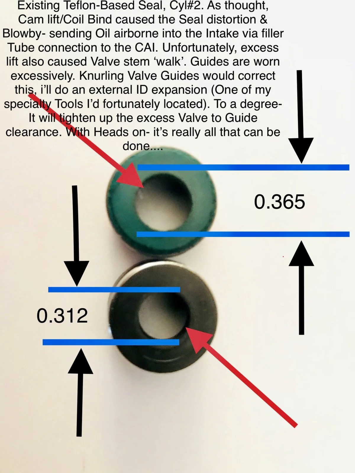

Below are the results reaped by running Explorer GT-40P Heads with stock Springs, (Coil-bind 0.450-0.470) adding a E-303 Cam (0.498 Lift) & 1.7 Ratio Rockers (0.527 Lift).
Guy complained it wouldn’t rev over 3K....

I fail to see any issues those pictures show on how the lifters are bad? Upon break-in this hazing on the roller is due to metal in the oil that was between the roller and the lobe. If things were not clean and even if they are upon start up iron from the cylinder walls, rings mixed with bearing material and piston material will contaminate the oil quickly. I really think it was a issue with a lifter/lifters not pumping up. I cant really follow what you mean on the polly lock clearance issue.

Check the video in post #1 of the lifter that keeps bleeding down. The pictures weren’t to show the wheels check the body damage around the wheels. I’ll include pictures of the polylocks and the top of the body where those male contact as well

Ahhhhhh. Ok well I would get a new set of lifters then, I really thought Morels were a good lifter. It's hard to say how hard your making contact with the rocker and adjuster since this is two hard metals. Not a ton of experience with this setup, I run shafts and more lift with my set up and would try to sway anyone who is over .550 to do the same. I would not sacrifice geometry just to eliminate the contact. If it were me I would consider releaving the rocker or adjuster to get your clearence.
That's my plan for tomorrow. going to try to make some clearance, seems to be the response I keep getting. thanks

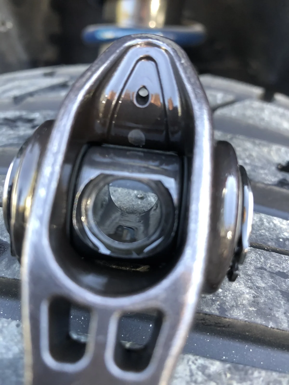

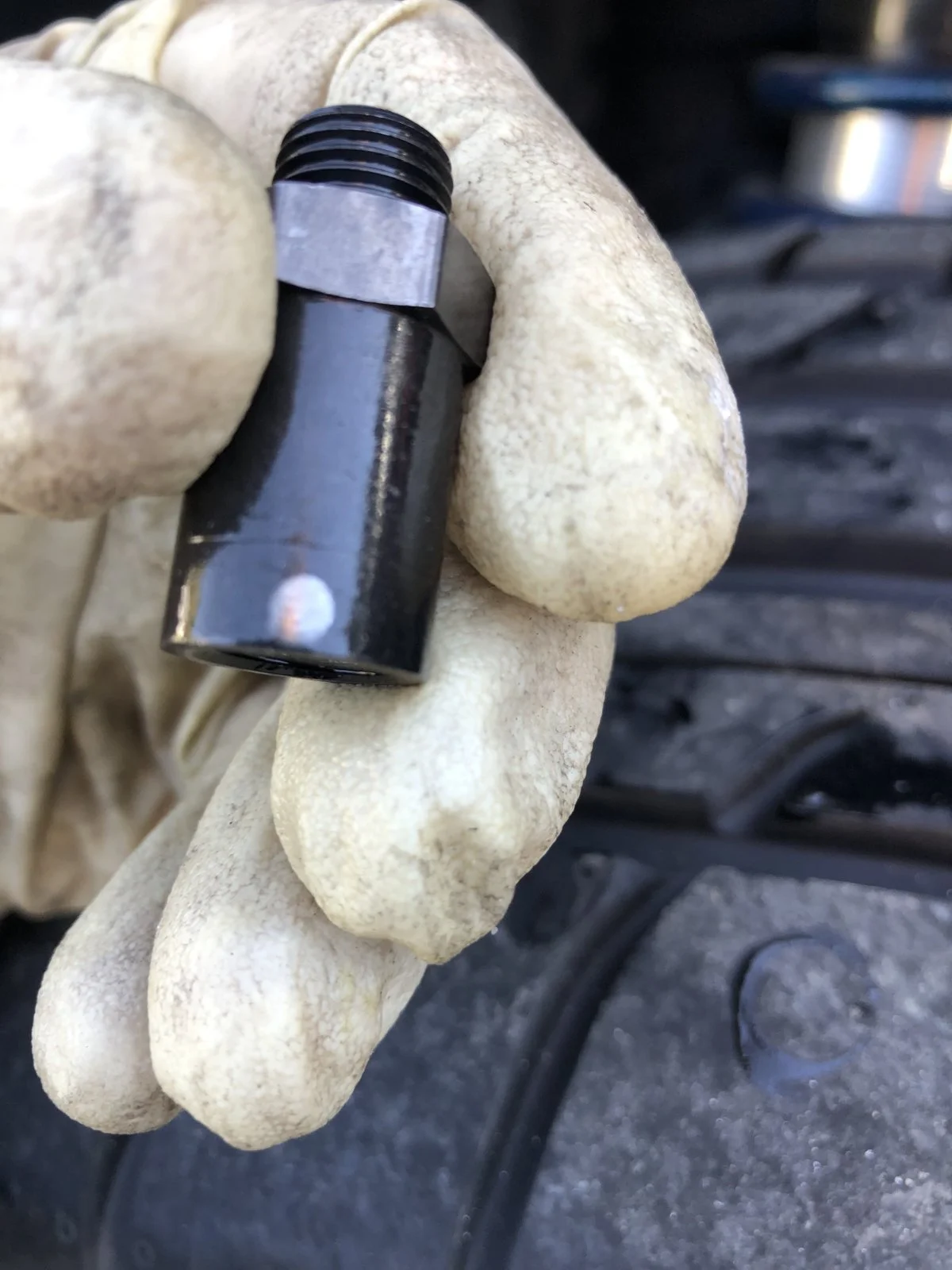

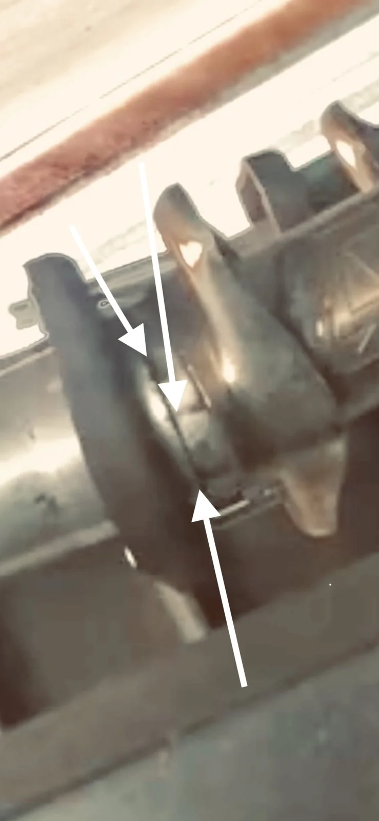

I look for 0.125-0.187” between the Rocker slots and the Locking adjusters. If it’s touching them now, imagine that at 6,000 RPM’s. Something WILL give.
There’s both 0.375 & 0.437” Stud kits, each having a smaller OD locking adjuster, or a larger OD locking adjuster. The tall style for Girdles 0.50 - 0.75 clamp Diameter offers both lower diameter(s). Haven’t run the Poly’s you have, always ARP’s.w/Set screws-as-is.
Some Mfg’s have narrow & wide Slot Rockers, that’s where the Small/large diameters really matter, but may gain you the clearance you require. Yours appear to be the larger diameter locks, part # supports that.
I wouldn’t turn them down on a Lathe, nor Mill the Rocker Slot. I’d run the smaller diameter Stud locks, that should gain you 1/8”, 0.062 per side. If you can gain that, and your clear- good. If not, I’d run different Rockers. Crane’s Gold series, or Comp’s Ultra Pro Magnum’s. The latter seems to make for a quieter valvetrain, it’s Steel Vs. Aluminum, high end bests that handle mega lift (0.800+) with resilience I’ve run are Crower’s ultra enduro’s, ultimate being Harland Sharps- $$
Considering Spring loads inherent with >0.600 lift, you may wish to consider Stud Girdles. Not absolutely essential, yet with your Build it seems to be a good idea, making changes towards longevity now will pay for itself later.
Good luck!!
-John
