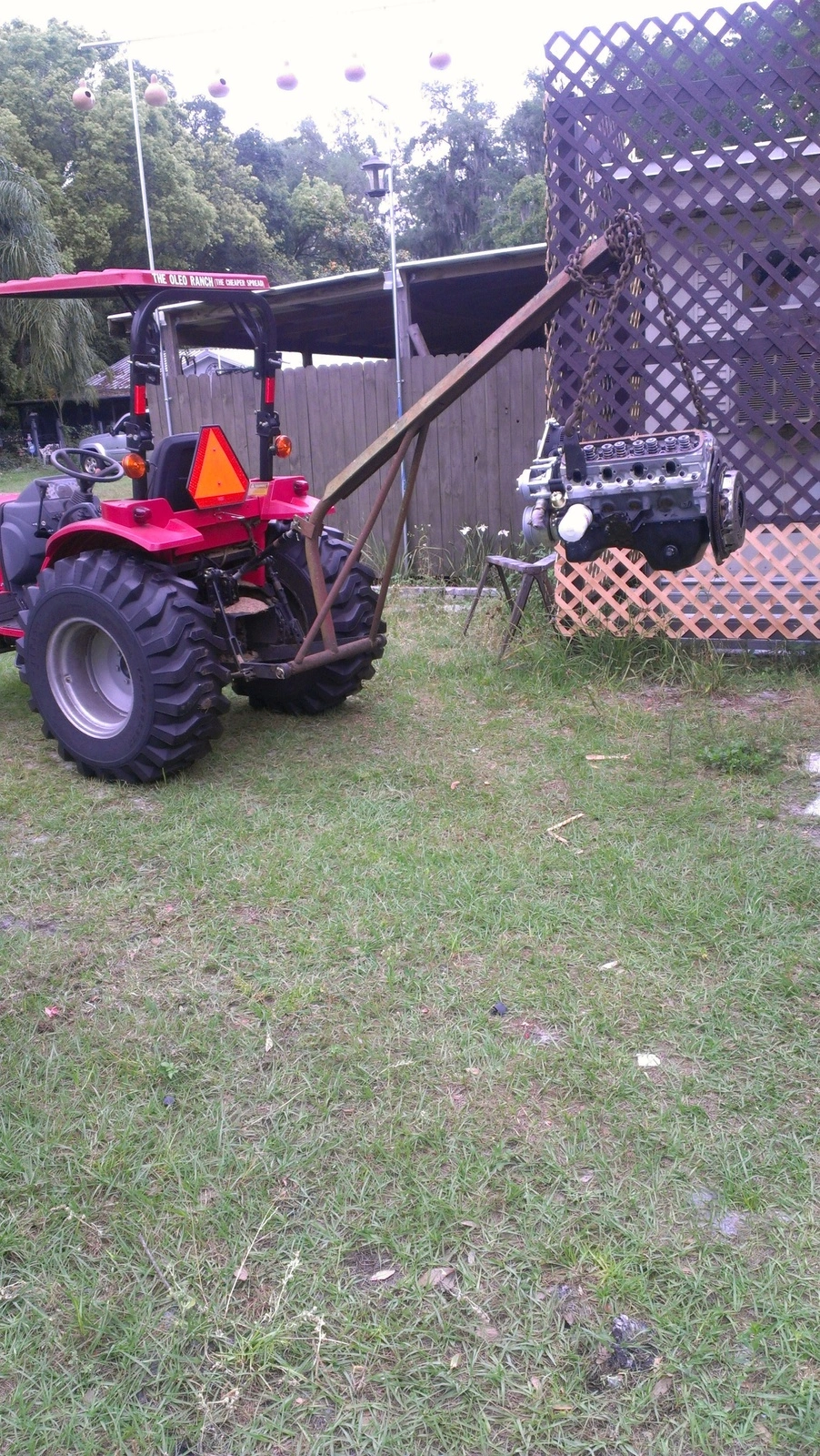

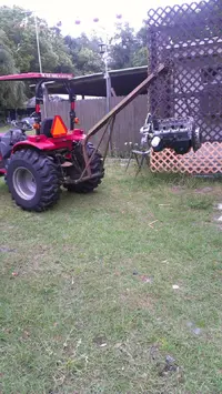

ok shes pulled. this is how we do it in plant city.

Didn't wanna pull the head in the car I take it?
Well, at least it isn't a chain over a tree branch. Lol. Anways, glad you finally decided to pull it. I was just waiting to see what was going on with it. My .02 is that you have several major issues here and you might as well just rebuild it again.

lol. not the first time i did it with the tractor. not concrete makes you work outside the box. yeah im gonna just pull the pistons too and see whats really going on. better safe than sorry.

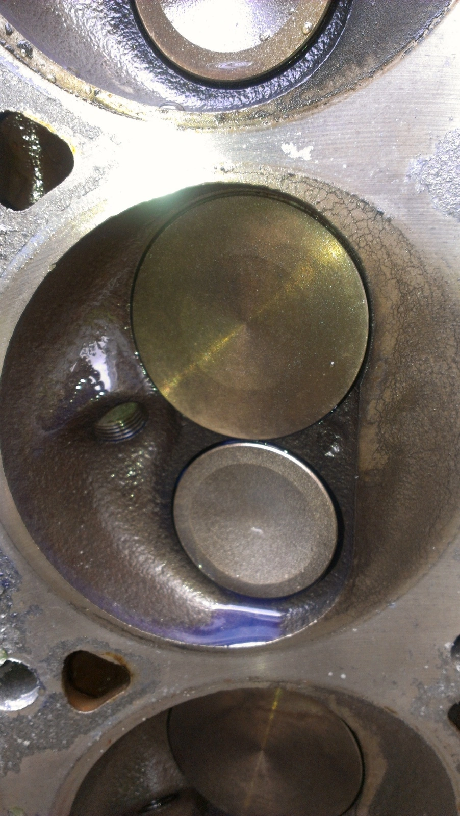

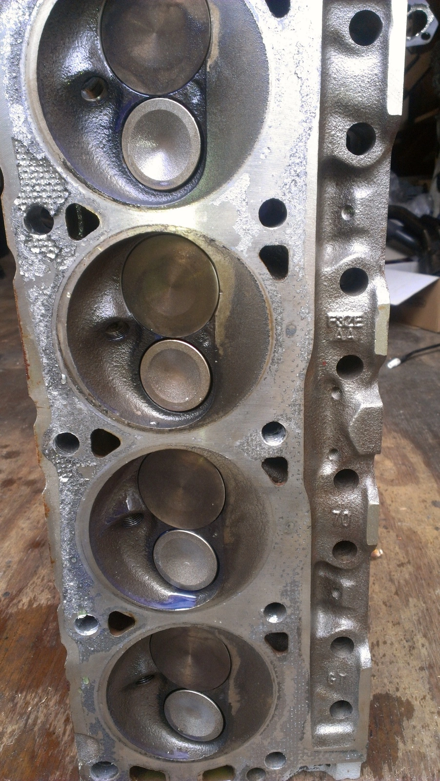

nothing looks damaged. least not to me.

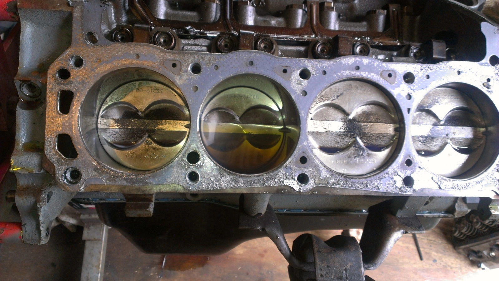

looking closely i dont think i got the crosshatching steep enough. looks more like 22* than 45*....... idk what difference that makes.

pull the valve out of the head and ck it ck the seat as well . a slightly bent valve may bind in the guide . a poorly cut valve seat can also cause issues

Pulled a random piston and the rings look stuck. they dont spin, nor did they spread apart.

Thats a good sign, although I would've hoped theyd've done that during final assembly....
