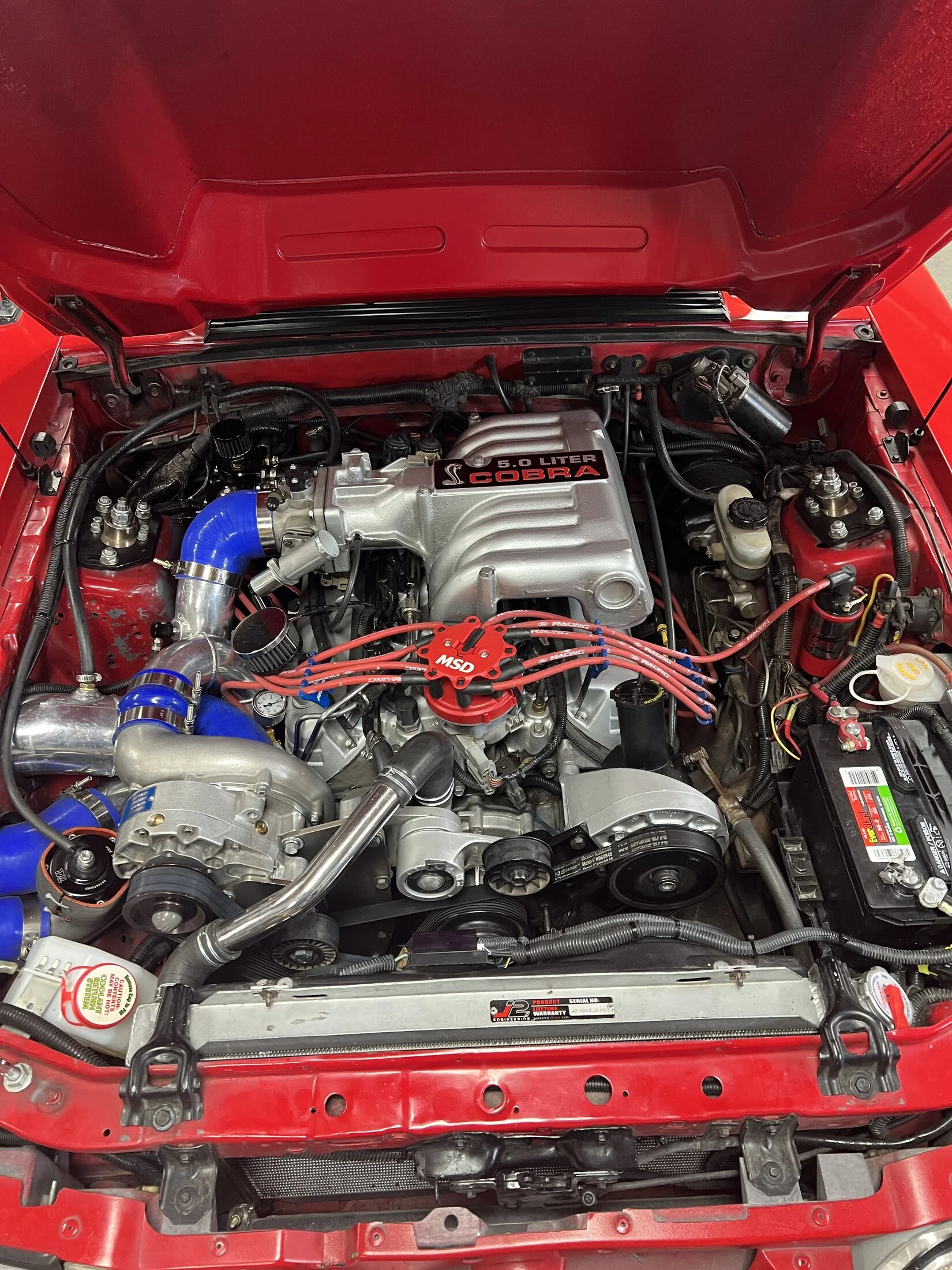

I'm going to be retiring in about a year and I need a project so I don't drive my wife nuts. I currently have an '89 hatch with a 306 with an older build, Y303 Ford heads, B cam Cobra intake and a Vortech V3 running on Megasquirt. Car runs strong, probably making around 400hp to the tires. Suspension and TKX transmission are all up to handling a little more power.
So what I'm thinking about is getting a 347 long block I can put on a stand and tinker with after I retire. I'd like to make 5-600hp to the tires. I'd like to keep the Cobra intake because I like how it looks and maybe just have it ported and the 347 will let me re-use the Vortech and all the accessories will bolt right back up.
The car is mostly street driven, but I enjoy going to the local track and doing some test and tunes and flash light Fridays and maybe a little index racing at some point. Also, doing a drag and drive is on my bucket list before I get to old lol.
So I'm looking for advice, opinions on hopefully an assembled long block. Hopefully stay in the $10K or less range. Don't know if my goals would be in Dart block territory. I was looking at the Blueprint 347 with their new 4 bolt main block. But curious what would need to be done to it to run it on boost. Ring gap, compression, cam ect.
Advice, comments, opinions appreciated.

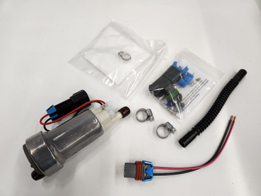

And stock fuel rails are not going to cut it nor is that 255 lph pump.
80 lb/hr x 8 = 640 lb/hr and 1 lb/hr = 0.703 lph so 640 lb/hr x 0.703 = 450 lph
Going to need a much larger pump. I would get the Pro-M fuel pump hanger (I have one and it was worth the $$) and run a Walbro F90000285 or the like.
