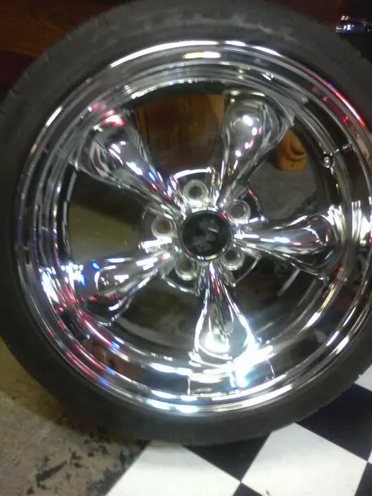

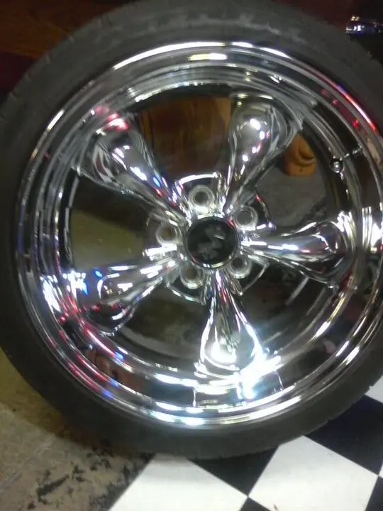

cellphone pic sry

I'm not sure how the Deep Dish 9" versions match up to the non deep dish ones. I have the non deep dish out front with 94/95 spindles, rotors and calipers.
Kabukinotch has the 9" DD out back and 9" regulars out front. He might know the BS and offset of the two.
I had to buy my wheels from two different vendors since AM didnt offer the non-deepdish 9's, I got the REAR 18x9's from AM and the fronts from Volpaz which is out now out of business.
I am running 94 spindles up front here are the wheel specs for all 4 corners which is why the rear sit in some.
18x9's
5.95 backspacing
24MM offset
