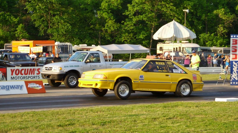

They are only used for one thing. For someone who is almost getting the front tires off the ground during launch at the track but just can't manage to do it. They bolt on some chains or straps and ta-da... now they can brag that they got an inch of light under the tires. Look at the pic below, the car is almost lifting the front tires, but the front suspension is fully extended keeping the fronts on the ground. If this guy would put some straps or chains on that limit how much the suspension can extend, the tires would be off the ground. It's just a gimmick IMHO. Don't bother with them.
That makes sense...so if i attached them i would look super cool at maple grove speedway (my local drag strip) hahaha. Seems like more of a hassle than it's worth. Does anyone know of any drive ability issues with this setup?

Its a cheap version of a front end limiter. Not allowing the cars front suspension to fully extend on launch...limiting rise. Used in drag racing to keep the front end "down" for cars that wheelie to hard. Not a gimmick, they don't make you pull the front wheels off the ground.
Ditch the chains and put the end links back on for the swaybar.
