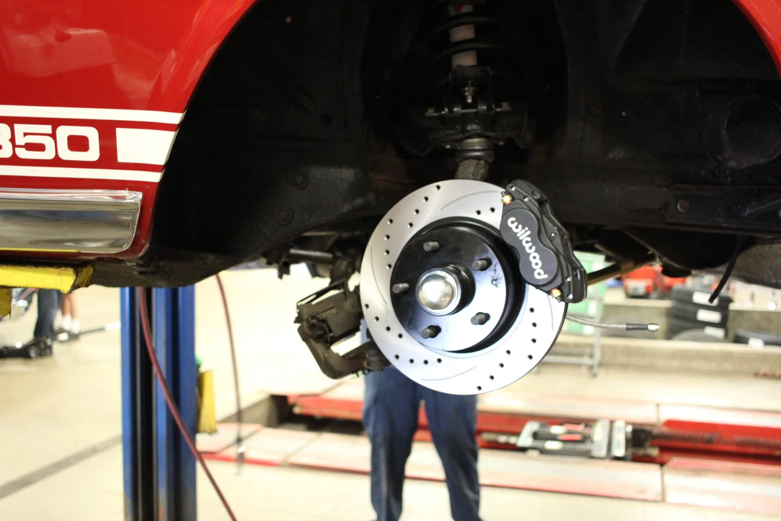

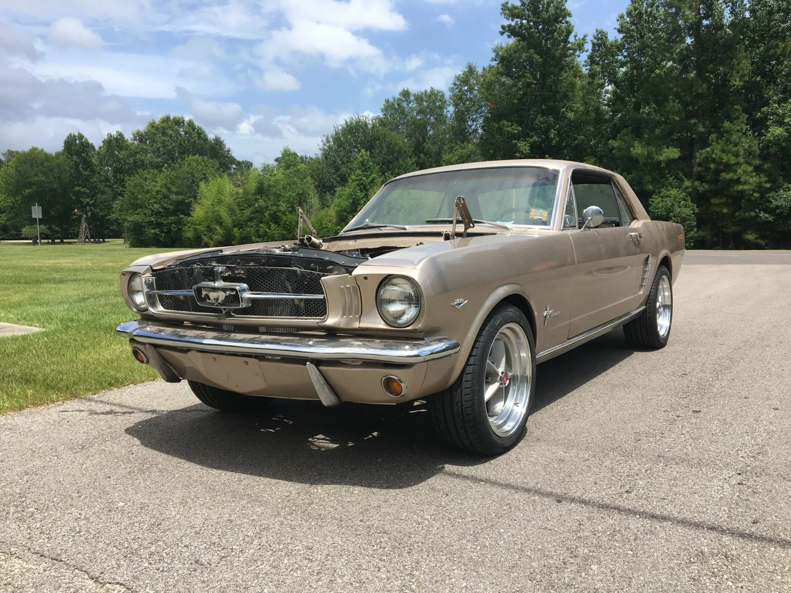

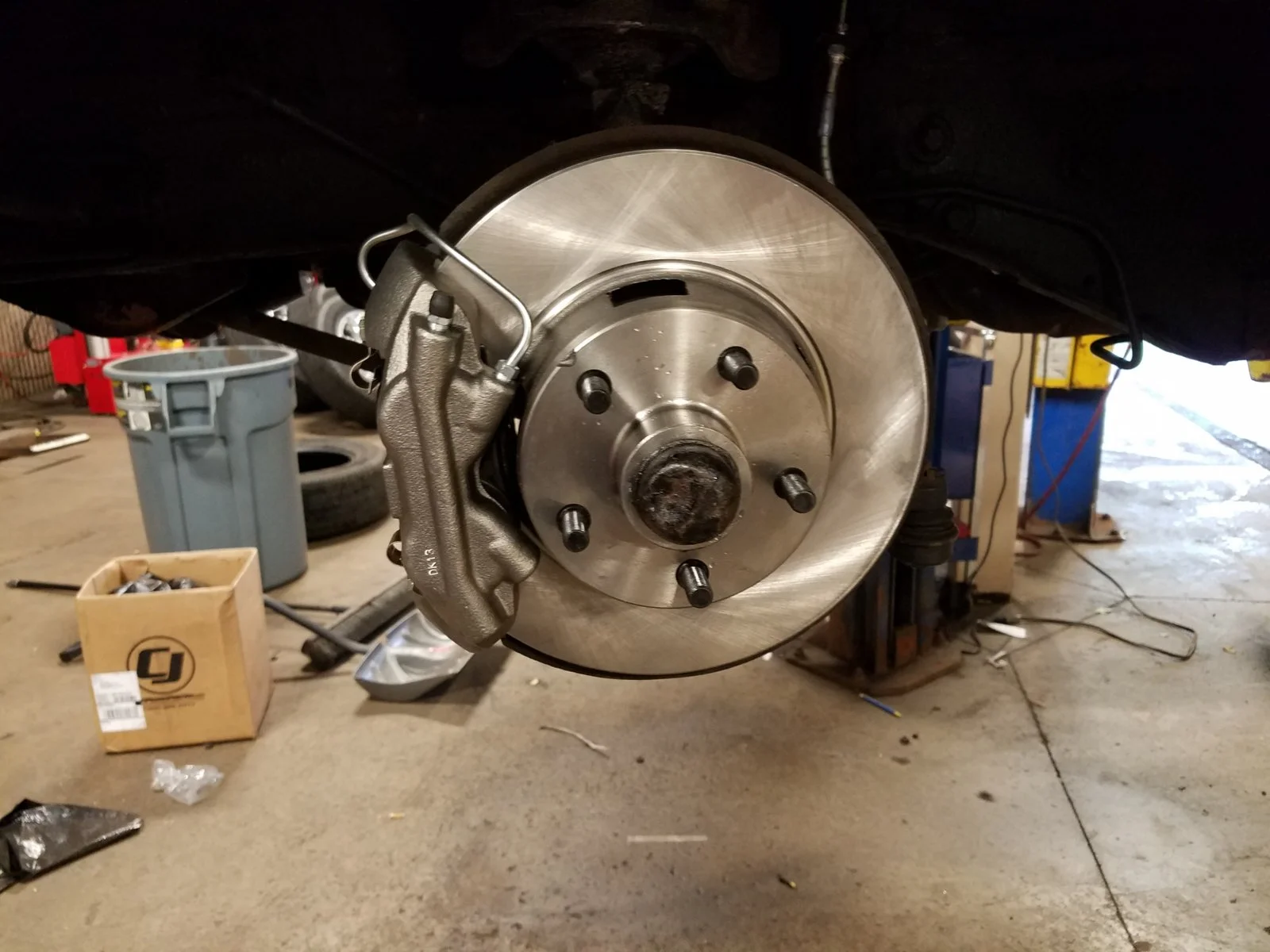

Wilwood has a classic fit 4 piston setup. I put these on the front of my 68 Shelby GT 350. Figured if Shelby American is replacing the stock Ford discs with Wilwood, that is good enough for me. And price wise those were similarly priced to the KH knockoffs. Huge improvement over the original Kelsey Hayes single piston on the car. And they look great. The bolts on the spindle are sized to replace a drum brake set up. Had to drill out and tap my stock disc brake spindles. Apparently all these disc brake kits are for drum brake up grades. That was the only issue we ran into. The Wilwoods fit very nicely in 15" Shelby ten spoke rims. Actually a bit smaller than the KH I took off. If I recall Wilwood said those classic fits discs will fit a 14" rim. Bought the Wilwoods through CJ Pony. I attached 2 pictures. The first image is one of the KH knockoffs the shop was putting on a 66 Mustang next to mine. Forget which repro. The second pic is my car with my Wilwoods. Both of us owners acquired the brakes and took them to this shop for installation. Shop owner had my car in and out long before he finished the other two classic Mustangs he had in his shop. And both were there before I brought my car to him. He told me neither of those other kits was a simple bolt on like my Wilwoods were. He has to customize the installation. The other two Mustangs had two different KH reproductions

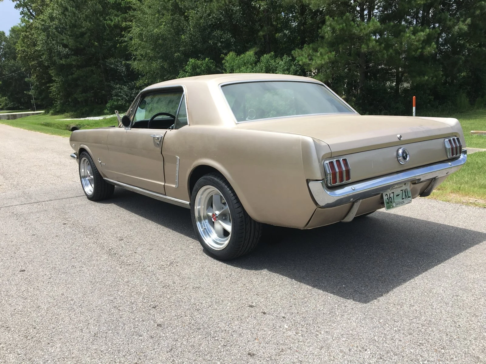

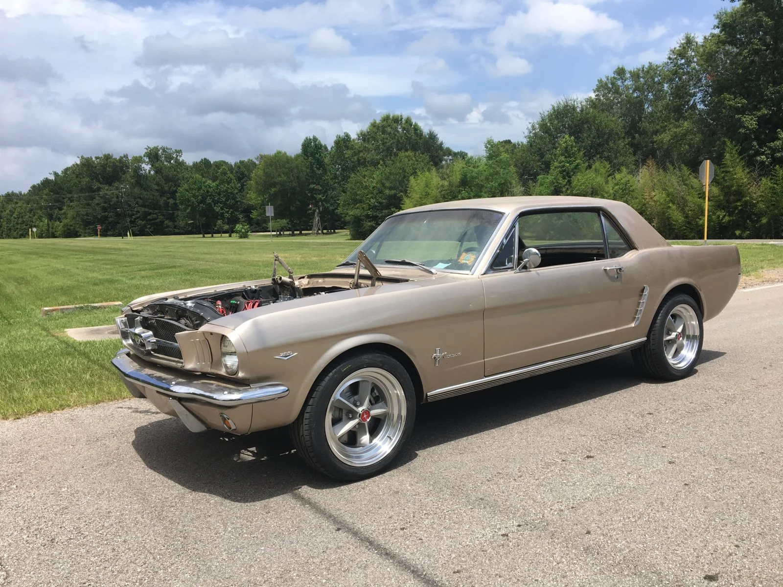

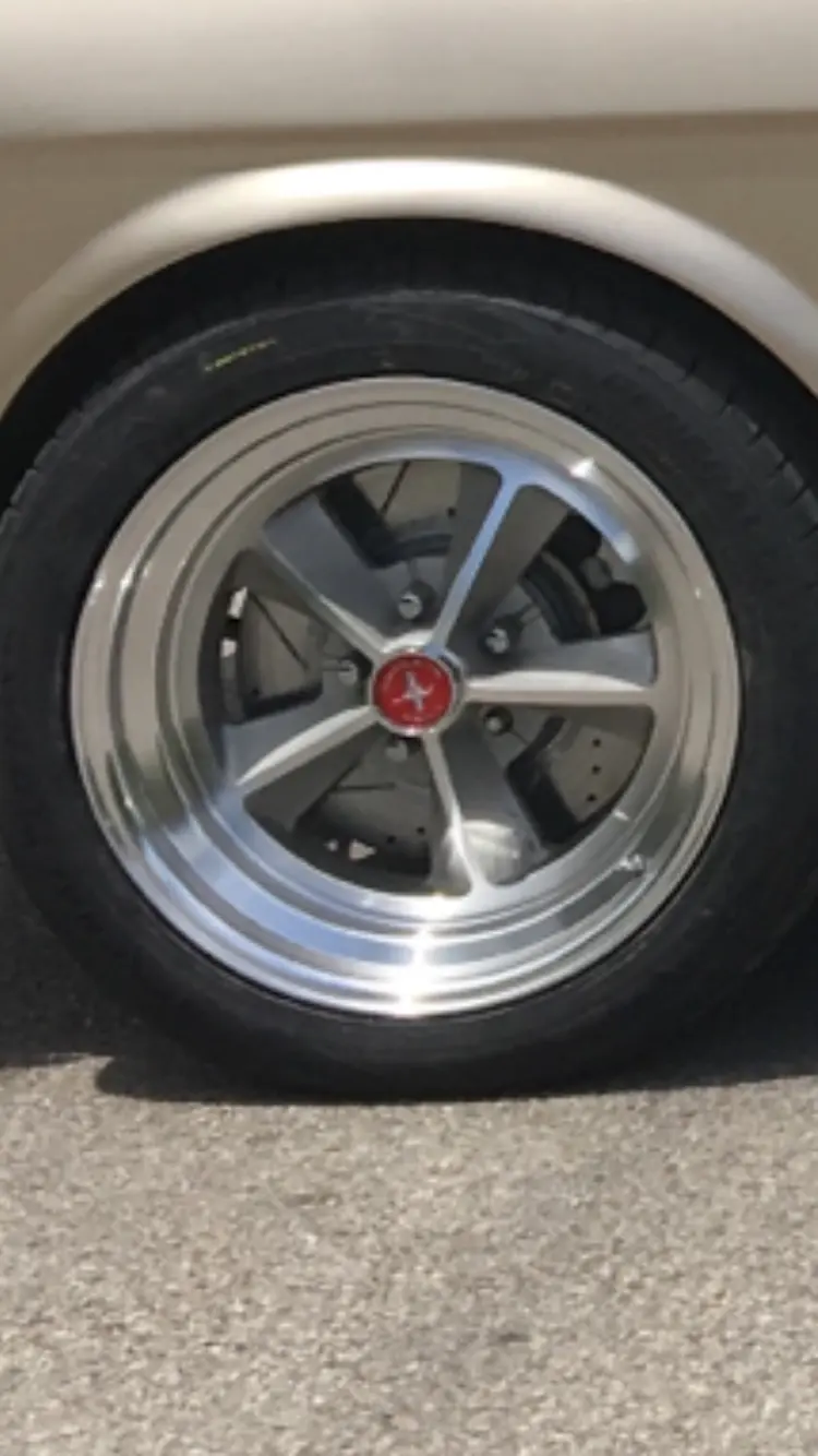

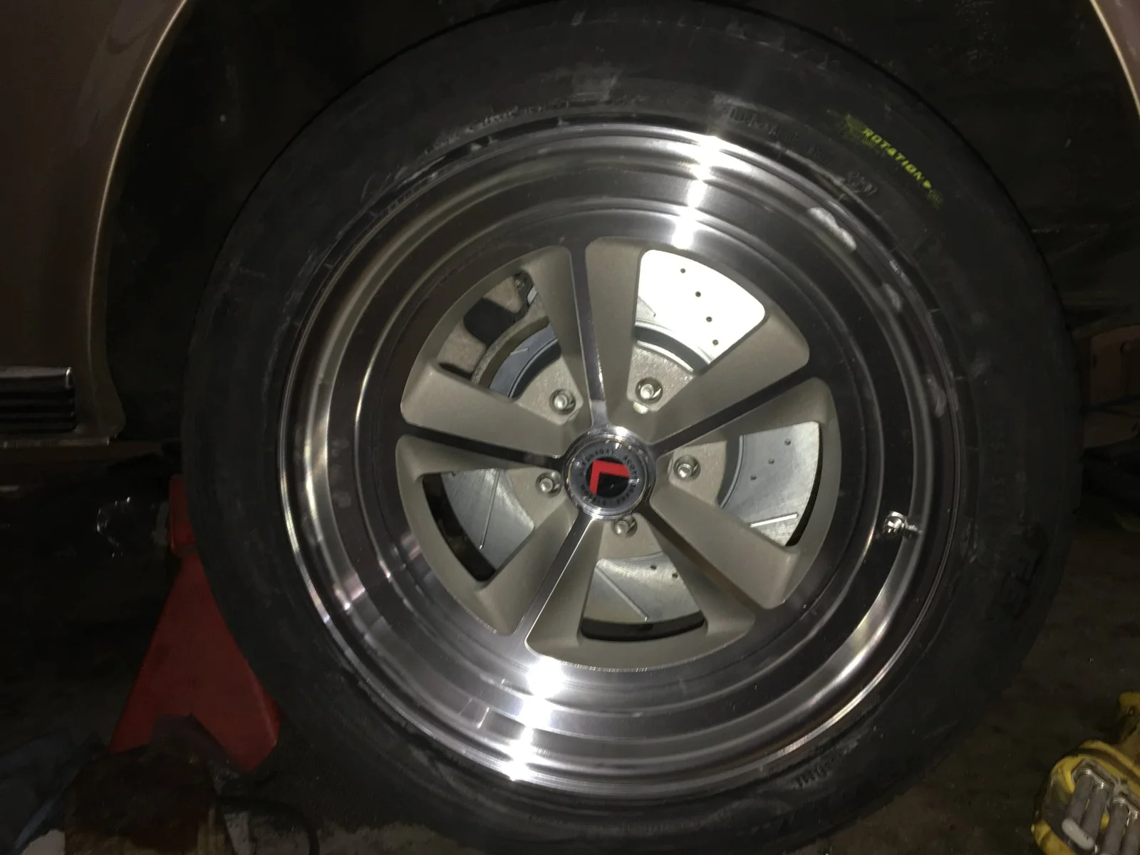

Dittos on the mustang Steve 08 GT conversion brackets. These things are 100% first quality. Just did them front and back on 65 289 car. Must upgrade to 17" or larger wheels and also MUST watch back spacing and clearance for caliper. Legendary wheels area pita to fit
Reactions: 2Blue2
Thats a good looking rim.
Thanks! They are Scott drake legendary wheels. 17x8. 4.75 bs. Look great in car but don't leave much room behind the spokes for disc calipers. I did the mustang Steve 08 GT at every corner. Had to run .25" spacers all around and had to grind calipers a bit at each corner. Now they fit and look "right" on the car but was a bunch of work. I think torque thrusts would have fit out of the box so to speak

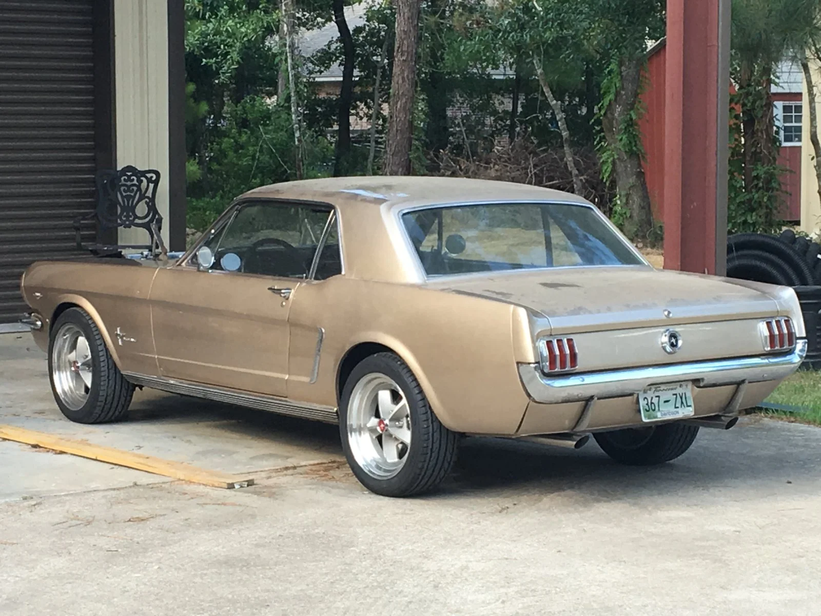

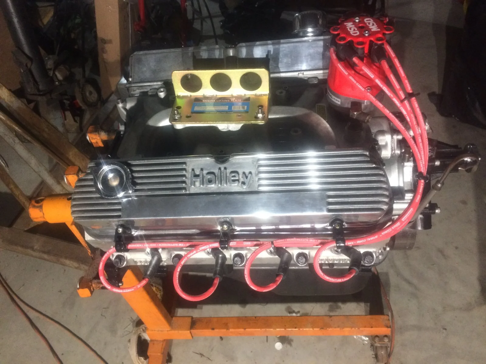

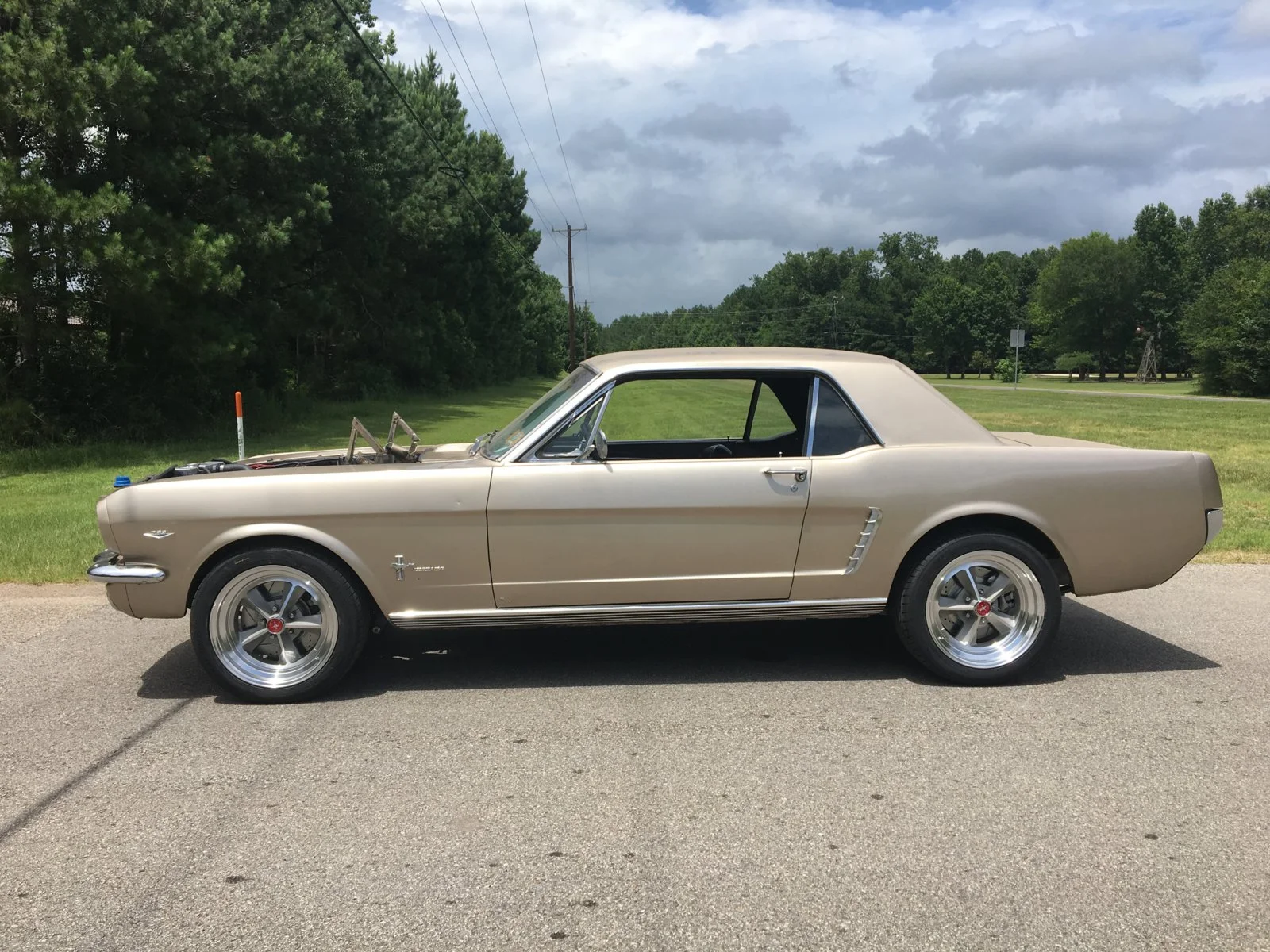

I just built it from front to back for a buddy of mine. Took just over a year in my spare time. Turned out pretty sweet. Body and interior was real good when I started. All mechanical is brand new. Learned more about old mustangs than I ever thought I would know! Lol
