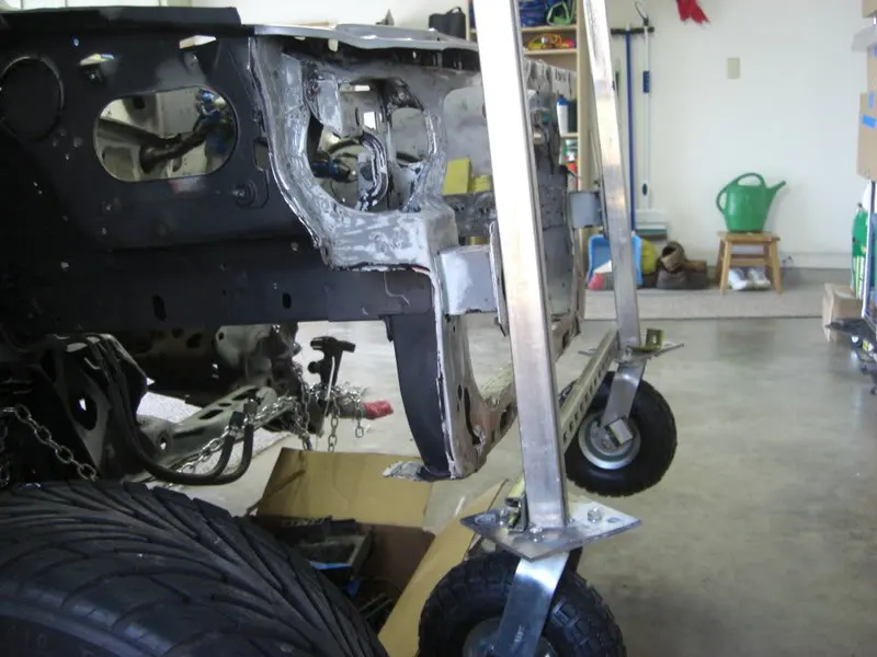

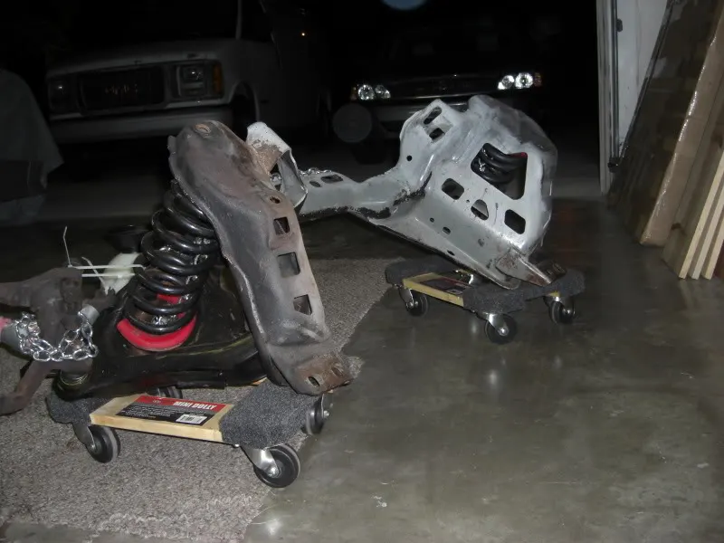

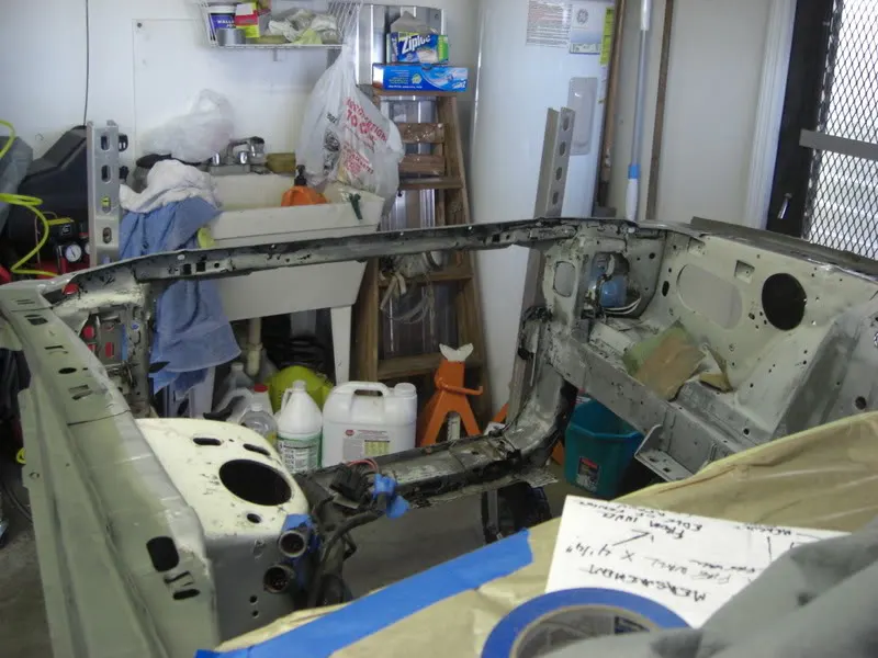

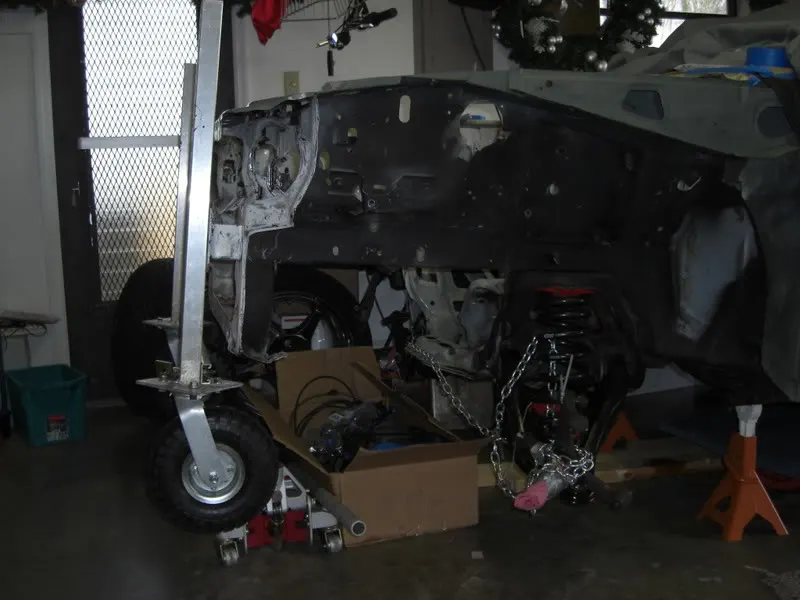

I started he project and I am at the point of dropping the K member.

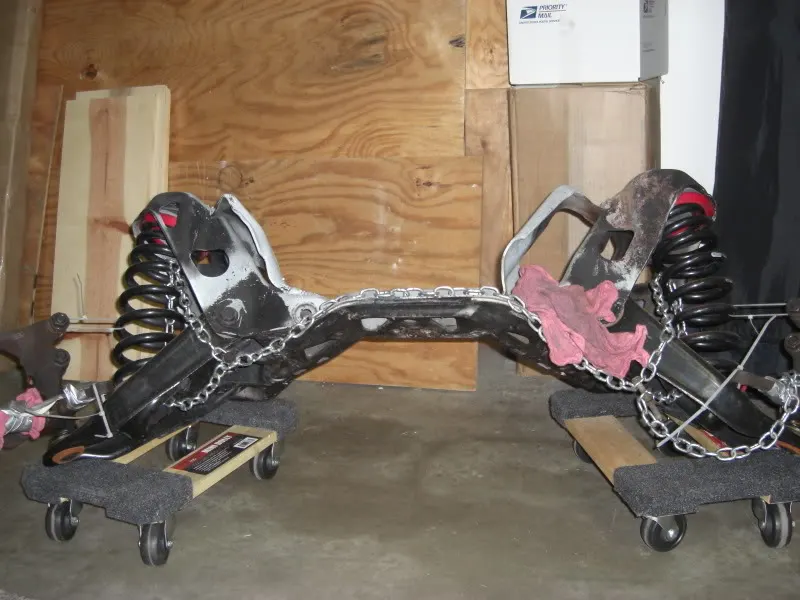

Made a Dolly and attached to the bumper receiver
I dropped the control arms down to relieve the spring tension, but I didn't see the reason to pop them all the way out because I am removing the K member to get under the frame to derust prep and paint.

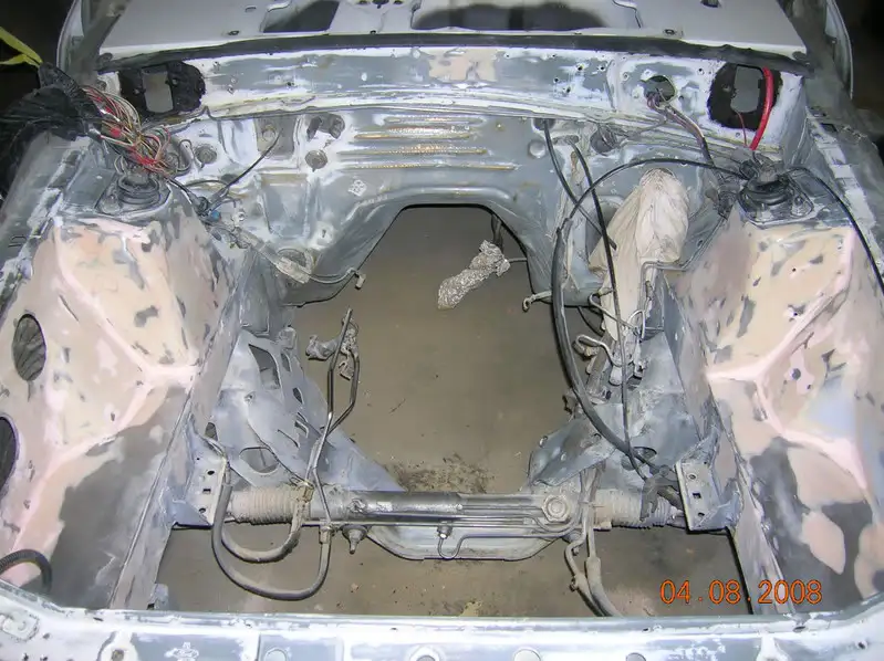

I Knew these questions were going to be asked about filling the holes and Hiding the wires. My question is what holes do you fill in and what hole don't you fill in? You need some of the holes for mounting things? As for hiding the wires how do you route them? are there length issues. Where do you mount the coil and starter solenoid?I don't know how to weld. I was thinking of buying a welder from Harbor Freight but I dont't know which one to get. If I got one I would practice on another piece of sheet metal.As for the plan---Remove the doors. derust detail paint the engine bay. I want to hide the wires but I have to figure out howand where to route them. Would like to fill in holes. Has anyone used POR 15 Epoxy? any issues with it?Putting in a 347 about 420 HP 430 torque

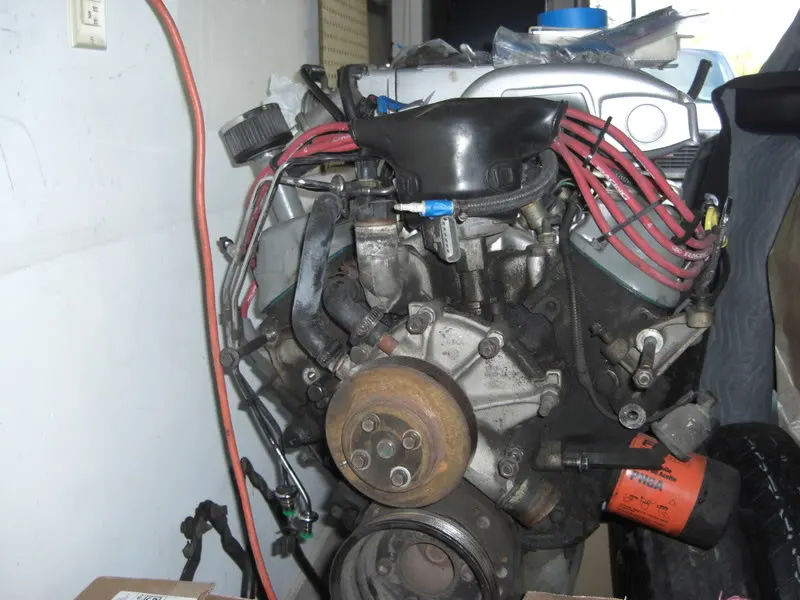

Here are a couple of pics before I tore the car apart

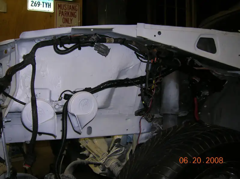

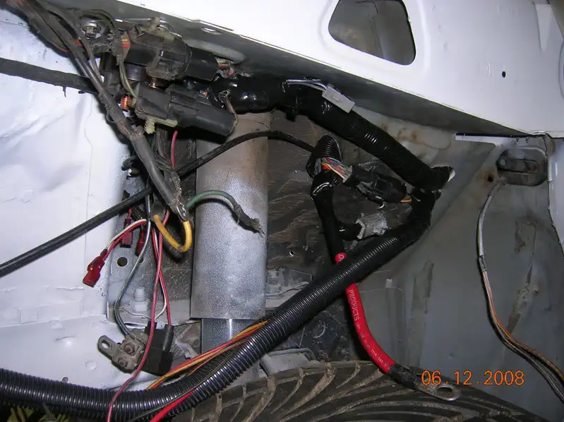

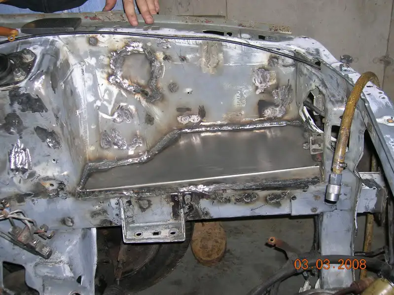

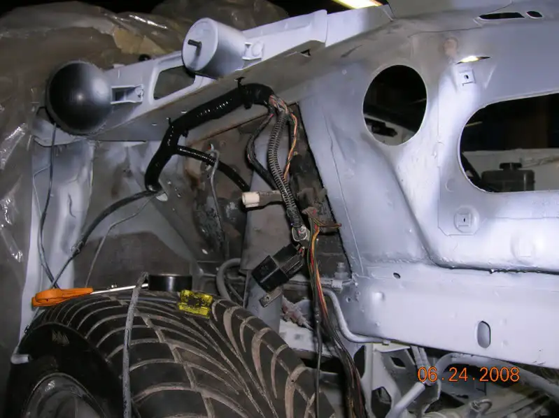

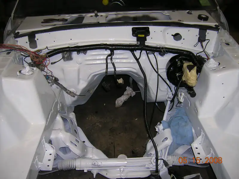

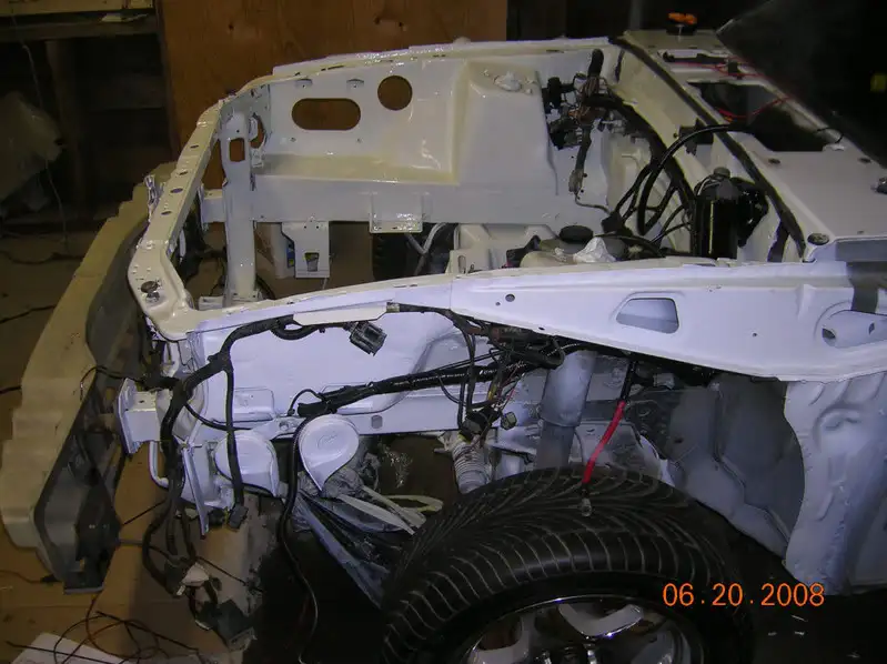

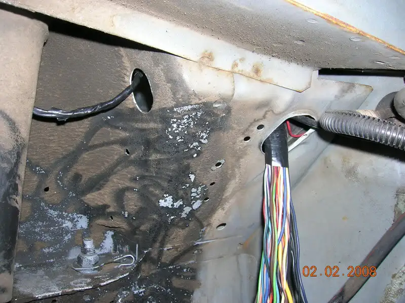

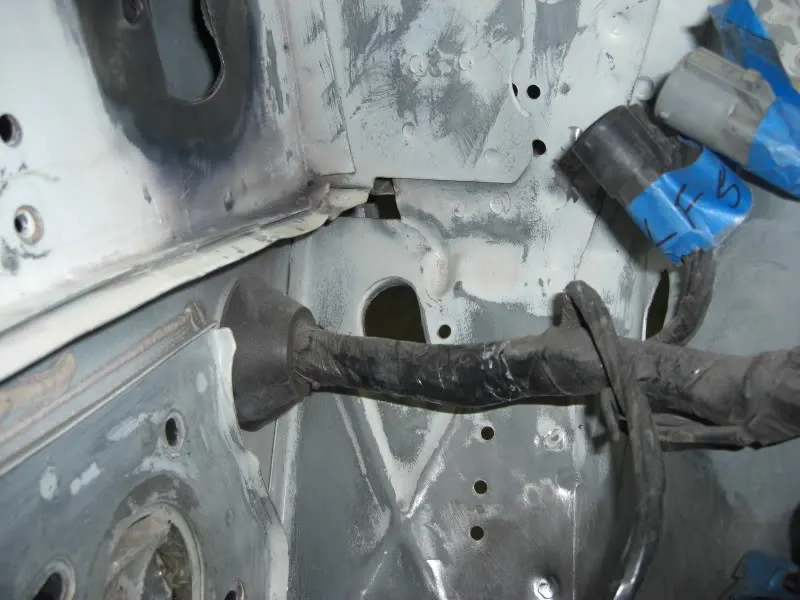

here are some shots of how i hid my wires and welded my bay.
ran the main harness inside the drivers fender, didnt lengthen or cut a single wire
welded the holes in the bay, if you can figure out what holes you need by thinking about what your going to use and where your going to mount it. i marked all the holes i knew i would need with a sharpie as i took the car apart. its really not that hard, foward of the strut towers you'll pretty much fill ever hole except for mounting holes for the coil, brake distribution block, and whatever kind of intake system your going to use.
bondo
paint
set up your wiring harness
its not that tough, when i started mine i knew nothing about welding, bodywork, or paint. i was helped by good friends with the welding and the paint but did everything else myself. if you look in my sig there is a full project thread of mine, take a look if you like and feel free to ask any questions you have. good luck and have fun im sure whatever you do will come out great.

if you had a tublar k member and arms i'd swear that was my bay! LOL. um if it were me i would fill all the holes and just redrill new ones for the mounting of stuff. winter of 09 i'm gonna redo all mine again. got a few little more special touches i wanna do peace
bondo
paint
Where did you mount the relay and how did you run the wires on the drivers side? They go through the firewall and then what? Did you have to undo the wires from the black shield tubing and then route the wires to get the wires to be more flexible?
On the passenger side where did you mount the vacuum switches that were on the strut tower?
I removed the engine harness and pulled it through the firewall from inside the passenger side. That harness is easier to deal with.

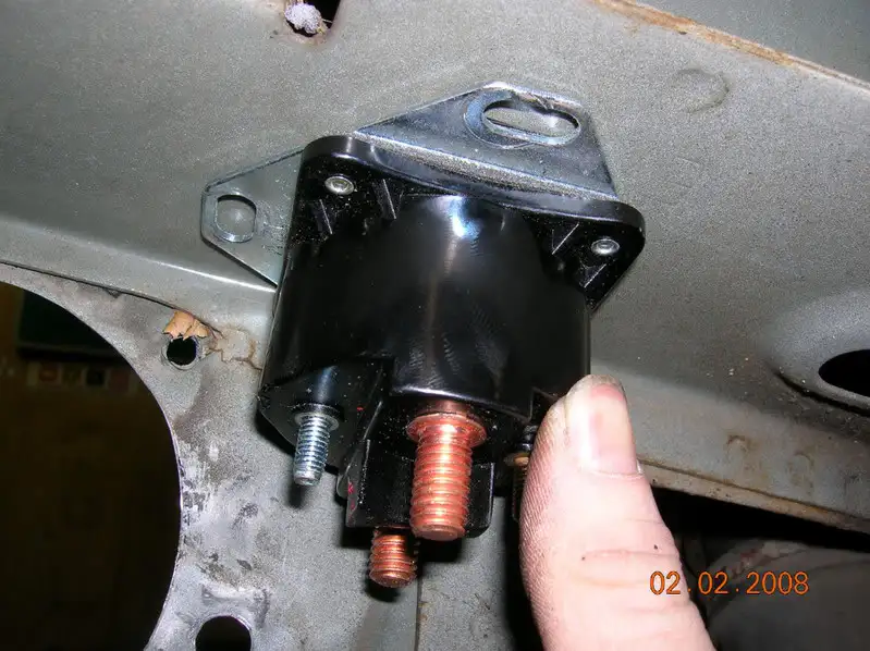

i mounted mine right up in this area.
if you are worried about changing solenoids all the time you can get a mini starter that has a solenoid on its body, then all you do is put every wire to one side of the original starter solenoid and use it as a distribution block or junction box, whatever you prefer to call it. but even if the solenoid is shot it should still work because there is continuity between all the wires from the get go.
i took the loom apart on mine, but only because i wanted to redo it and retape it. i went through the holes in the inner fenders behind the strut towers. you will have to mess with it to get them all to fit and put them in in a certain order, bigger connectors first, smaller last. but i did mine without cutting any connectors off. i didnt splice anything on the main harness.

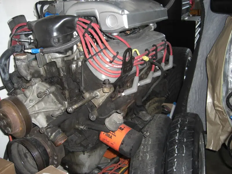

all that work and you are rocking a FRAM oil filter???

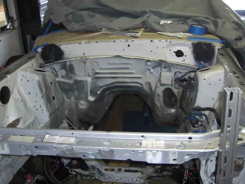

Don't know what happened to the previous pics so here they ara again
Sorry haven't replied been busy and went to Las Vegas on Vaca.
Engine bay is white because thats the original color of the car. Thats why I'm detailing the engine bay now.

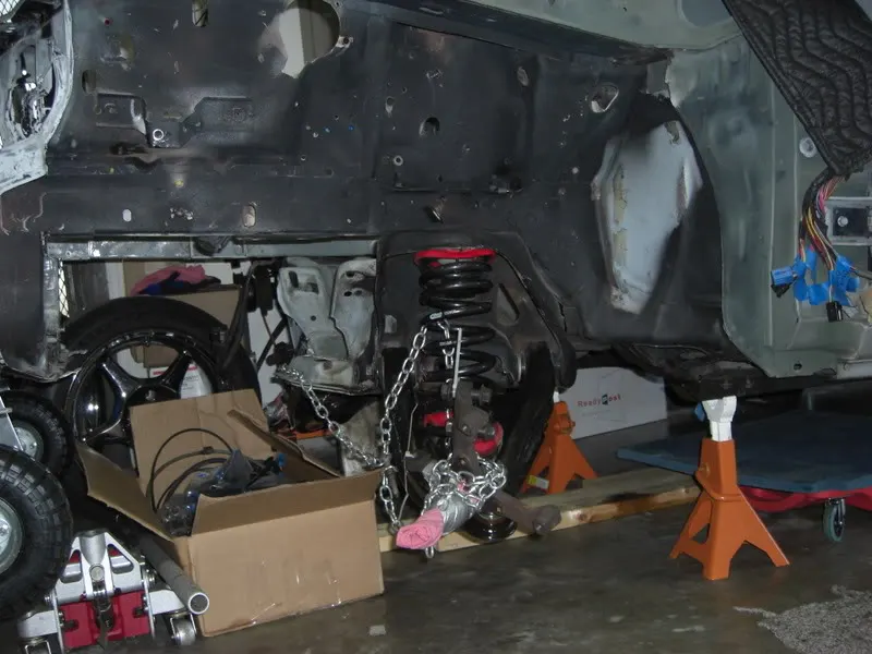

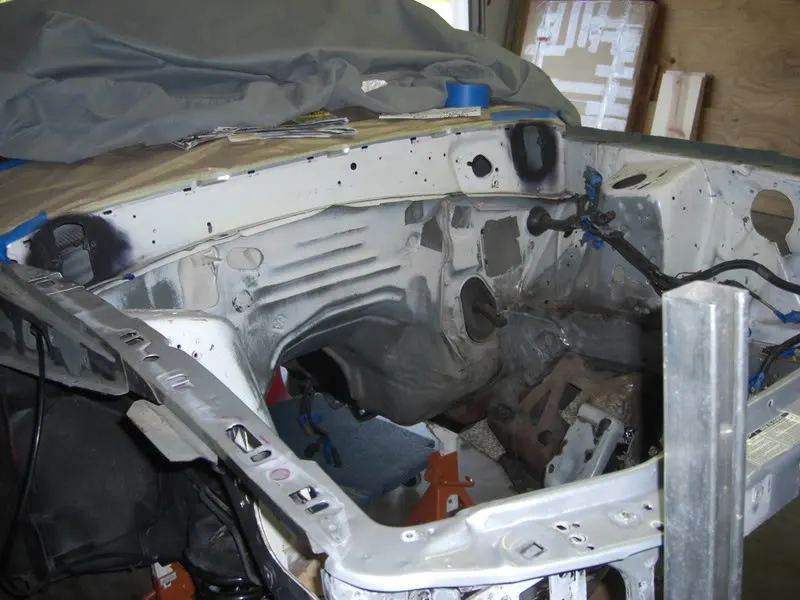

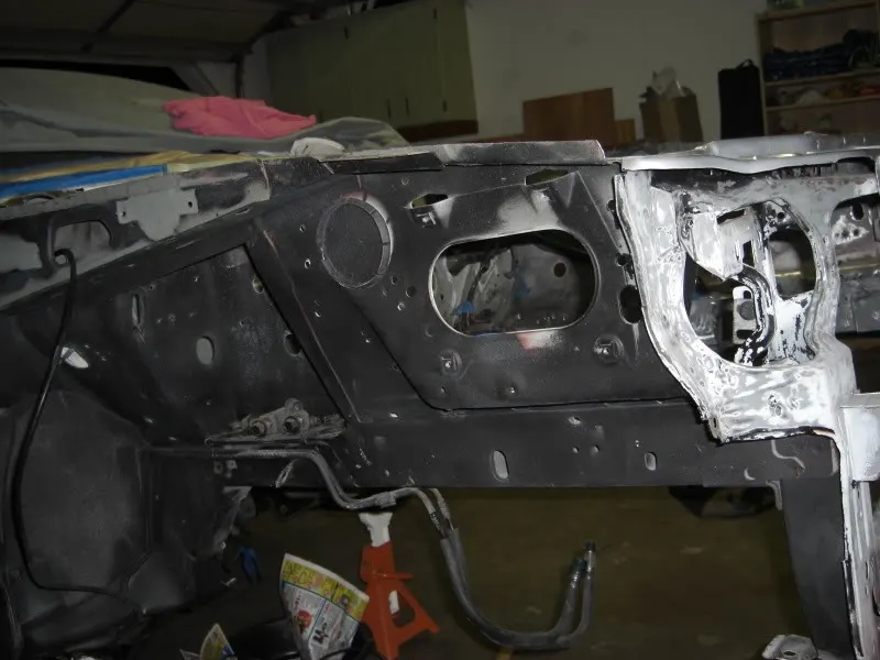

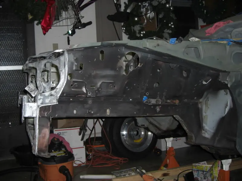

Here are some progress pics. Removed the K Member
Sanding the Bay

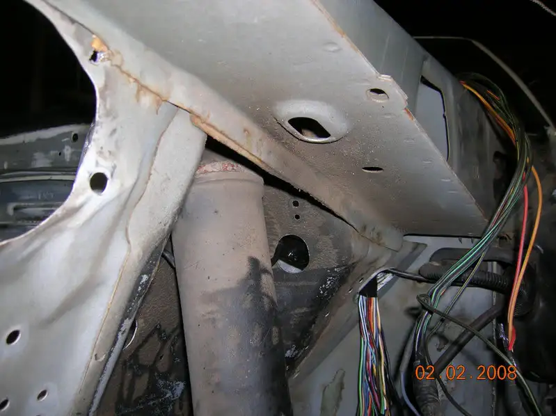

Would the wiring harness go through the inner fender hole or the strut tower hole?

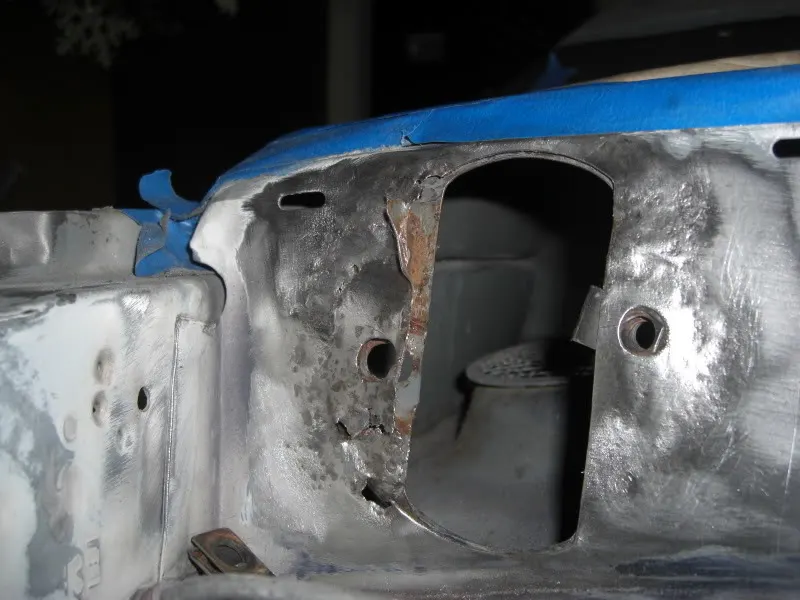

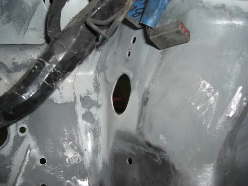

How would you repair this. It is on the passenger side hood hinge mount.
