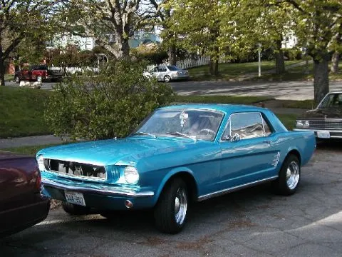

there she is :) I believe those are called moon wheels, correct me if Im wrong, I love her even though shes missin the grill and emblems and lots of stuff :)
