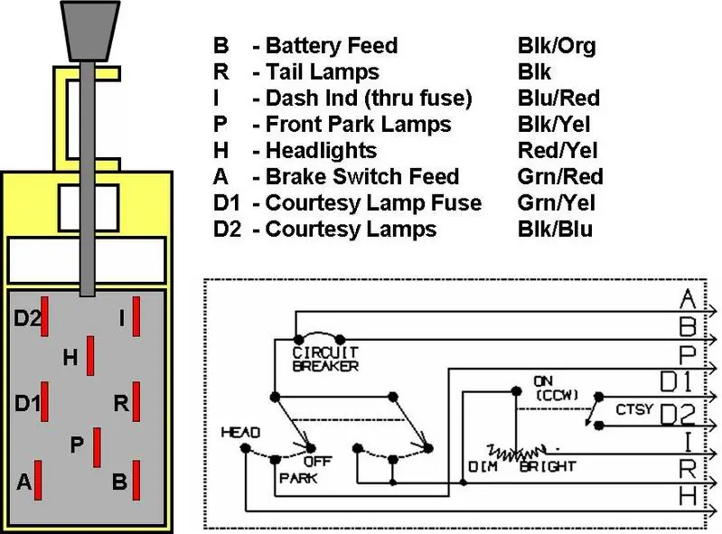

I would think the headlight switch also found this picture I saved awhile back, it is of a headlight switch for a 69-70, don't know if it would be the same as yours. But I think they are all pretty much the same.

Sorry it took so long to post this, I have been traveling. I was only able to take a quick look (at 12 midnight, LOL) before I am out of pocket again for a week, but I did find a couple of things out. I checked the back of the headlight plug by jumpering the appropriate terminals, and got nothing. I then checked the switch itself and it is opening and closing the circuit fine, based on the diagram Grabber70Mach posted (thank you)
So, I'm pretty sure it is in the harness?? When I get back I will check the toe switch. Note: I did pull the old voltage regulator out, as part of the EFI swap... In the wiring diagrams, there is an input from this to the headlights harness if I remember correctly. I just did not have time to dig into the schematics.
